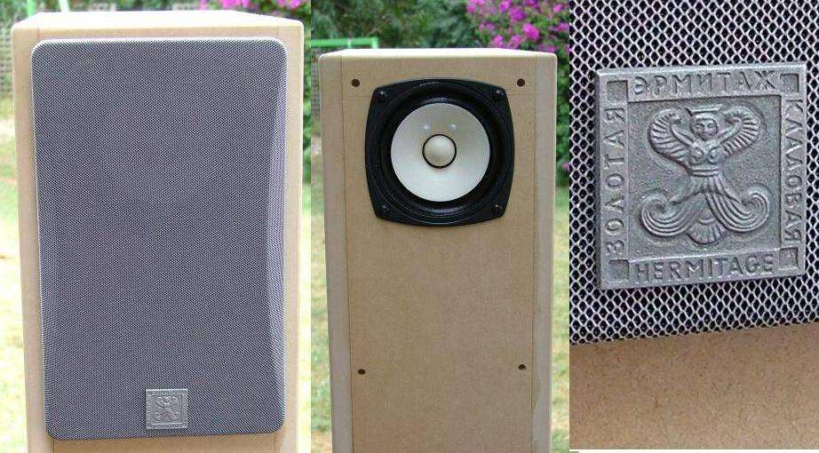

Looking good Fergs. I too have curious little fingers in the house so removable grills were a high priority on my bhorns.
After a few days of attempting to build some nice looking grills I found some Sony bookshelf grills stashed in a cupboard. The Sony badges were quickly replaced with some badges (buttons for US readers) that I found on a trip to Kyrgyzstan, to make some nice looking grills.
The only tricky part to mounting the grills is getting the holes in exactly the right spot (and the right depth) so that the grill stays in. They're spaced so that the grill has to be bent a tiny bit to put it on, which then holds them in tight. I strongly recomend making a hole template and testing it first.
I've now started looking out for grills from cheap bookshelf speakers, and found some nice grills on some very cheap and nasty speakers.

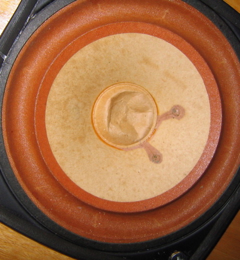

I've managed to recover squashed dust caps by placing an appropriately sized tube (cardboard tubes are ideal) over the cap and sucking (fairly gently) until it pops out.
I imagine you've already had some recent practise at inhaling sharply 🙂

greetings all, ooty I think I'll just try the phase plugs. As far as sharp inhaling goes to be honest I just had to laugh at the situation, she has a job to do and she did it well. by the way ooty I followed your lead and bought a ps1 and It sounds great. Have you tried any of the mods like bypassing the output section etc
