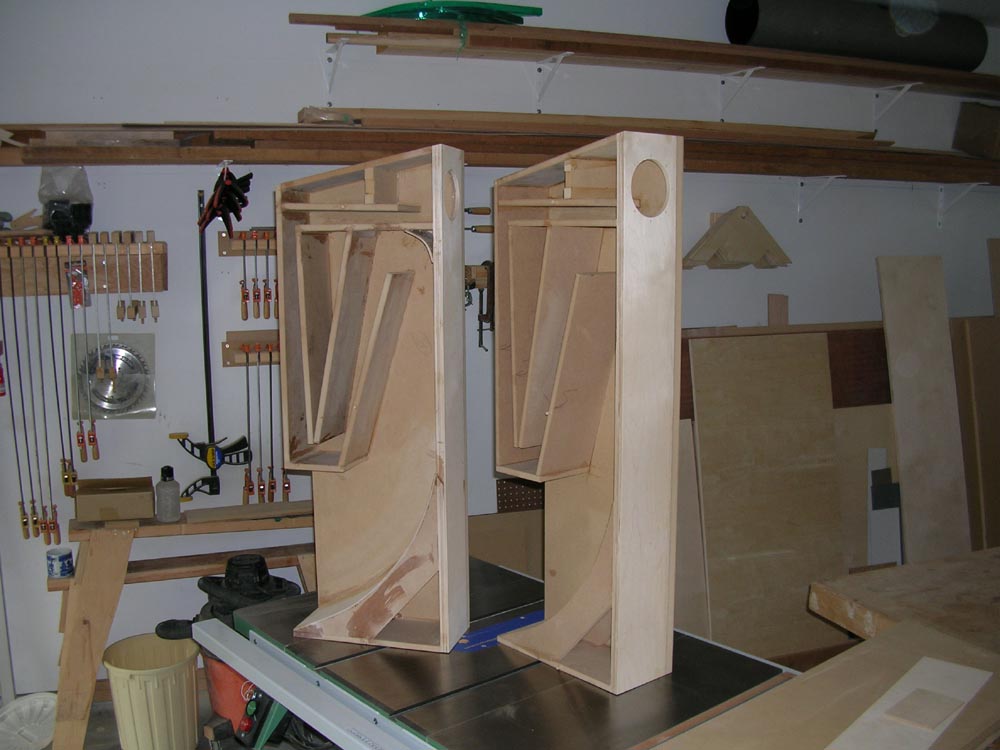

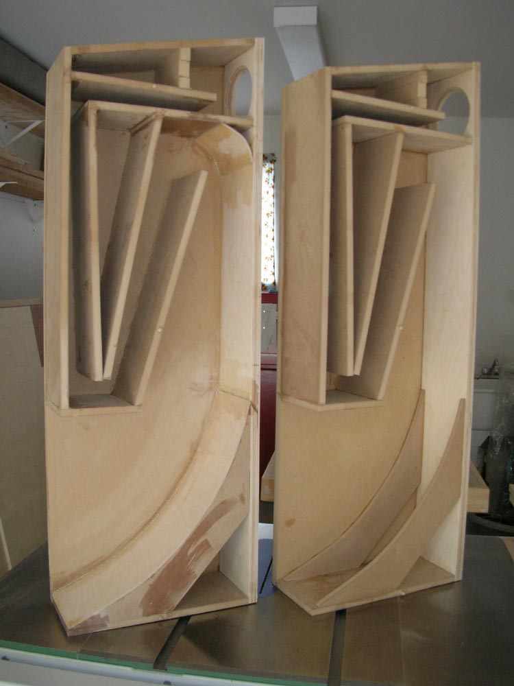

Finally got some time free from work and pushed forward on the speakers. 😀
Here are a couple of pics showing construction of the sloped top and the curved interior bit.
Most of it's MDF, but the front panel is birch so I could drill and tap for machine screws to hold the speaker on.
Aengus, excellent work!
You might want to consider Dremel'ing some cutouts between the taps in order to let the driver vent somewhat better. I found that an improvement.
This is an older picture, I don't use any sheep wool or other material in the CC any more. The FE108EZ wants acoustic impedance more than anything else IME.

Hi Oliver
Thanks for the note. I have relieved the inside with a 45-degree router bit, but it doesn't show clearly in the low-res photos. I started it at about 1/3 of the way in from the front, and it just covers the screw-holes on the inside, so that's probably about as much relief as I can give it.
I hadn't planned on stuffing the chamber, just putting thin (~2mm) self-adhesive felt on the walls. I'm hoping it will tame a certain brightness I'm hearing, but that of course may still be break-in as well.

Ah, sorry, I didn't see that. All is well as long as the driver can breathe properly. 🙂
If I were you I'd make sure it's removable. My horn Guru told me that any stuffing in the CC is disturbing the acoustic impedance, and the FE108 seems quite susceptible to that. So I ripped out everything, even the small felt patches around the driver. They immediately gained an improved hear-through quality by doing that. Now, mine seem properly run-in now, so the felt could make a positive difference during that period for you. You can tackle a lot of the brightness by positioning.

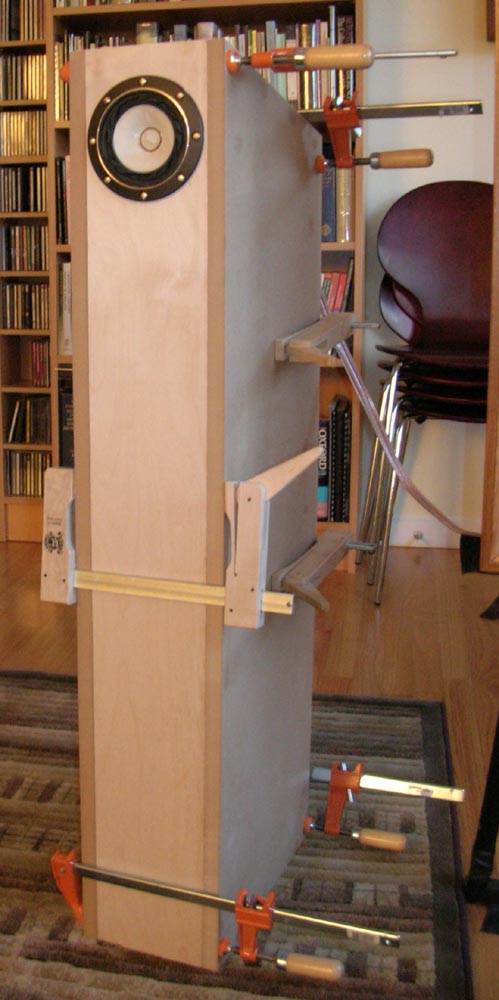

Here's a shot showing the "clamped mono" setup I'm currently listening to (hey, maybe I can start a trend).

Oliver, thanks for the advice. I have fastened down some sample bits of the felt and will test to see how easily it comes off after 48 hours or so.
On the snubber n/w, I may well try it once I think everything has stabilized.
