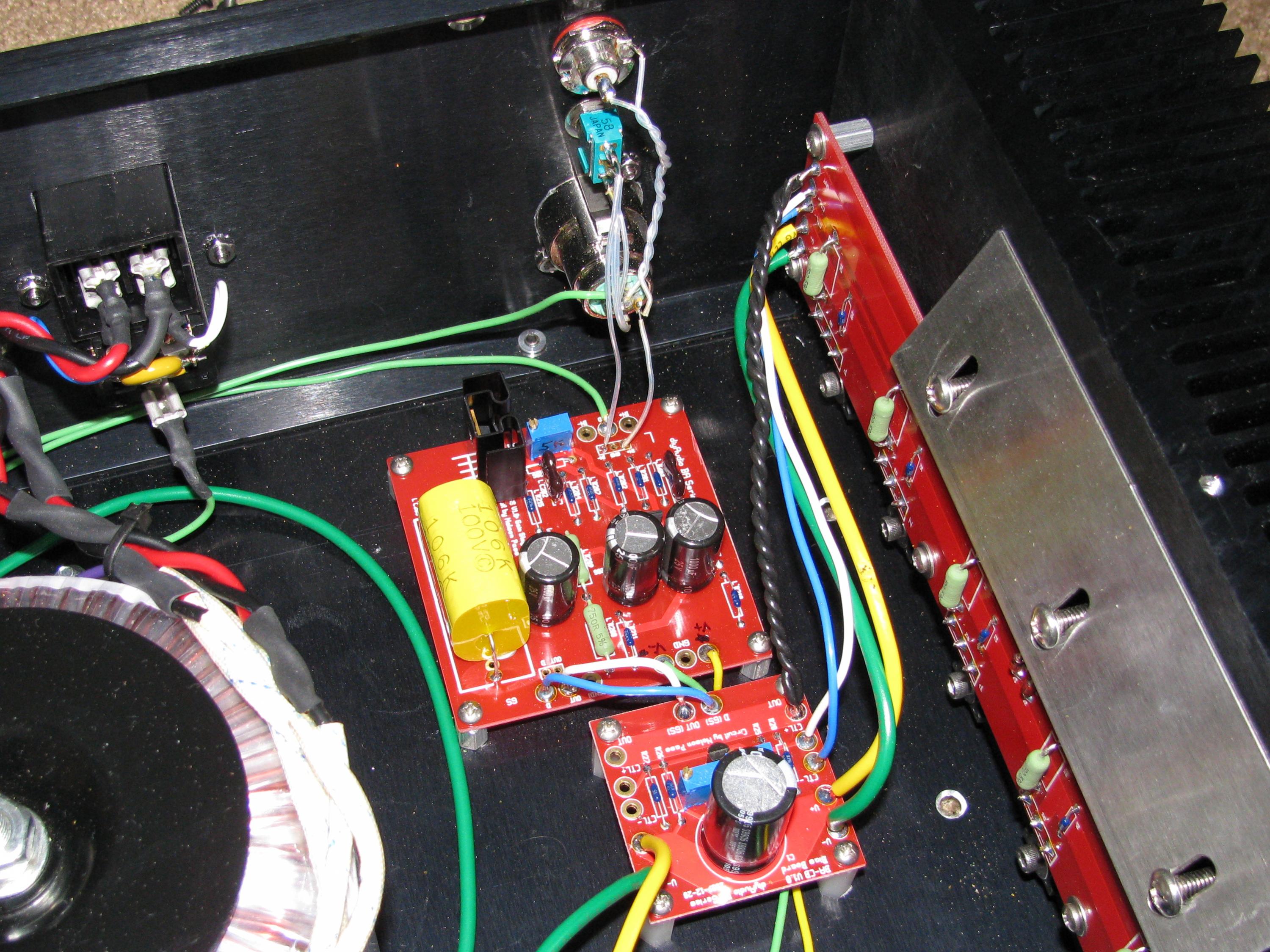

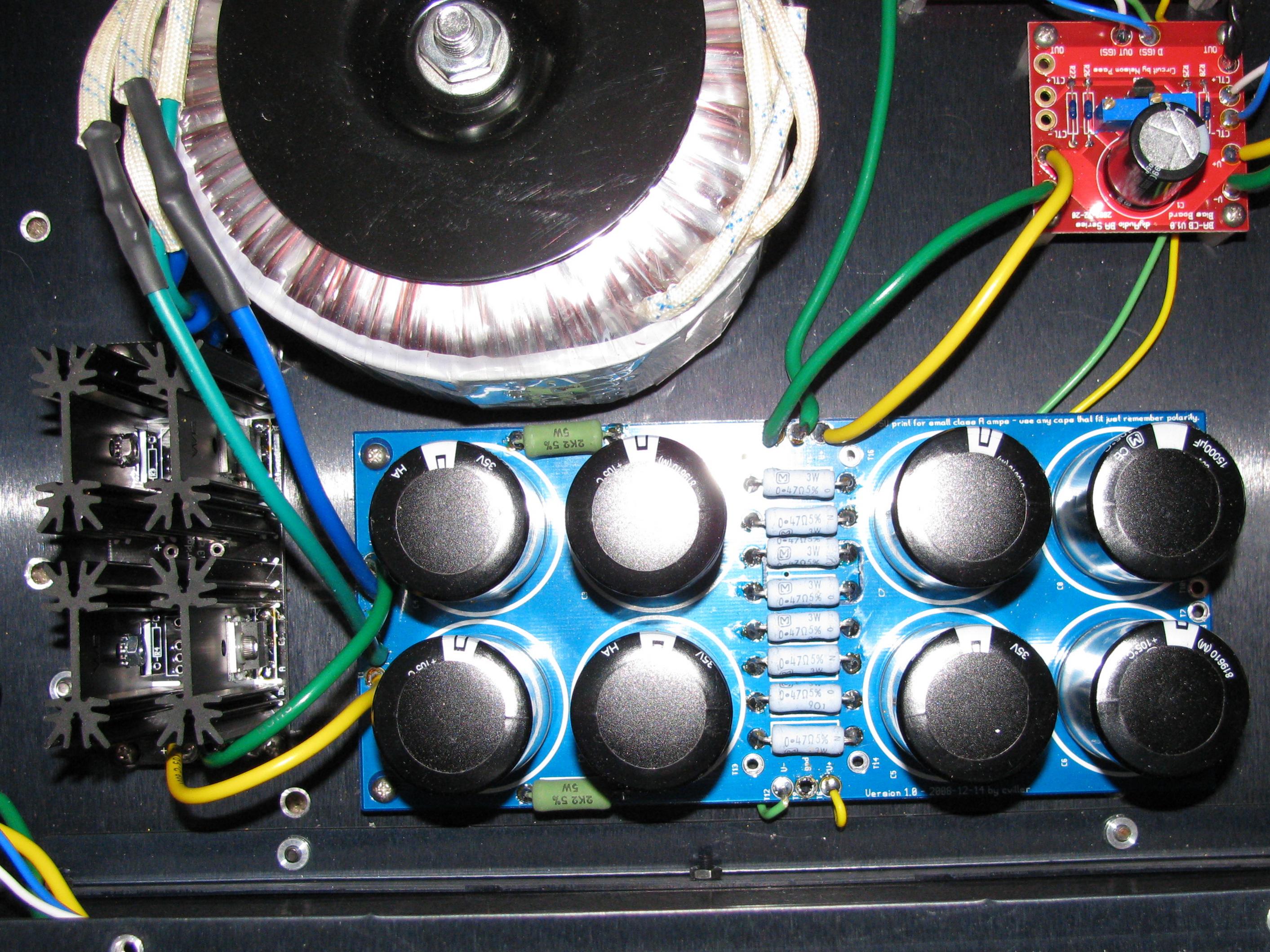

problems with my BA-2 monoblock build
Wondering if anyone can steer me in direction to look for my problems.
I am building BA-2 monoblocks. 300va transformers 20-0-20v using Cviller PS boards, and am using the diyAudio circuit boards. Built up one monoblock, and did the powerup as recommended in the BA-2 article. I am using 2 output boards with 6 matched 240s and 6 matched 9240s. Easily able to get DC offset to 0mv on the gain board and outputs. Voltages all are very close to published values in the article for the gain board. Only parts substitutions are increasing the voltages on the caps to handle the 25 or 26vdc rail voltages I have.
I can easily bias the output transistors to around 250mv, with about 0.5Amp total current draw, with no input signal. Heat levels are about 15 degrees above ambient on the heatsinks.
My problem is that when I put a test signal (1 khz from a Leader signal generator) into the unit, I do not get any gain, perhaps a loss of 15% when checked at the output of the gain board, or at the speaker outs. Even worse is that as I increase the input signal voltage, I get an increase in the current draw of the unit, such that 1 volt input takes me from 0.5A to about 2.0A current draw.
Built up the other mono and it does the same thing!
I obviously must have some wiring wrong, but cannot understand where or how….
Any suggestions on what I screwed up?
Thanks, Matt
Sorry...
Meant to say photos on the way...
