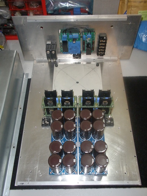

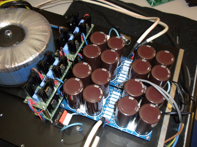

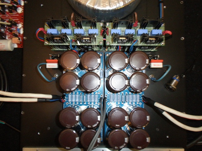

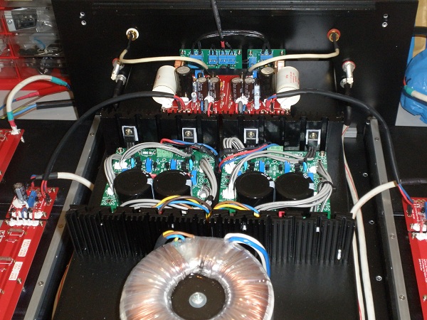

BA-2 ground loop issue
I experience a major ground loop issue after inter-connecting the amp input with the pre amp out puts.
When i connect only one of the in amp channels with the pre amp out everything is normal no any hum or any other kind of noise and when i connect the other input as well all hell breaks loose (loud hum and noise altogether).
I am only operating the amp using single-ended (RCA) input and according to BA-2 manual i have shorted the negative input (IN-) to ground on the front end pcb.
Only one ground of the front end is returned to the main star ground.
The front end itself is been supplied by a separate power supply (shunt regulator) with its common (0) been connected to the main star.
From that main star ground i connect to the chassis thru diode bridge and then to AC earth.

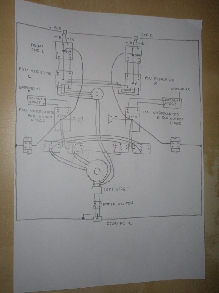

Below you can see my pcb wiring connection diagram and some photos .
Please help!!!!!

On my ba2 boards the front end ground's are separate, so if you only have one side of the front end board grounded then the other side is not tied to ground you need to tie both front end grounds to the common ground point. If I understand what you have written i.e. Only one ground of the front end is returned to the main star ground.
Check the F5 thread, someone had a similar problem. Also make sure that the RCA connectors are isolated from the chassis.
Dear JimM
It is a dual mono configuration with separate power supply's one unregulated for the output stage and one regulated for the front end the only common thing that the two channels are charring is the transformers one for the output and one for the front end.
That means that i have actually two common star grounds.
One on itch channel capacitor philter pcb all gnd's per channel are returning to its own assigned common gnd (0) point (one gnd from the front end & one from its power supply).
The RCA inputs are isolated from the chassis.
Can someone advise on ground wiring on this setup !!!!

There is probably a difference in resistance between your two star grounds and I don't see the reason for two separate connections here (I may be wrong here so see what the others say on this issue).
Also you may have some resistance issues if you are connecting the star ground to the chassis earth via two separate diode arrangements.
I would establish a single common star ground for both channels, don't use two separate ones.
This single star ground for both channels can be connected to the chassis then via a CL60 thermistor just to simplify matters. If that works and you want to put back the diode arrangement then go ahead and try it.
Also, have you carefully checked all your voltage regulators and do their grounds link to each star ground?
From looking at your pictures and what you have said it appears you have one common transformer feeding both regulators and power supplies. I would think you need to have a common ground for both sides or have seperate transformers per side. I would trouble shoot the problem starting with a good ohm meter and check for continuity from centeral ground (star ground, signal ground) to points on pc boards and power supplies.
Then check to see if chassis ground is tied to signal ground. I think if you will tie all star grounds and power supply grounds to one point you will fix your problem. Also what is your regulated voltage and unregulated voltages? Very impressive lay out send more pictures also how is your ac in wired to xformer.

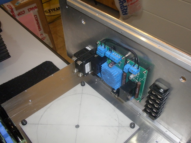

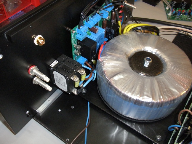

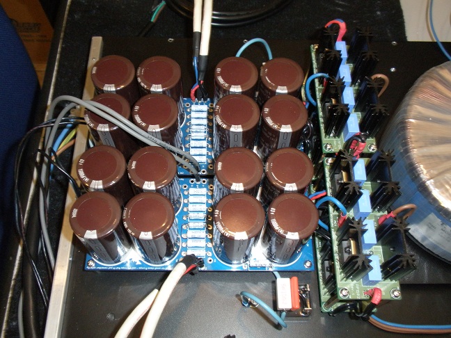

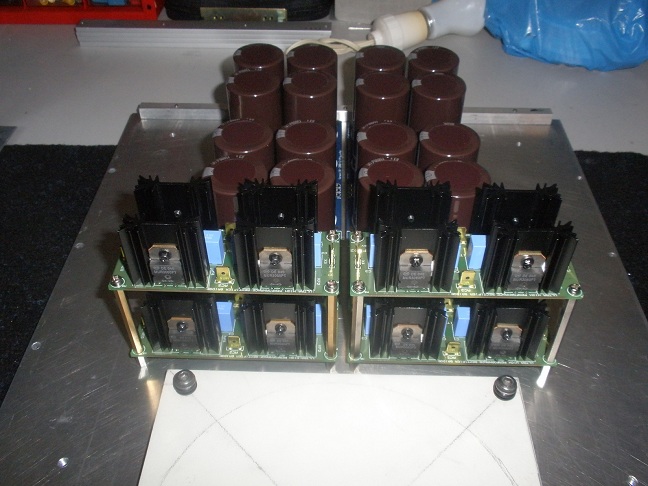

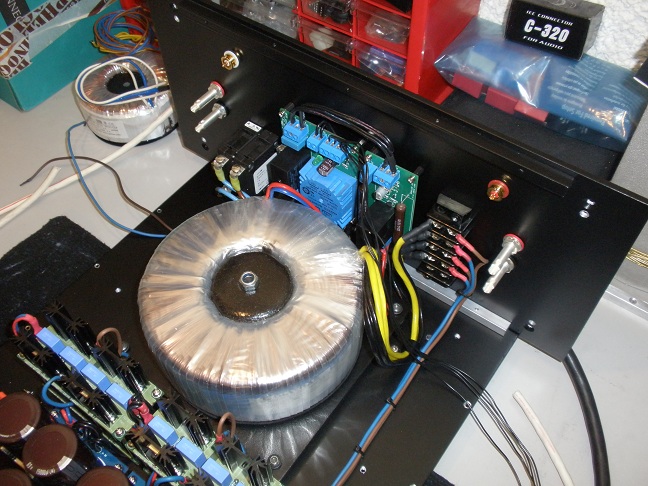

Dear JimM thanks for your advise
You can see a detail layout of the wiring and some constraction photos.
One thing that i have notice also is that the transformer of the unregulated supply is bazing excessively and this mechanical noise is audible thru the speakers.
p/s
Regulated voltage +/-25VDC (200mA) per channel for Front End.
Unregulated for the output stage is +/-22,7VDC (2,7Amp) per channel.
I think I would tie all signal grounds to one point including unregulated and regulated supplies together at one point, this should not hurt any thing if wired as shown on drawing. The other thing I would try and you may won't to do this first is bypass the soft start circuit.
QUOTE]
What current and voltage is your transformer primary winding designed for? Buzzing can be caused by saturation i.e., transformer can't cope with the primary voltage.
Does it buzz when connected to the house power supply but with the secondaries unconnected?
