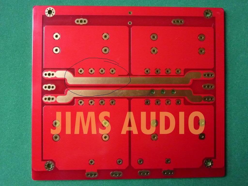

yes you're right... but found another fault on the board..... seems that if i connect the left side of the board i get 50 v from + to- but nothing from- to gnd??? se underside of board??? seems to me that there r something not cut away...
will resolder to other side and see.

I see, seem the negative rail connected to ground...If yes, cut it...cutter will work easy.. 🙂, so, is no wonder if you can't measure between V- and Gnd

http://dl.dropbox.com/u/57077275/downside fualt.jpg
is it this u see??
is it this u see??

edit : that connection is needed there 😉
if you're measuring voltages as you wrote - everything is OK with PSU pcb

ok everything hooked up. when starting the bulb gives of bright light then turns off. so what should I messure now?
if everything is connected as intended to be - between small bias pcb and big ones , you can proceed
You r correct.+24.9 and -25
voilla
pcb is certainly OK , then ......
