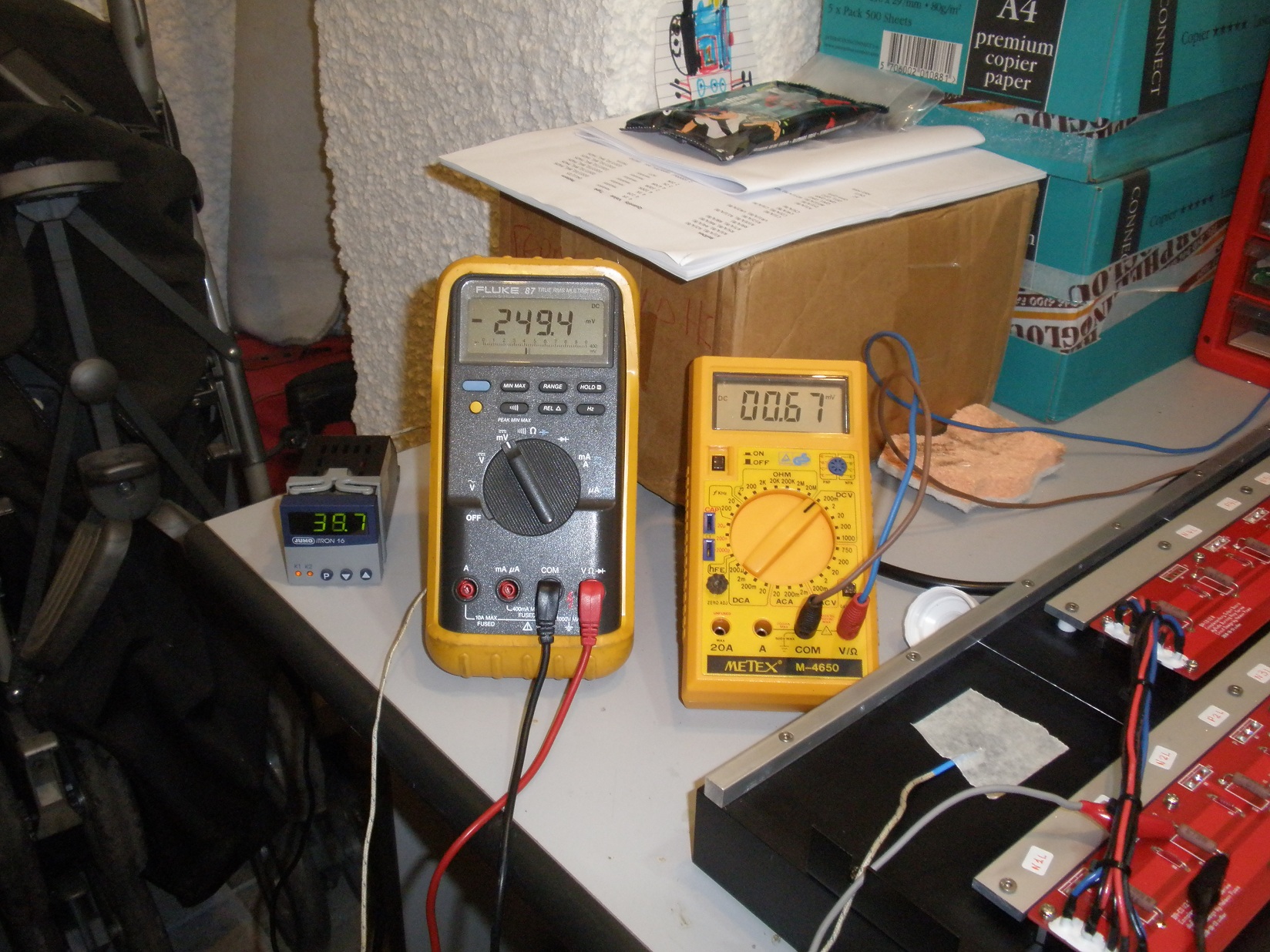

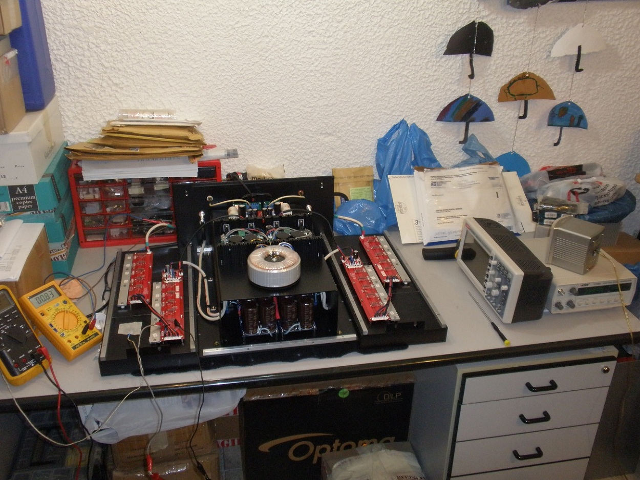

I have fix the problem regarding DC-Ofset on both channels.
Bad solder connection of the cabling in between bias pcb & output pcb.
Sometimes the root cause of a problem has the most simple solution and because it is so obvious we do not take it under consideration us the first action that needs to be performed.

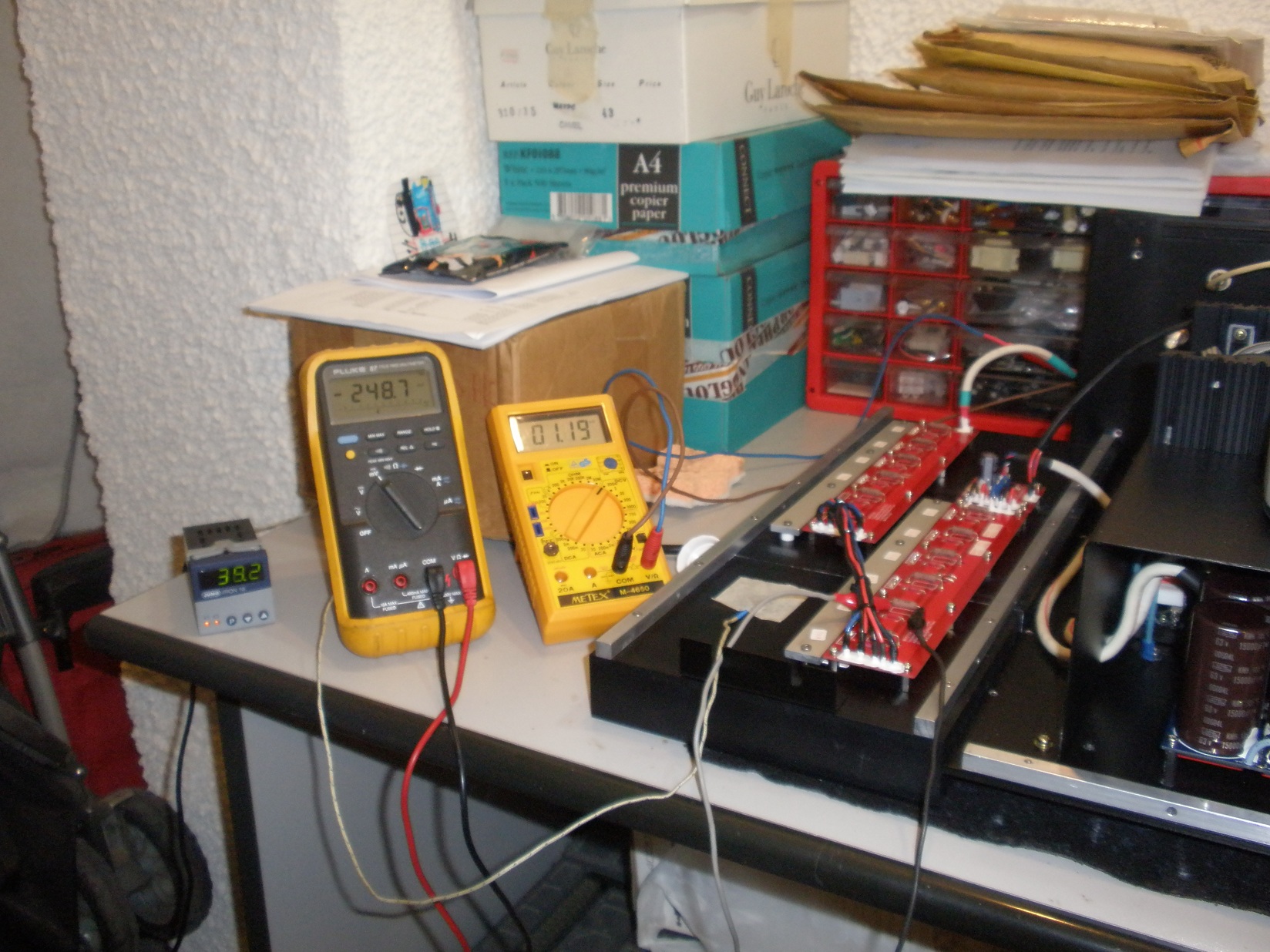

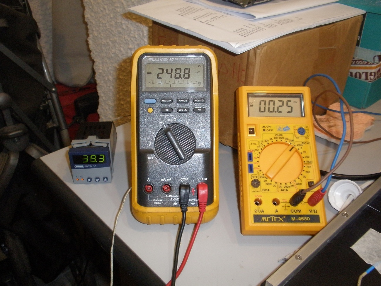

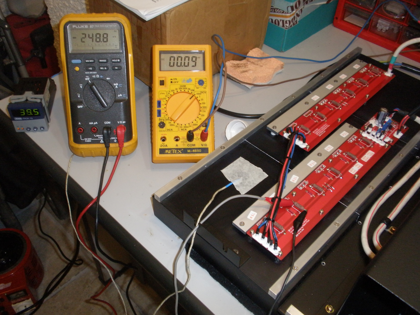

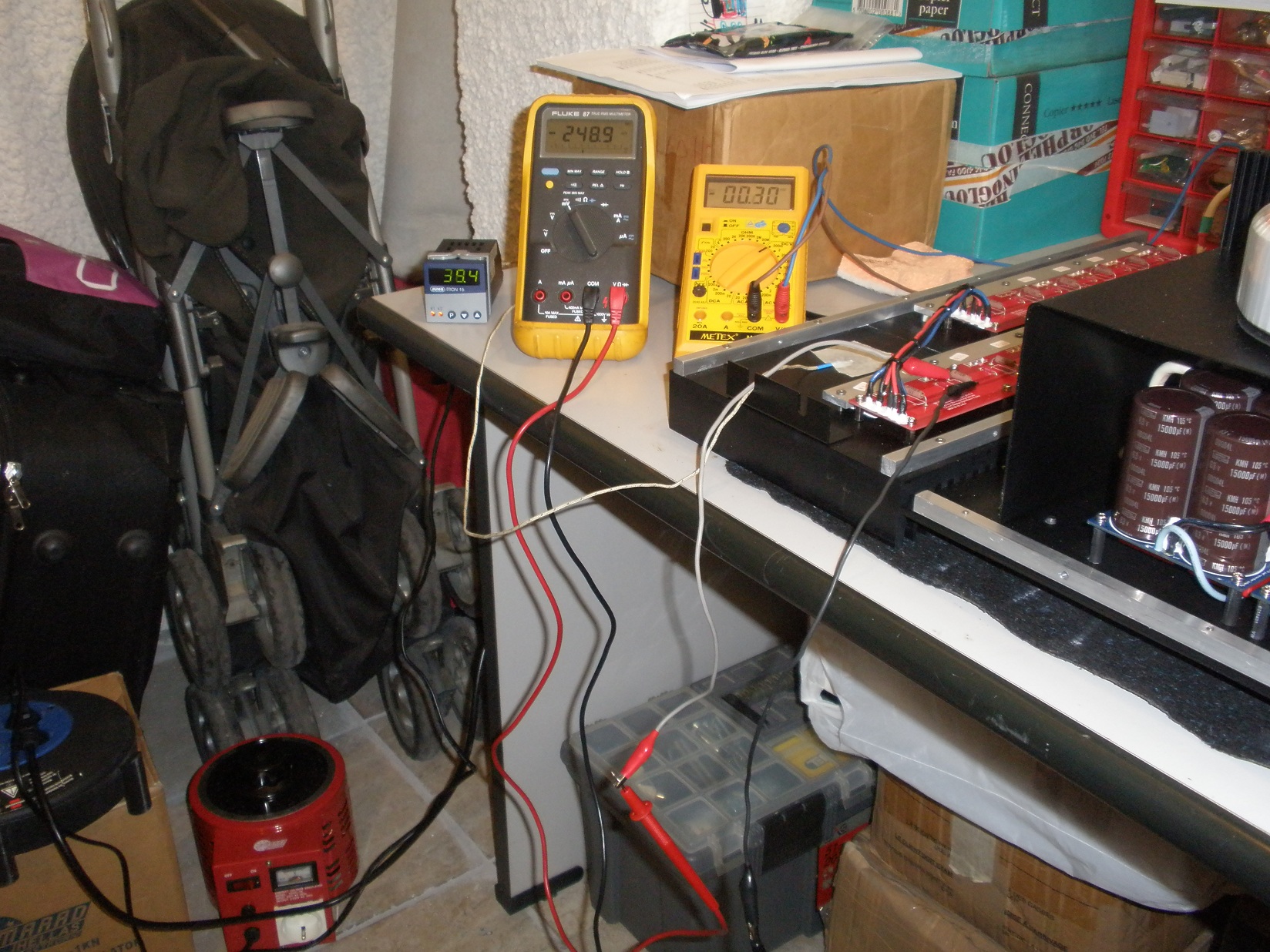

Second problem current searing on left channel (40 mV bracket in between the 10 mosfets)
According to Zen Mod we are still good.
Is it worth it to start changing mosfets or just live them as they are (is it worth the effort sonically speaking).

just leave them as is and enjoy
let say that difference of +/-8% in current isn't worth prolong waiting to hear it
when you have a chance ( and bug is obviously there , so you'll buy them more , for sure ) to buy more mosfets , then match them tightly and replace
