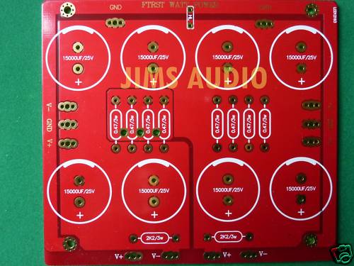

I think that this is pic of article on which FW is used without permission
further - my crystal ball is muddy these days , so I can't imagine how you populate and connected that bare pcb from pic

when only 1sec is con. I get 25vdc on the powerboard. problem is when I con. the 2sec from torrodial then I get 50v. so.... what to do? think I read somwhere a while ago that there should be a way to con 2 secondaries... thank you all for any help.

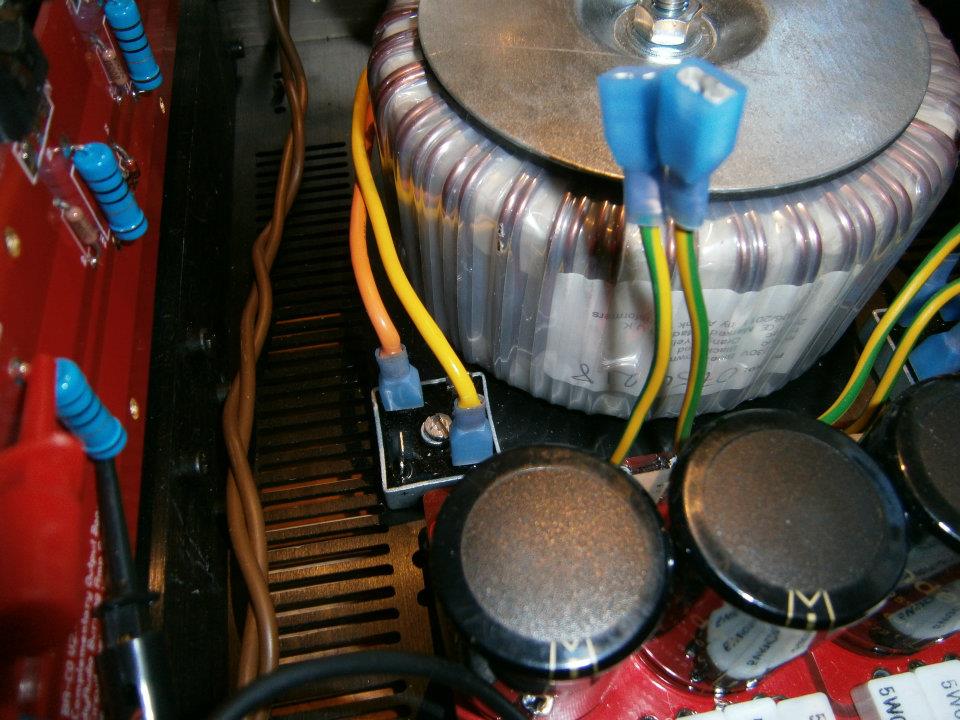

the or/yel are not twisted on their route to the rectifier.
I wonder if the red/blk are similarly untwisted?

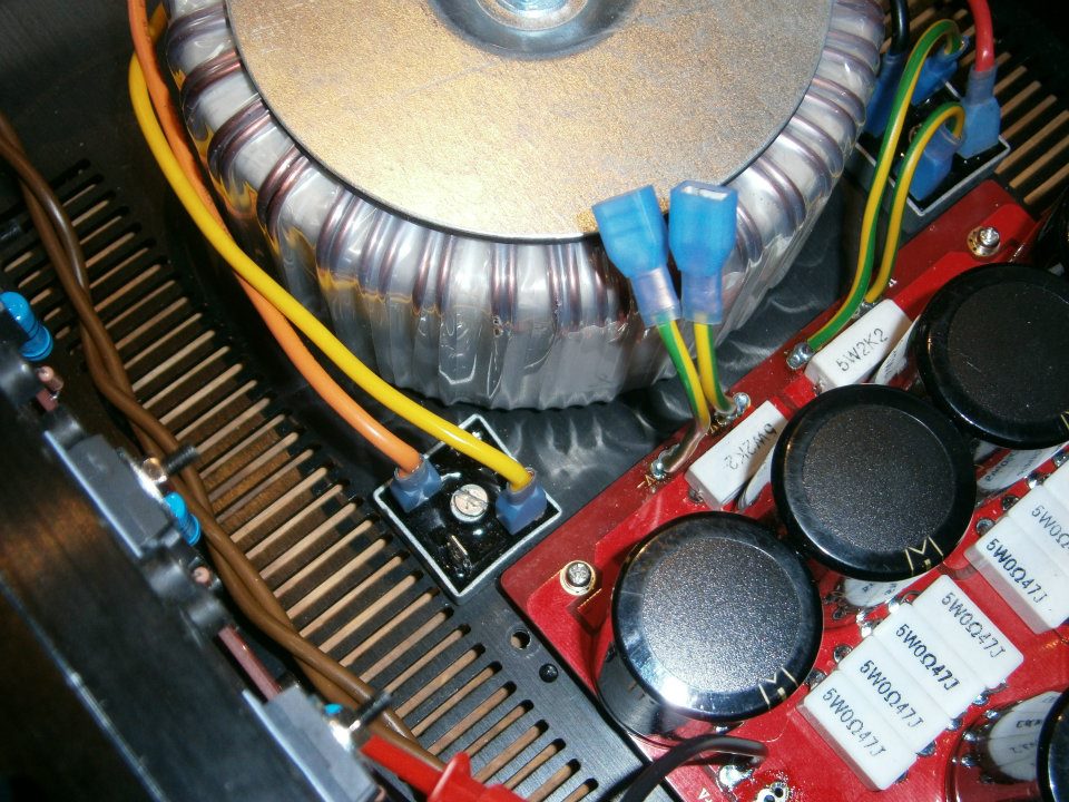

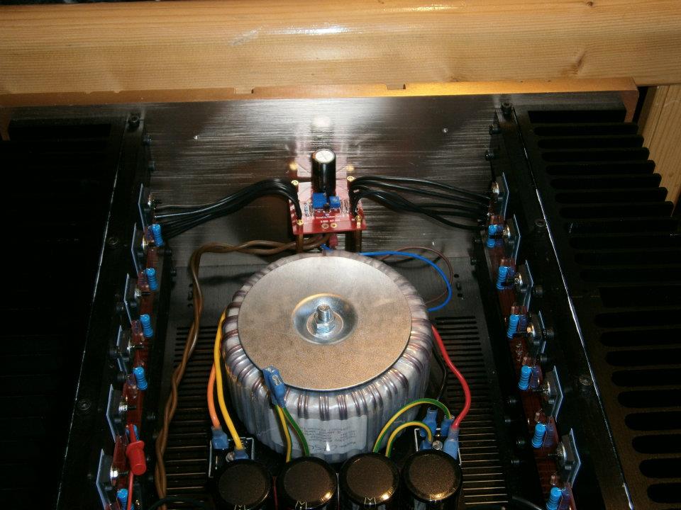

for now they'r not twisted. but the problem is getting it up and running, or should I say them (have 2 monoblocks)
for now Im getting 50 vdc to psu when 2 sec is connected... look at pics.. see I disconnected one sec. and then I have 25v soooooooo whats wrong ??
first - search for "bulb tester" ( AndrewT is strong proponnt of that tool , with reason) ;
make one
connect amp via BT (say that 40-60W is good for start)
disconnect amp pcbs from PSU and test just PSU
from pics I see that you connected Graetzs as needed - check polarity 3 times before powering up!
power up and measure voltage on each output
BT will lit brightly and dim after sec-2 if everything is OK
if BT is bright for prolonged time , something is wrong
measure voltage between each + and gnd - you can expect DC voltage in range Vac x 1.41
measure voltage between each - and gnd - same voltage ( opposite polarity , off course)
example - for 18Vac secondaries , you can expect 18x1,41~25Vdc
when you are done with that , report here
but first !! write what wire colors are written on xformer - we need to check did you connected secondaries as needed
