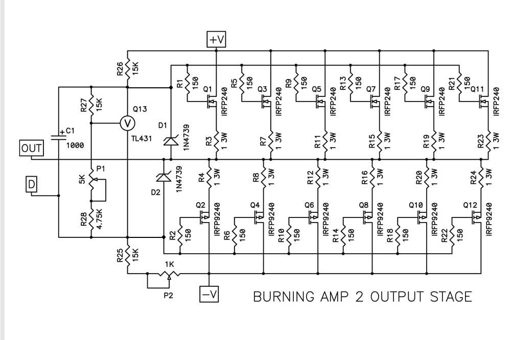

Dear all,
Two problems on output stage.
Bias current on left channel
I have measured all bias resistors on both channels and they are very close to given reference values.
Left channel example of that values (the problematic one (40mv bracket) in comparison to right channel (10mv bracket)).

High Output stage DC-offset value on both left and right channel
Left channel 160mV and right channel 130mV
Can someone with more experience advice on how we can resolve these problems?

What are these figures? 1.1ohm-149.9ohm. Should this read 1.1ohm-149mV reading across the resistor?
I told you about possible differences between source resistors (in value )
those 150 ohms resistors aren't "bias resistors" in any meaning ; they're gate stoppers , intended for preventing oscillations and somewhat for shaping frequency response of mosfets
do your homework - read all Papa's papers , if not for your own pleasure - then from respect for his sharing ; papers are written to be read .
adjust DC offset on output with P2 on output stage

turn off amplifier ;
turn pot P2 approx. to middle position ;
if offset is positive - solder 220K resistor across R25
if offset is negative - solder 220K resistor across R26
turn on , set offset with P2
setting offset - referring to this attached schematic :
(FE doesn't have anything with output offset )
Is this to compensate for possibly unusual difference in N vs P parts? Reason for checking offset polarity is to identify which side is in need of compensation.
