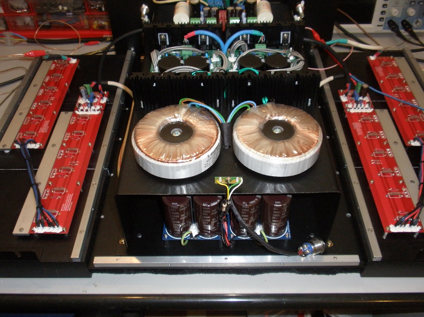

Humm Problem
Dear all,
The hum problem when both front end inputs where connected with the outputs of a pre amp has been resolved by using two separate transformers (one per front end regulator also the main psu transformer for the output stage has been changed having now (4) separate secondary windings).
The amp now is silent.

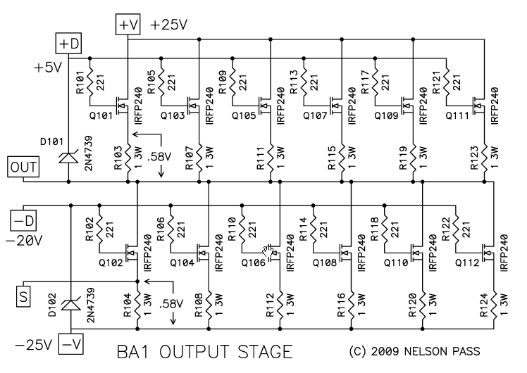

DC offset of Frond End
From the BA manual
"Set P201 to adjust the Drain voltage of Q203 to approximately 0 volts"
Where can we measure in order to set P201 to zero on frond end?
From the BA manual
C203, at the junction to R215.

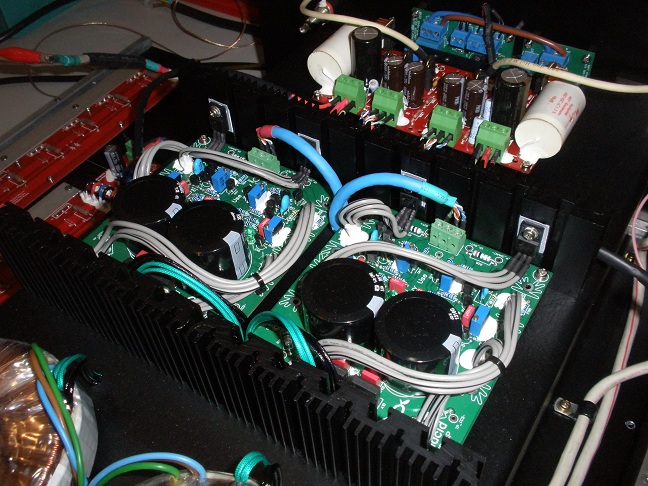

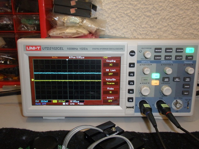

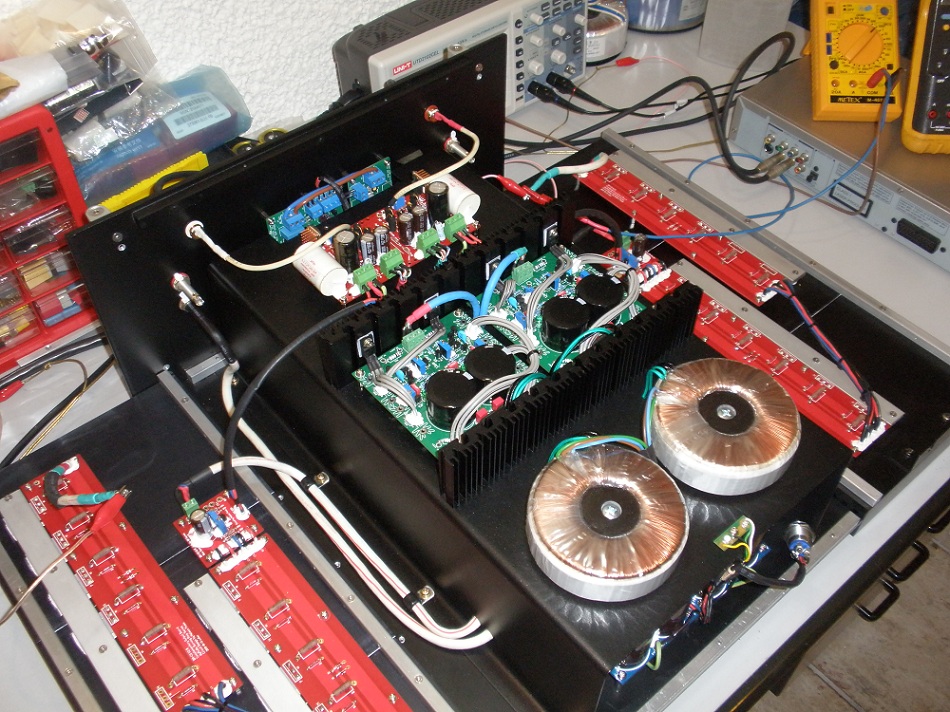

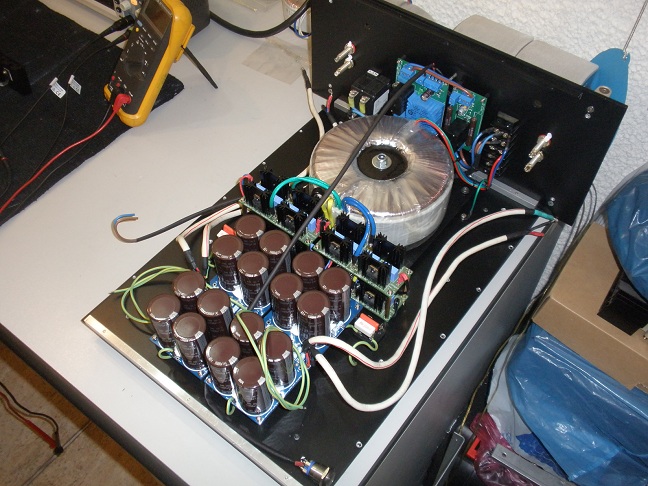

nice layout looks as pro as you can get!
Adittional photos
nice layout looks as pro as you can get!![]()
Thanks for your kind words
Nikos
