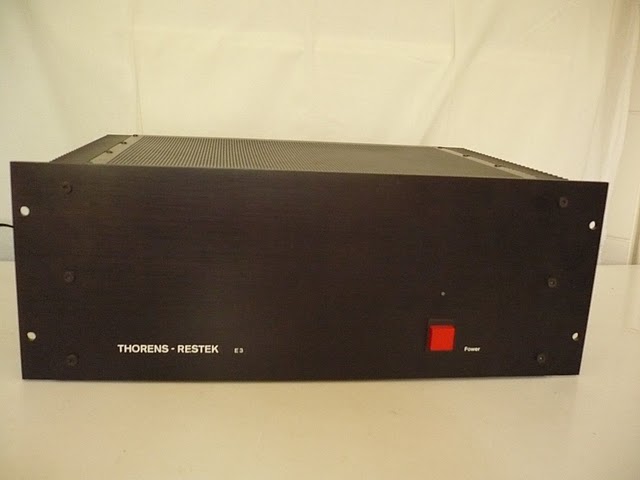

I have two old Thorens, Restek E3 monoblocks which I thought I could use for a couple of Nelson Monoblocks. Only one of the two heatsinks in each case has been drilled. Any one know what sort of heat these were designed to dissipate?

Meine alten helden-thorens restek e3 - magnus.de Forum
http://www.thorens-info.de/trvorend_2.jpg
http://www.thorens-info.de/trvorend_1.jpg
www.tmr-audio.de/tests/audio_11_84.pdf
(test in German between Accuphase P600, Luxmann M-05, Hiraga Le class A, Krell KMA-100, Restek E3 and TMR-1000ES)
Thanks for taking the trouble to reply. I can't understand a thing in German but at least I feel guilty about it. Interesting photos of the original Restek design which I haven't seen before.
At present I have six mosfets on one of those heatsinks with a bias of about 410mA. Things don't get too hot with an ambient temp of about 22-23 deg C. So the heatsinks are coping with about 59W output from the transistors.

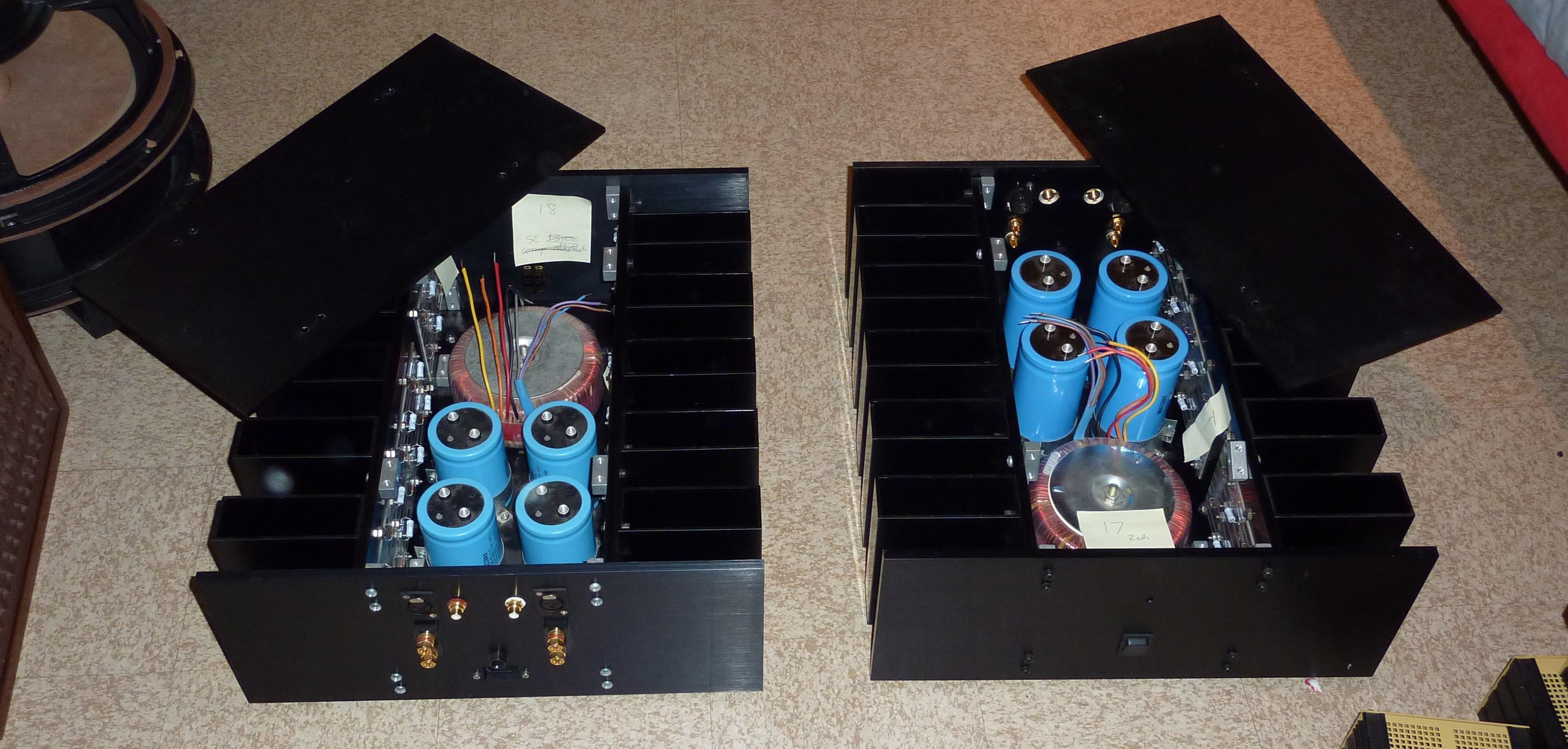

I was wunderin if some kind soul would post the dimensions of the BA chassis in the pic here... I want to build one of these, as I think its gorgeous!,, but need some of the specs to get going,,, such as dimensions of the rectangular tubes... height, width and length of the outside of the chassis... I should be able to figure the rest 🙂

I think that design originated with the PLH project. You might find the details in that article?
Front and rear panels:
7" x 17" x 3/8"
Overall Chassis front to rear: 18 1/2"
Tube fins 4 1/2" x 1 3/4" x 6" h x 3/32" wall thickness (EDITED: I changed 1/8" to 3/32" for wall thickness)
Clear between tube fins: 1 1/2"
Top & bottom covers: 9 3/16" wide x 1/4" They overhang the central enclosure walls on the sides
External width of central enclosure: 8"
Side walls of central enclosure: 6" high x 3/8" thick
Bolt holes in front panel: 3/4" and 1.5" from top & bottom Seem to be 3/16" bolt
Bolts holding tube fins: 1" from top & bottom (2 bolts per tube)
In front Panel: LED hole 2 1/8" from top, lower switch flange 1 1/2" from bottom
