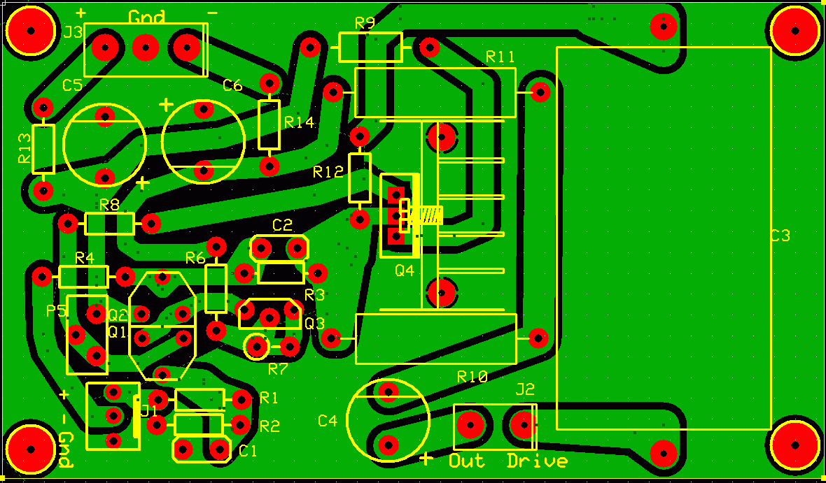

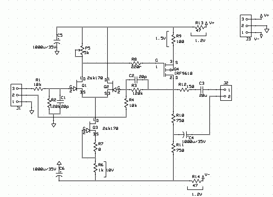

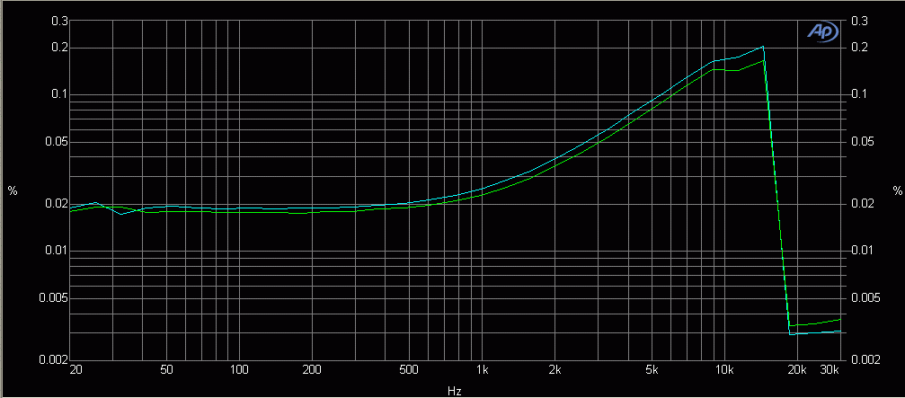

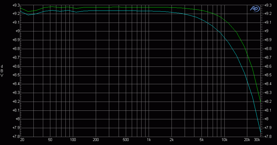

I'll try to give as much info as possible. I've made a complete dual mono amp, 50,000uf/per rail (so that's 200,000uf in total,CRC filtered 20mF-0.11R-30mF per rail), 2x 250VA, 18Vac toroids which give me about + /- 25Vdc after rectification. Bias is about 1 Amps (total per channel)
The front end is on a seperate PCB, and the bias+output stage on another PCB.
Now, I've noticed that the amp has a limited bandwith, and that there's some weird distortion in higher frequencies. I have used a IRF9610 (brand Siliconix) as VAS. Could this be the 'IRP channel problem' what Nelson is talking about?
Also good to know is that i get almost exactly the same measurements when I disconnect the output stage and measure directly on the output of the VAS.
Static measurements are ok : I have the 10mA from the css, can alter the DC output to zero, etc...
I've attached the schematic I'm using, the PCB layout of the frontend, bandwith measurement and THD. Measurements has been done with balanced input.
Does anyone know what I have done wrong or if this is normal? Could it be that I've just done a bad job at designing the Frontend PCB ... Would it help if I'd remove the copper area? I must say that the real PCB has a lot more clearance between the gnd area and traces as it appears in the picture. Both channels behave in exactly the same way as you can see in the graphs. Measurements has been done with and without load, but this doesn't improve anything. Maybe I have bought counterfeit 2SK170's, or counterfit IRF9610?

Really, Silioconix IRF610?...the amp has a limited bandwith, and that there's some weird distortion in higher frequencies. I have used a IRF9610 (brand Siliconix) as VAS. Could this be the 'IRP channel problem' what Nelson is talking about?...
My understanding was that Vishay baought the IRF610 line of devices lock stock and barrel. Processing equip and all from IR back about 2005. Siliconix was already an existing company that had been boaught by Vishay decades earlier? You actually can read Siliconix logo's on these parts?
Thery are likely Vishay and not siliconx? And they woulld have the 1-2k and higher distortion phenomina of the IR parts?
You can always test the parts easy enough. A piece which includes testing
for this issue is in the article on Mosfet testing on the Pass Diy
site. And it's not the end of the world, either.
If the problem exists in this part, you have an opportunity to listen to it
and some other in comparison. At this time I think the best alternatives
are the Toshiba 2SJ313 (P ch) or 2SK2103 (N ch).

I have have tested these MOSFETS and JFets using your method as described in the article, and they behaved normally and as expected... I agree that this is not the end of the world, but I'm keen on knowing what went 'wrong', just to learn from the experience . I'll try and build a small test-setup to check the behaviour of the VAS, and see if this one is responsible for the strange THD curve.
I will try getting a hold of the alternative that you have suggested and experiment a bit more with the VAS. Thanks Nelson.
