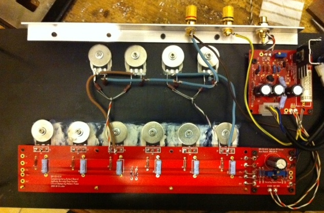

more mosfets
I originally built with 3 pairs of MOSFETs, about 450 mA bias. I added two more pairs and was delighted with the result, finding much better bass (to my taste obviously). I hadn't changed the bias so I had more class-A current available, higher device temperatures as well as more devices.
I did some configuration testing and judged them listening to the album 'xx', it's pop but contains some really deep bass passages and a lot of minimally accompanied singing.
3 pairs, 450 mA per pair: good, for me not quite as good as my KT88 push-pull
3 pairs, 700 mA per pair: better, more detailed I thought
5 pairs, 410 mA per pair: my favourite, really impressive bass, I think this is better than my KT88s, and a lot safer to build 🙂
So, in summary, I think the amount of current and how hot the devices are is important, but just having more devices will have a impact also. If you've gone to the trouble of building one of these babies, you might want to go the extra yard and check if more devices improves it for you too.
Also, the heatsinks are throwing off heat now
(dQ/dt)>>0!
