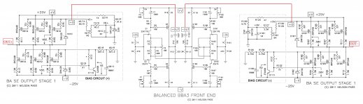

Assuming you mean 6 pairs, like in schematic in post #505.
Yeah that is close enough if we are talking approximations.
i mean 6 devices (3pairs) on each half balanced.
so 3pairs for positive and 3pairs for negative side.

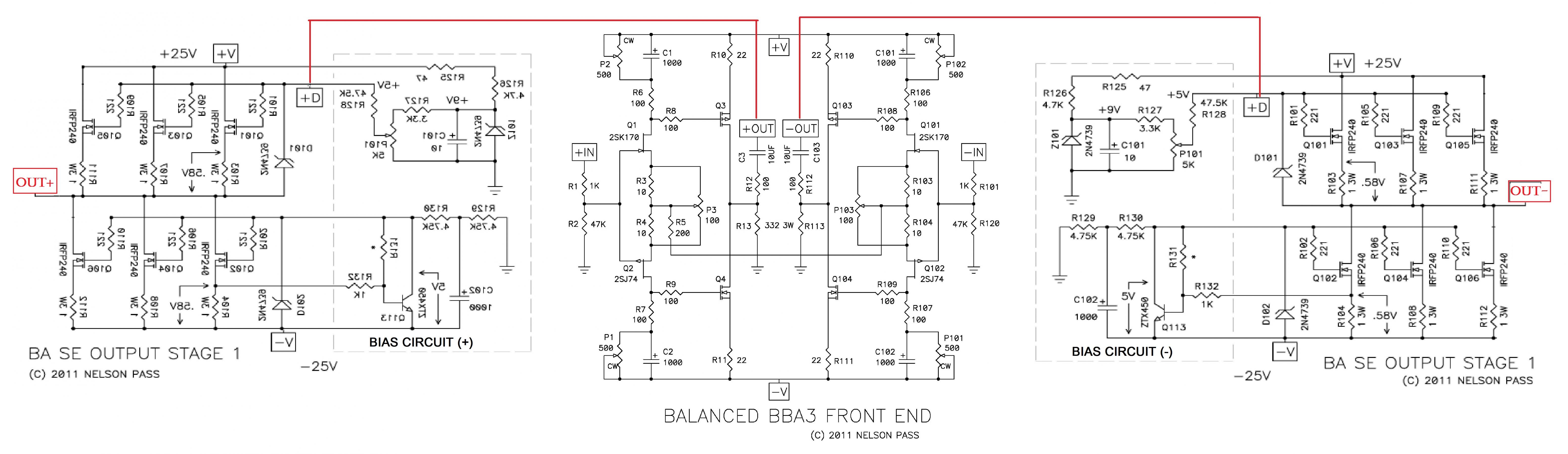

We will need to modify the biasing circuit for the negative rail or consider using different source resistor for CCS (around 0.75Ohms)
Or leave biasing circuit unmodified and run 8 or 9 pairs instead of 6 pairs
i don't understand what you mean modifying negative rails bias circuit?
why only negative side?

1) So half the number of devices of the schematic you posted?
2) Biasing of the CCS is fixed at around 0.6V across the source resistor of the CCS mosfet.
Biasing of the mosfet from the positive rail is already adjustable through P101.
No problem though we can make it adjustable by addition of suitable value for R131 in your schematic

yes half the number,
please see new attachment.
