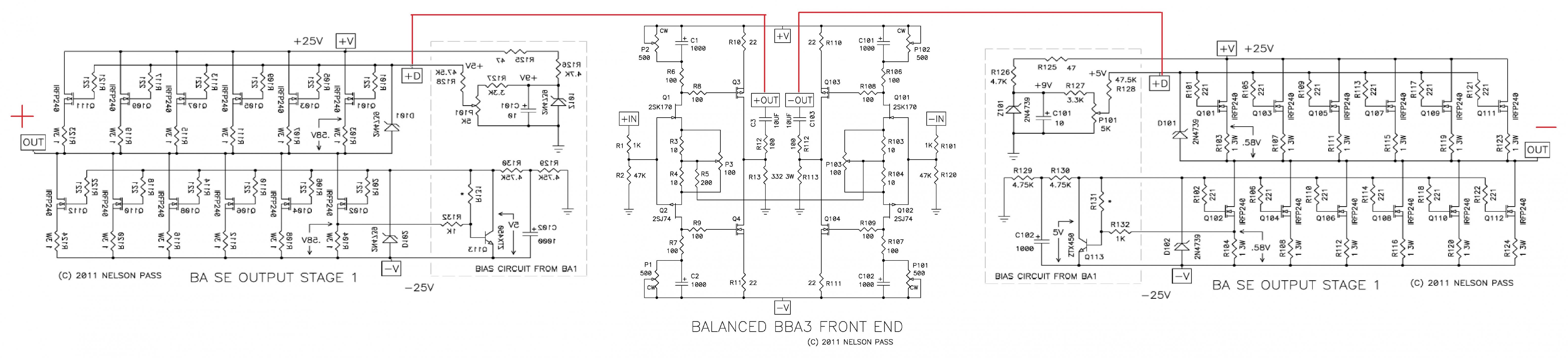

hello,
since i can not found more info about BBA3 driving single-ended output followers, (so please see attachment) my questions are:
1. Is this how the BBA3 FE will be wired to the BA SE output stages?
2. so each output (+) and (-) has its own bias circuit,
3. the speakers will be connected to the (+) and (-) output, without the ground
4. what is the voltage rails and current needed for one channel (i plan to use 12 mosfet per channel, 6x(+) and 6x(-) as balanced)
hope found the best answer here.
thanks.

1. off course it is
2.off course
3. yup
4.due to mosfets internal capacitances nature , I wouldn't go bellow 18V rail and 130-150mA per mosfet pair , pair taken vertically

1. Yes
2. Yes
3. Yes
4. How much power did you want?

thanks all for the bold and to the point explanations...
and since mr.pass also confirmed, so i think i am good to go with this balanced setting now.
well, since this is a burning amp, i will definitely expecting high watts in class A with single ended outputs, let say 100W RMS if it is not superfluity.
i have 24Vac transformers, 35Vdc caps banks, and 0.47ohm source resistors, in hand.
how much bias i must set, to achieves 100watts into 8ohm speakers.
thanks.
If Single ended it surely will be a burning amp
You will need 5A bias on each half of the balanced output stage. (That will be 10A drawn from the power supply for each channel (20A for stereo)).
You will need very large transformers. What VA rating are your current transformers?

5A bias on each half...
so if i use 6 devices on each half, that's mean about 0.8A per device.
with 0.47R it must be about 0.4V through this source resistors, is it correct?
transformers are 600VA.

i mean balanced output stages / follower.
(instead of connectors)
Assuming you mean 6 pairs, like in schematic in post #505.5A bias on each half...
Yeah that is close enough if we are talking approximations.
2 x 600VA Transformers with 24VAC secondaries is borderline acceptable.
800VA would be better.
But if you already have them you may as well give it a try. You may or may not get some mechanical transformer buzzing. If the transformers are noisy then you may need to reduce the bias or buy bigger transformers.
If you do decide buying new transformers is necessary, then 18V to 20V AC secondaries is more than adequate to give you 100W in a balanced circuit.
