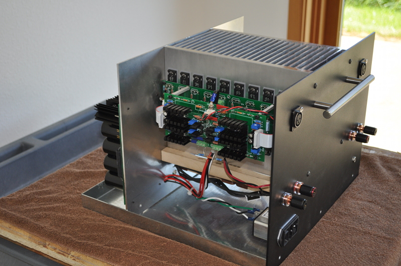

A question about heatsink temperature
I have built an amplifier with a power dissipation well over 300 Watts using heatsinks mounted fin-to-fin which allows the option of fan cooling. See the photo below. I have 3 options for cooling.
  • Natural convection: stabilizes at about 60C, 35C above ambient.
  • Noctua 120mm fans at 600RPM using series resistors, the slowest reliable speed without stalling, stabilizes at about 42C, 17C above ambient.
  • Noctua 120mm fans with PWM control at lower speeds to obtain 50C, 25C above ambient.
Does anyone have opinions about the best option?
I would use a fan and whatever means you need to get it to go as slow as possible... You are so close with natural convection than any bonus from forced convection will be more than sufficient.
As you know, you don't need to move much air to make a noticeable difference.
a fan using a resistor (= high source impedance) is liable to stalling at start up. This is especially a problem after a few years/months as the lubrication becomes thick.
Pass posted a fan motor PSU that gives the motor a starting kick and then drops to running voltage.
PWM control may give a problem with interference, but otherwise is a good solution.

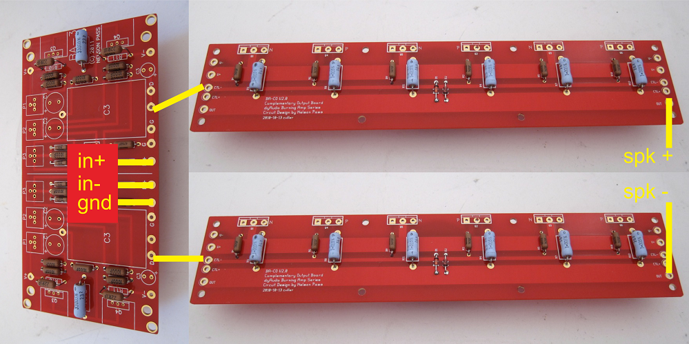

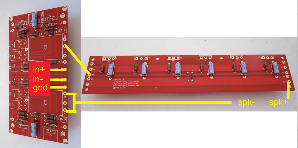

still curious about the balanced settings.
is it each gain stage board + two output boards
or can it be one gain stage + one output boards???
pictures below are for illustrate what i mean.
can someone explain? thanks.
rolandong,
Sorry I forgot to inform that I want to make balanced ba3 with single ended output.
Not complimentary output.
Pictures above are illustrated only, how I will connect the boards.
Is it possible? Thanks.
