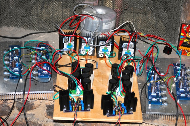

BA3B with feedback
Thanks again to buzzforb - this time for the great BA3B with feedback boards he provided. I have these boards up and running with crippled F4s. They are driving my SEAS woofers. Very wide and deep soundstage with deep articulated bass.
I do develop a "swishing" sound in one side after about an hour - so I will be looking into that.
Will upload pix when system lets me
Here it is
Is it possible to post more detailed pics? Close ups of each part? You built the exact setup I'm considering.

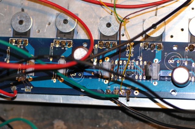

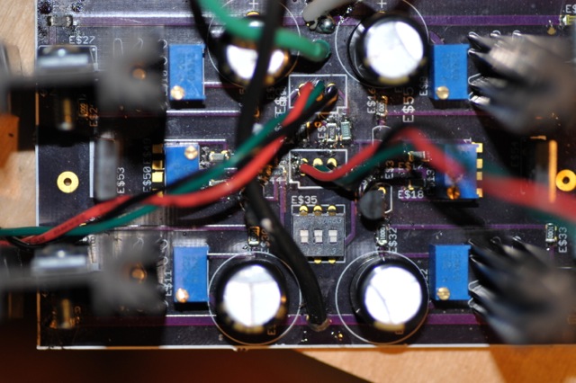

Here are some close-ups
Apologies for the blurriness of buzzforbs BA3B w/feedback board. Heat sinks and caps were too tall for the limited depth of field.
The F4 boards are from the DIY shop. They are stuffed "crippled per posts 3355 and 3356 of the F4 thread
PSU are from Tea Bag

everything is ........ somewhere
Not really sure, but that looks exactly like what I am making However, I am gathering some curage before starting the drilling and tapping of the 48 holes...

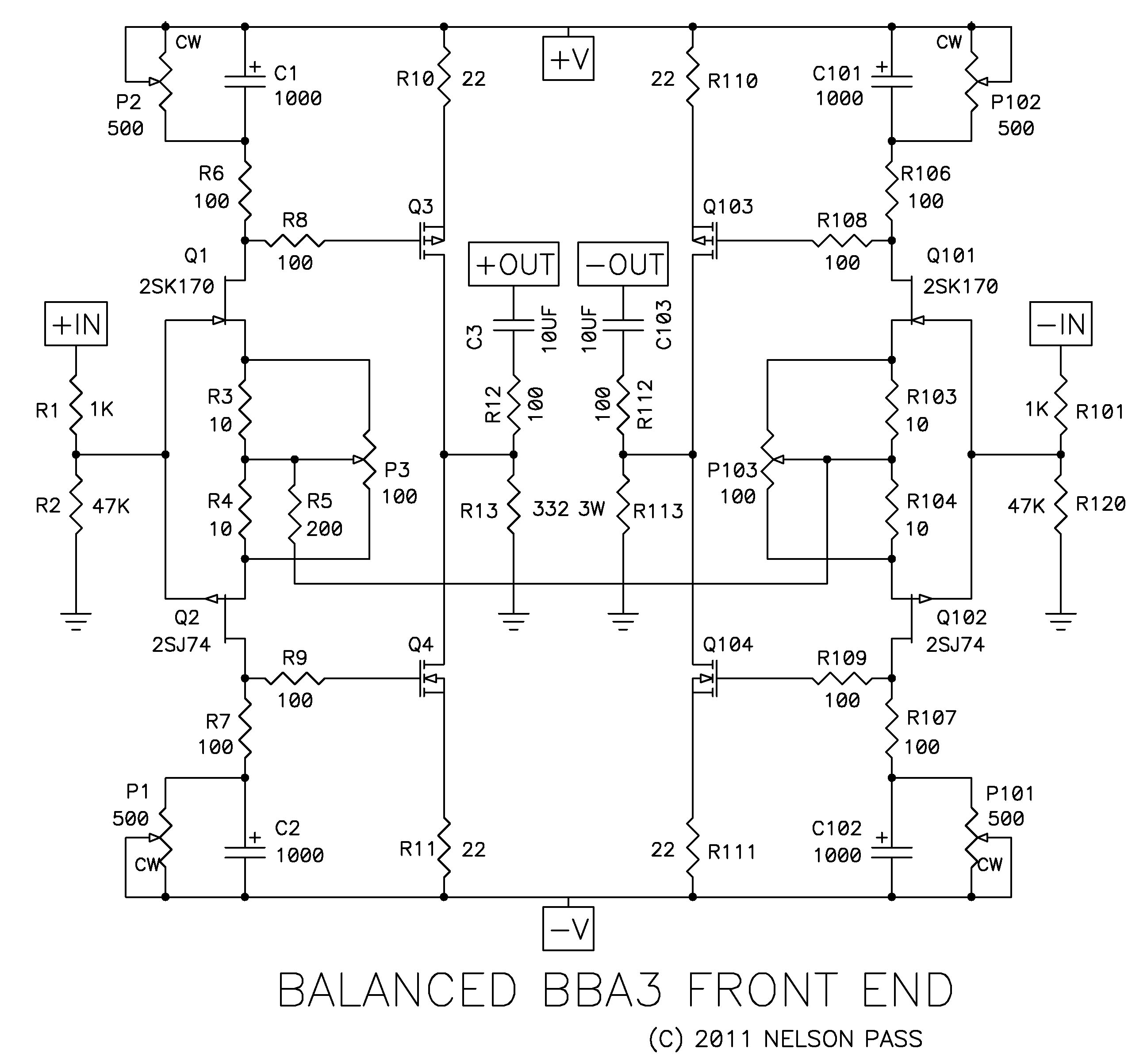

Zen mode , If i use 2 x 20v 500 VA transformer power supply for this circuit , what would be the power out put in class A ..... ?
comparable to XA30.5
give or take few watts
under condition that you have enough mosfets in output stage

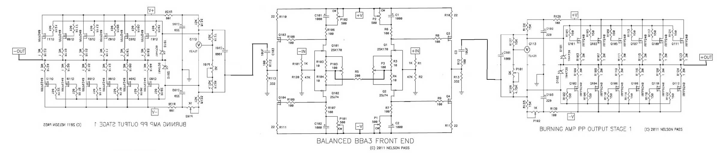

This is the board for unbalanced BA-3? If yes, is the balanced version BBA-3 board available to purchase?
If so, where? If not, where can buy this unbalanced board?
- Burning Amp BA-3b (Balanced)
