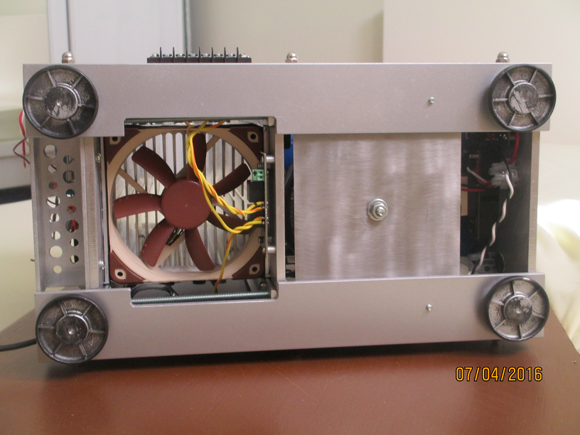

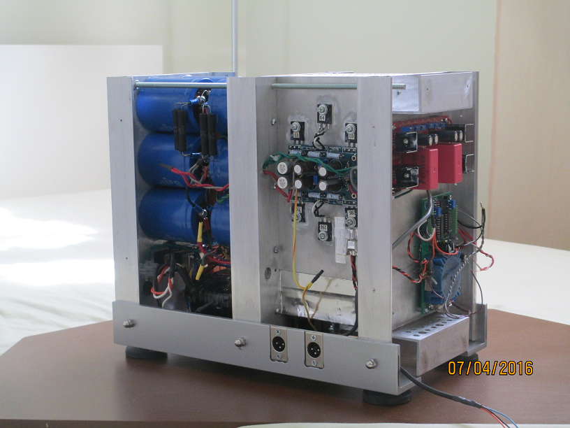

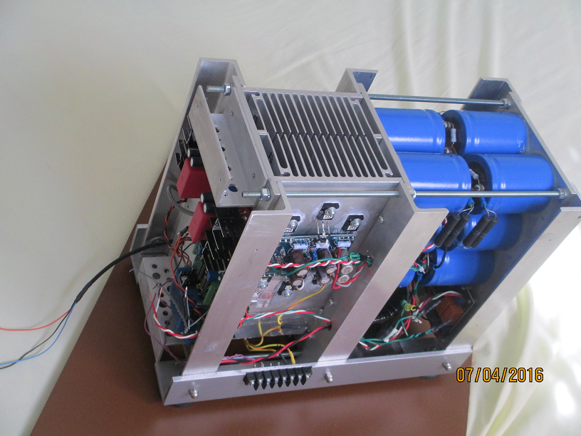

the amps work fine. the only issue is that the FE card is mounted on a vertical plate and as the heat moves up the upper Toshiba pair runs really hot (I can put my finger on the heatsink for about 2 sec only). So I am thinking of cutting some copper tabs and adding a bit of heatsinking surface.
If you do not know how I make my amps I attach here a few pics. I use a fan for the main heatsink i.e. for cooling the output stages. the section right behind the front panel though has no forced air flow. I have a control board there and the balanced FE board. I do not feel like taking some fets off the board to mount them on the vertical plate (1/4 inch Alu) which should definitely do the trick but it would look ugly with wires etc.
each mono block PS has over 450,000uF in capacitance. so this vertical layout works for the most compact package.
