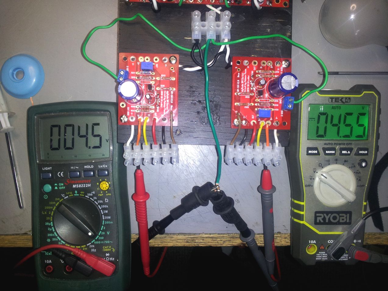

I was able to get all the settings/readings correct, everything wired back together and successfully played music through the amp. A victory of sorts!
However, the power supply is over heating again and begins to emit some smoke when the output boards are attached.
Everything checked out fine with direct connection from PSU to the front end only.
No problems with the PSU directly connected to the bias boards only. For initial turn-on I set the bias to 3.0 VDC. Should I have tried to make that adjustment with the output boards attached??
I did not test the PSU > bias boards > front end combination.

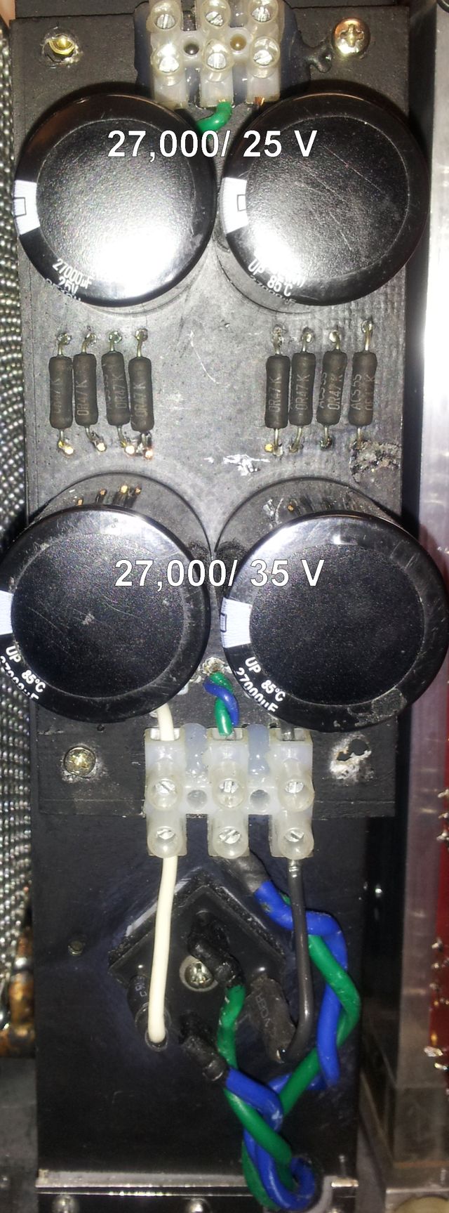

Though my home-made PS boards worked well for months and appeared stable over the past few days, I had planned to get the forum store boards for final assembly. These also still have the lower quality 0.47 resistors. They will be replaced with new Panasonic
So I might just as well add a fresh set of PSU caps since these have been subjected to some overheating at least twice. When I built this power supply I used what I had which was pairs of 27,000/35 and 27,000/25. I'm assuming matching all of them will perform better.
So I'm asking for some recommendations on what to buy.
Specs:
500/18 Va on each side.
12 output devices each side
Stock build with standard voltage settings as per NP article.
Speakers @ 8 ohm nominal
As mentioned earlier, some mods/experiments to increase output are likely in the future. Should that be a consideration in the new capacitor selection?
Specs:

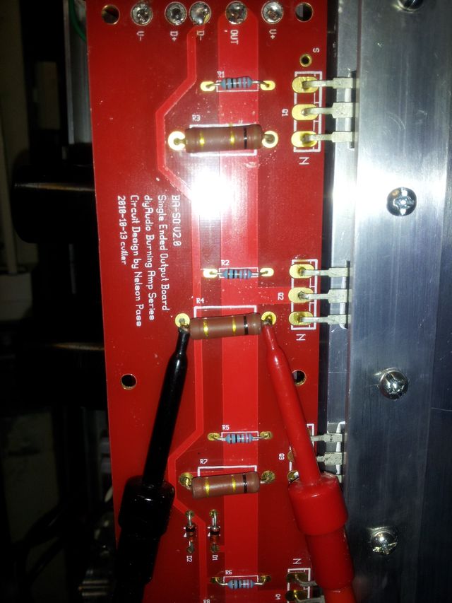

Bob - 3.5 Volts? With 24V rails that is 84W per device!
Bias should be about 0.2V across the 1ohm resistor.
Does that mean the 4.5 VDC referenced setting simply has to be reduced drastically? Or does it indicate another problem somewhere in the build?
Ignore that test and turn the bias pot down. Then adjust the bias so you read 0.2V (200mV) across the resistor.
as spoken for oomphteenth time - Ugs is irrelevant , except in troubleshooting purposes
all what counts is Iq (monitored as U across source resistor ) and output offset

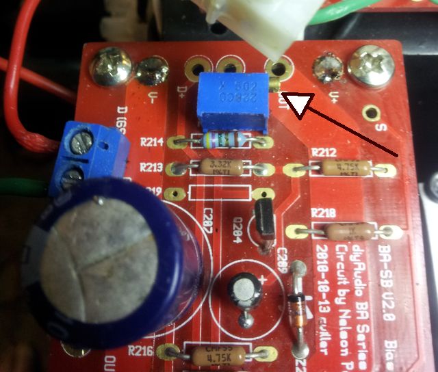

Shaky ground here. Full counter clock wise all the way to the click only reduces it to 3.2 V across the resistor.
Hesitant to try the other way and go higher than what I had. Does the trimmer appear to be in the correct orientation?
