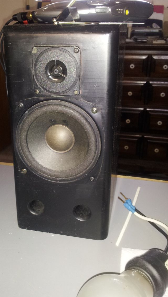

EDIT: I have $3 home brew bench speakers for all testing. But thanks for the warning.

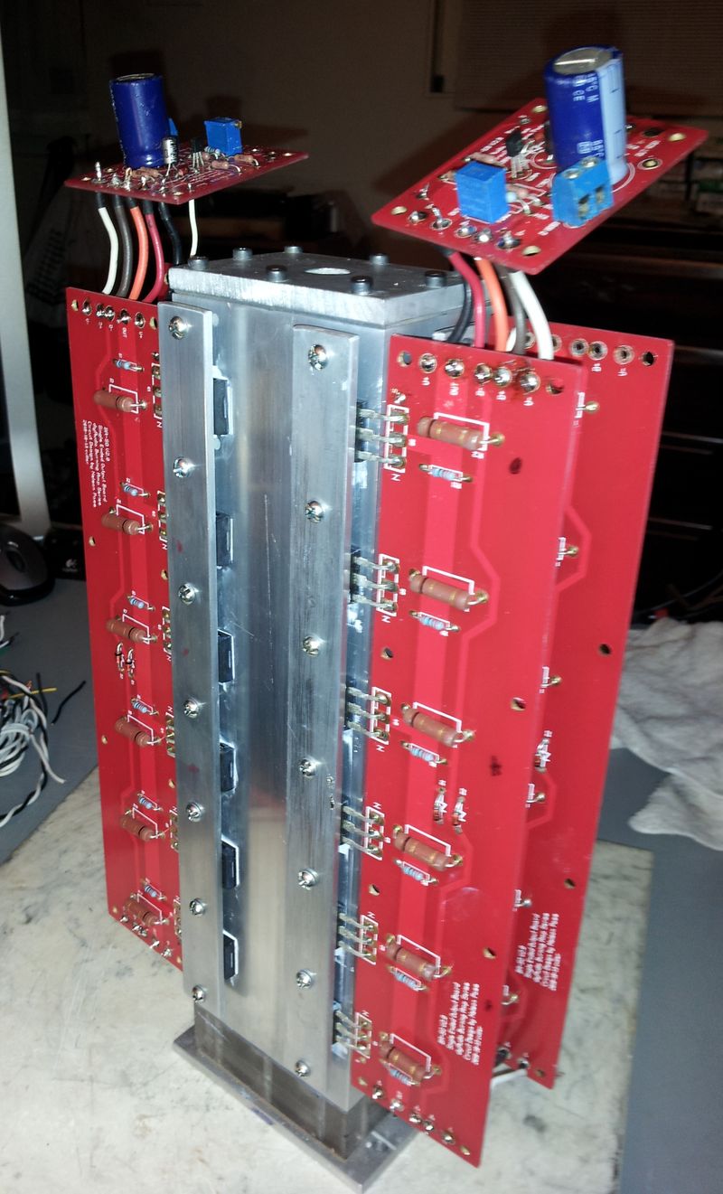

Don't know if this is the level you need, but this is what I have now and what worked fine for many weeks.
A reminder - the problems started when I took the amp apart for chassis work. At that time I decided to try all mica pads one last time. They failed and the output fets overheated. Power was applied for ~ 10 seconds. All the fets tested good off-board, but some damage may have occurred in other places.
And yes, I bit the bullet and ordered a set of red pads $$$ from the store.

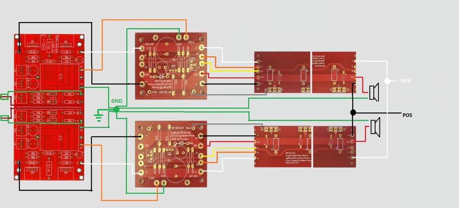

something is deeply wrong , using 3 mosfets , speaker and gnd !
from picture - you're missing half of output stage , per channel
Zen - not really... The diyAudio PCB have 3 output and 3 CCS per board, so if you want the 'full' 6/pair per channel you actually need 2 of the PCB and daisy-chain them together.
One PCB per channel will work, just half the total devices as in the schematic.
even better - that mistake is in my understanding of pictured
now I'm realizing that those most right pcbs are , in fact , double
My bad. I truncated the output boards for space on the diagram. Should have used a ziggy line. 🙂 Please see post #1559 for the actual layout.
"if you want the 'full' 6/pair per channel you actually need 2 of the PCB and daisy-chain them together."
That's the configuration I was using and will return to when these bugs are resolved.

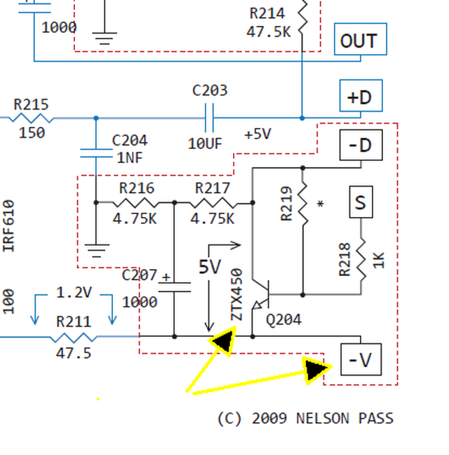

All's well in the kingdom again !. The culprit was a bad Q204 on the bias board. As reported, no mosfet to sink continuity showed up till that last wire (V-) was attached between the bias and output boards. The pic shows the link.

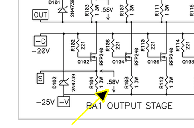

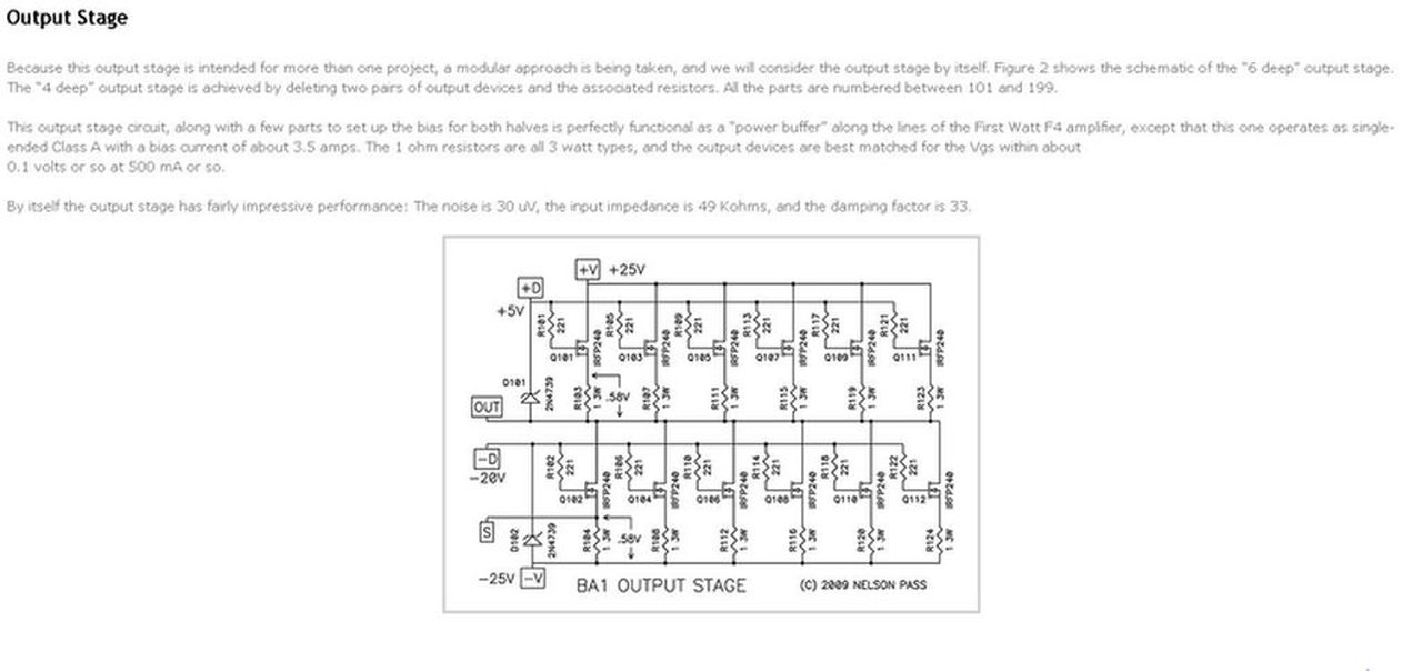

Also, after a loonngg phone conversation with Mr. 6 (who graciously schooled me by walking through all three schematics) the higher reading (.58 V) on the alternating mosfets is due to the output/CCS layout on the board. Had to go way back to the BA-1 article to see the SE schematic.
Both channels now respond properly (0.00 - 3+mV) to trimmer adjustments on the output mosfets. The second pair of output boards will be put back in this evening, and hopefully there will be more good news in the morning.

Another point of confusion were the multiple tips to find 0.2 mv somewhere on the output boards. A closer look at the schematic (BA-1 article) shows ALL the mosfets have a tie to a 0.58 bus on the SE board.
