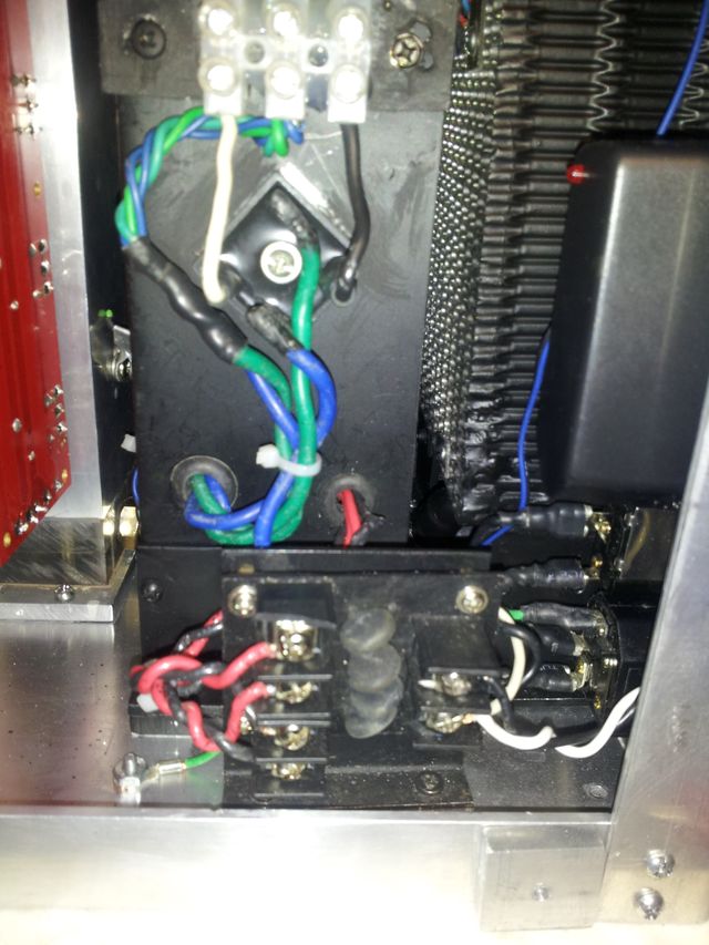

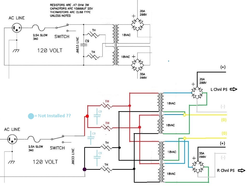

This build has been running without a C9 cap (ghosted blue). Instead of just asking where to place it (them), I drew out the circuit so any additional suggestion could be added. The CL-60s run very hot which I believe is normal, but not sure they are in the best location.
So how many C9s and where?
NTC needs to be hot , to drop resistance
greenhorn alert !: pull off mains cord!! , then touch NTC !
that way you'll burn just finger , not brain

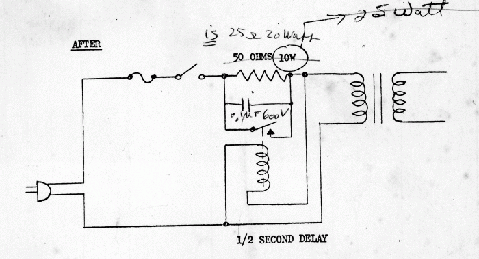

Fitting bypass relay contacts will get the temperatures down.
And prepare the NTCs for the next occasion they are required.
My fingers are just fine - thank you! As for the brain part, remember I lived through the "60s" so I'm working mostly with cinders there. 😀
My thought was the CL-60s should cool somewhat after the resistance falls, but they stay right up there. I won't fret about it.

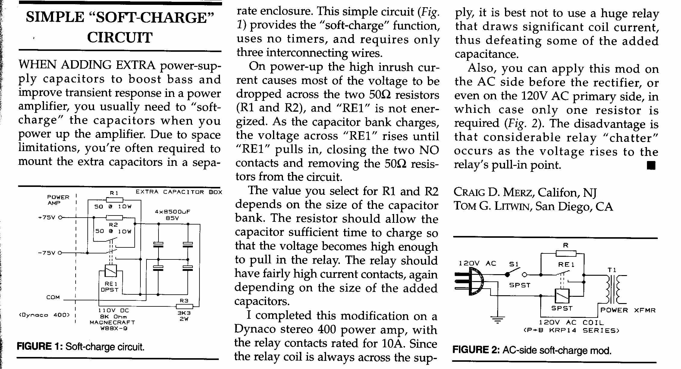

Andrew - your idea sounds slick, but I believe would require an additional power source - correct?

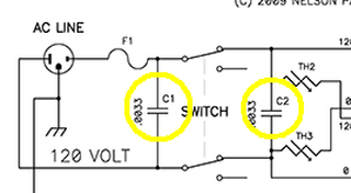

No mention of the C9 filtering. Does that imply it may be considered optional and required on noisy mains only? I see there are two in the BA-1 PS schematic:
"Capacitors C1 and C2 are line-rated types only, as they will be filtering AC line voltages."
Not if you use an AC relay. Look at the attached soft-start circuits.
