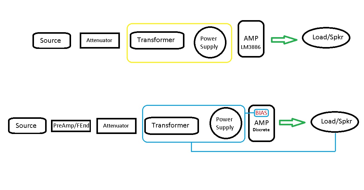

Lastly, I was stuck on Andrew's comment that stating the VA of a transformer was useless information. I drew out a super simplified diagram that might explain what caught me. Coming from my initial experience in the LM3886 world, the term "optimize" loosely refers to selecting a transformer/PS (yellow box) that allows the chip to operate at the manufacturer's maximum specs. Output is determined by the attenuation - and the speakers simply respond to those adjustments.
The discrete approach is much more deliberate and requires additional info/relationships/target (the blue stuff) for correct transformer selection. The specs of the speakers here have a higher active significance than in the "chip" example.
Am I getting any closer Andrew??

In the chip amp and AB amp for home use world, all you really need to do is provide a transformer that the voltage won't sag under load to reduce power available (although musical instrument amp manufacturers have been known to do that intentionally as a form of protection).
In class A, the transformer is operated at steady higher power than AB, so you need to understand what the VA rating means and how to derate the transformer for operating conditions. Most are rated at 25°C ambient into a resistive load. Put it in an enclosure at 45°C and you need to derate it. Operate into a capacitive input filter, derate again. So VA rating is not so much useless as incomplete information. You need to know more than just VA rating unless you want to use a rule of thumb and just use 3+ times the expected load.

In an attempt to clarify (and stop hogging the thread) - what I'm asking in this conversation :
All the information is useful, interesting and just plain fun. But I'm seeing two different approaches that may be circular.
1. Making adjustments to dial in on the best/highest bias the equipment I have is capable of sustaining.
2. Make adjustments that are keyed on the best match for a given set of speakers - i.e resistance and efficiency.
Those may well be a chicken or egg thing. 🙄
Another way of saying this - My Sunflower speakers are low efficiency. I have a set of MTMs that are higher and produce a stronger sound on the same amp. I perceive that adjusting some factors - such as bias - on the BA-3 can increase the output of the amp to bring the SPL of the SFs closer to the MTMs. If I do that, is it required or suggested that I also get a higher VA rated transformer to support the new bias? I have two 500VA in dual mono now. Is it reasonable to assume those have the capacity (headroom) to support higher BA-3 output? I'm not trying to blast a concert hall, but want all the components to be operating in a safe state at higher power.
I'm aware that adjusting the resistors on the output boards also influences the power of the amp, but I'm trying to get a better understanding of the sections in sequence - front end > bias boards > output boards.
