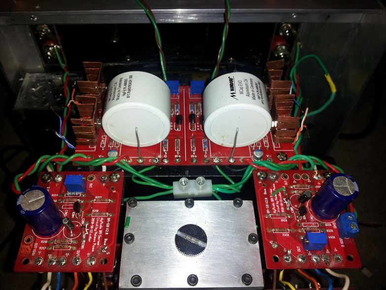

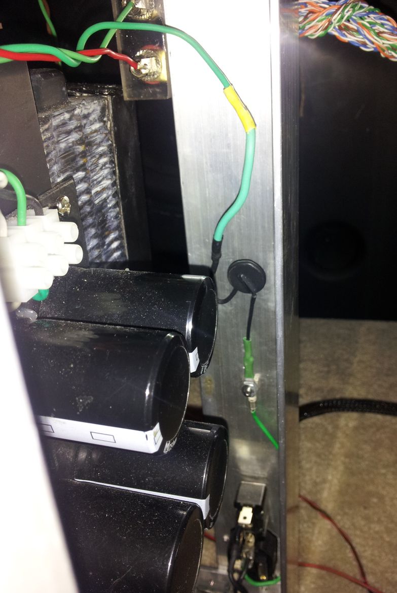

I agree, but I'm willing to try almost anything at this point. I'll be able to shorten the wires more than the picture implies by putting the star at the top of the transformer shield. Should be interesting.

Glad to help.
I spent many hours fighting hum. Turned out I had two problems: ground loops, and EMI being coupled into the amp from a dimmer switch that was radiating noise.
The star ground/CL60 isolation scheme fixed everything.
I can't take credit for inventing it though - many others have blazed those trails.
6L6 and Google got me on the right track.

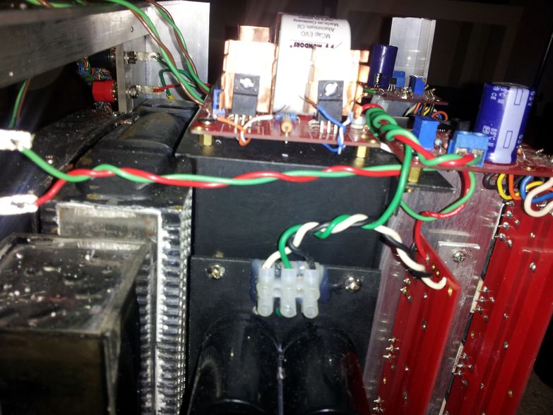

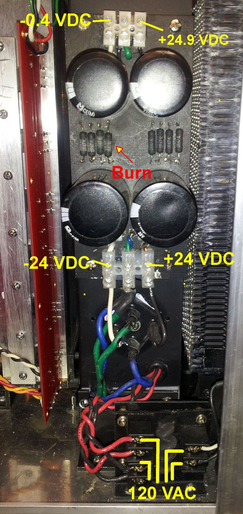

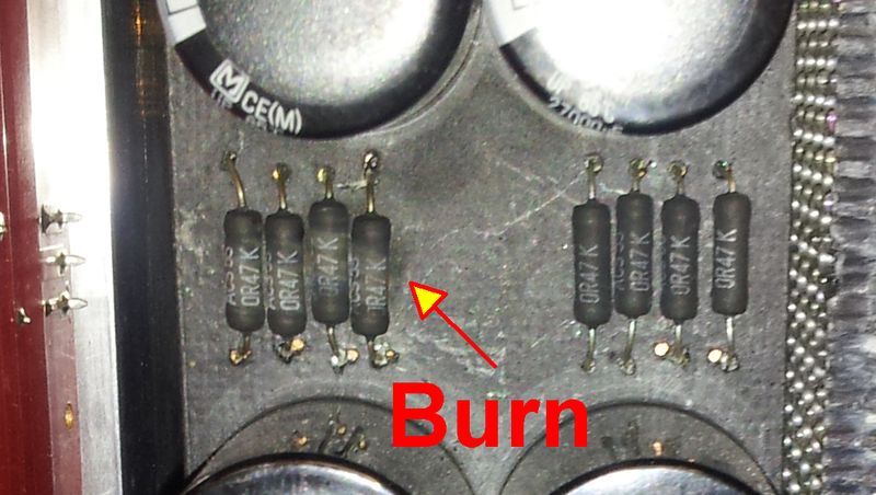

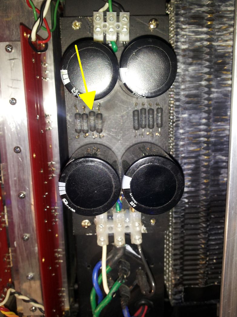

Well - Did you see the amazing disappearing post?? :D The hum was/is completely gone and that part was excellent. However, one of the resistors on one power supply got so hot it started to glow after ~ 4 minutes. Could well have been a short or bridge from the rework so I'm taking a good look now. I have a new set of resistors if needed as one or more on that side probably fused.
Back to the bench :bigeyes:

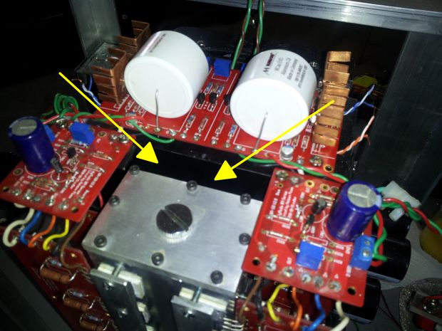

All is well in the kingdom again. Nothing was lost other than the resistors. The grounding scheme is still free of hum and the sound is full and undistorted. Three of the resistors show nothing for ohms or continuity. The fourth reads 14.7 Mohms (should be 47K) so it was probably about to fry also.
I found no major errors in the wiring other than some shabby soldering, :eek: but as I said the amp has functioned fine for months. There was one small loose blob of solder under the front end, but the gap between the top of the transformer cage and the bottom of the front end PCB is a full 1/4".
Does anyone have a suggestion on what could have pushed that much energy back or toward the PS resistors? It seems to me that something else should have died with that much of a fault.

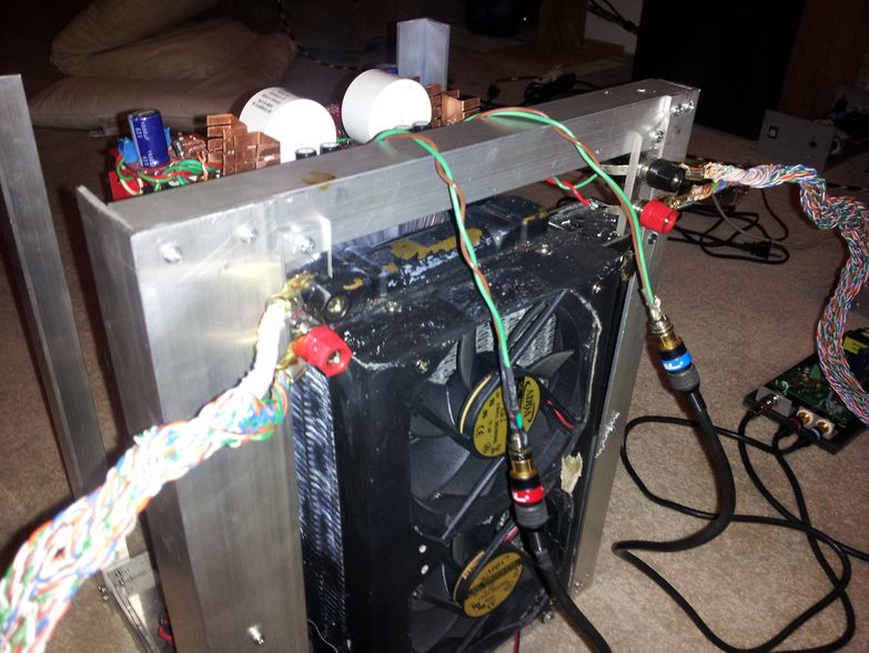

Not sure what is normal but I get this after ~ 50 minutes at 90% volume with the bench speakers:
Resistors (4 piece avg.)
R - = 45 C / R + = 39 C
L - = 44 C / L + = 44 C
Water Box = 32 C
Output Transistors = 29 C - 32 C
Ambient = 21 C
I'll hook the low efficiency Sunflower speakers up this afternoon to see if that makes any difference.

Just an observation. When dealing with power resistors I always space them up off of the board to allow for circulation. Mounting in close proximity to other hot running resistors or devices will derate them also. You can use simple ohm's law to calculate the power being dissipated in each resistor while in operation (I=E/R then P=I*E).
