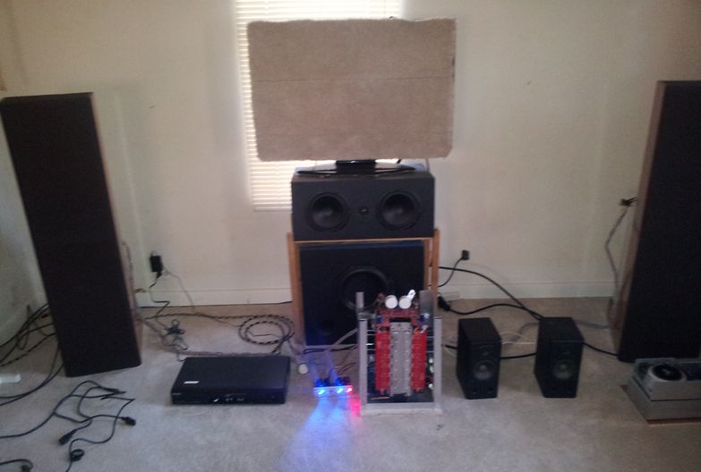

Wow! Big eye opener. For a standard I connected only a Sony DVP-NS400 through an Alps bare pot. The spec sheet does indeed say 2V (rms) @ 50 kilohoms with over 10 Kilohms Load impedance.
With the pot at max and reading at 9', the small home brew bench speakers read 79 db CWt/Avg. The Sunflowers read only 72 on the same CD. That's probably no where near what the Pass designs like.
My build is stock from the published (from the diyAudio store) BOM. The output is the SE version that I selected specifically for max heat output with the liquid cooling trials. It has a total of 24 devices on four boards.
The room is only 12' x 15' with 7' ceiling, but that may not be so important with the results discovered today. I'd like to avoid building another set of speakers (but will if necessary) if possible cause I like what I have when paired up with the MyRef Fremen Edition amps. They need attenuation only for loud. I don't think I could do this test (full pot) with those power amps without blowing or damaging the speakers.

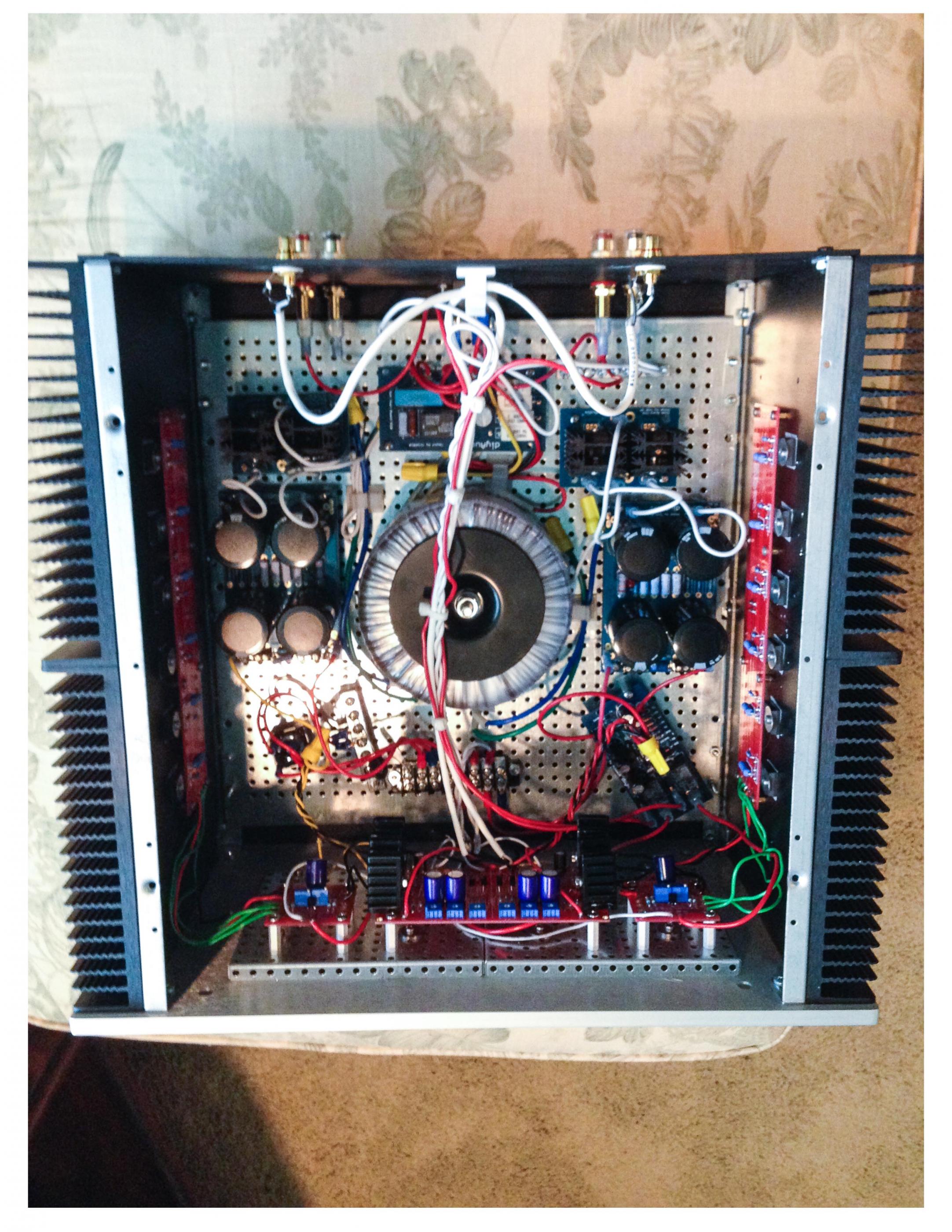

OK, I'm a newbie to Nelson Pass amps. Been doing tube amps for about 15 years and I'm an EE by trade, but over the years I've come to know what I don't know. I'm getting real close to out of my depth for a 6-deep SE output stage, but I have a couple more questions.

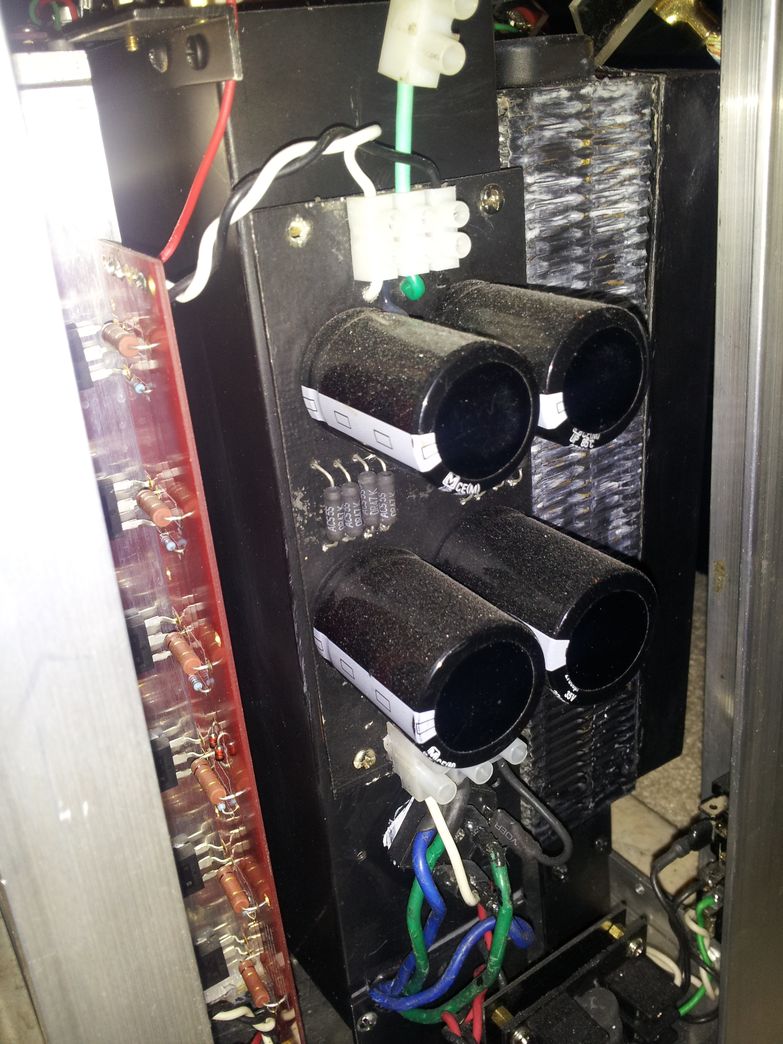

What is the VA rating of your power transformer? Who made it? Do you know how much peak current it can handle?
How much total capacitance are you using?
What is your rail voltage?
What bias point are you using for the output FETs?

Each side/channel has an Antek AN-5218
PS are 27,000 x 4 each side. They are producing ~ 21.2 VDC
The bias recommendation is what I think I'm seeking through these several posts.
