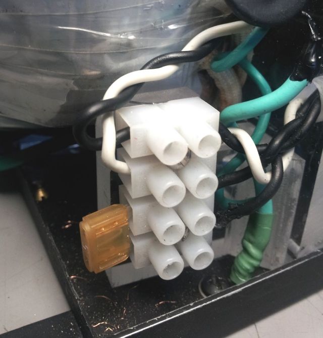

2 x 500VA means 1KVA
on your yank mains voltage that's max 1KVA/120Vac ........ around 8A
so , put either slo-mo 6A3 or ,even better, 8A fuse
btw - in that AC plastic thingie - one fuse is spare ( that one closer to you)
Oh! - Now I see.... never could figure out why the other one was always safe.
You could have saved me a couple trips to the hardware store had I known. 😉
I can't find anything bigger than 5A in my little town so I get some 8s from Mouser next week.
Edit: On a suggestion from Daniel W. I used an automotive type fuse in one build. Has anyone else tried and had success with something similar.
that means big bang ......... possible fire in the house
regular mains fuses are made either of glass or ceramic , with reason

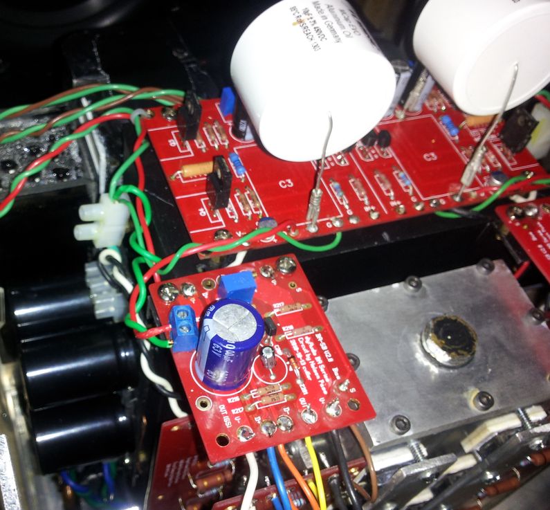

Remember, I'm not the one who spec'd 25V for C1 & C2. I'm just wondering where everyone else was, including N.P. with this. I would not really expect to see more than 6V on the 100 and the pot||cap together. You need about 1V on the source R, 2Volts Vgs add some signal and mabe thats 2 more volts, and a little more for when the drive gets tough. But it's a pre. So a 6.3V might work but I'm not goin there. A 10V at min and I think thats doable. My 16V caps are 12.5mm and they fit but my 25V caps are all 18mm!
FLG, what did you end up doing here. I'm having the same problem trying to finalise my BOM.
I want to run 30V rails, so I was figuring I needed 35V caps, but then the standard rails are 25V and the caps were specced at 25V (which if they were seeing full rail voltage doesn't leave any room for mains fluctuations)... I had a think about it and they are not directly across the power supply so probably aren't seeing the full rail voltage (anyone got a BA3 front + outputs end spice model?) or have done measurements as to what voltage these caps are actually seeing?
I'd like to run silmic II's or nichicon KZ's for C1 C2 but there is no way with 25V (or 35V!!) Panasonic FM's are looking like a candidate (for 35V as they are 12.5mm) as are panasonic FK's (10mm in a 35V) I just checked with a couple of 12.5mm diameter caps I have and they fit snuggly but anything bigger than that will be a forced fit. I thought it interesting that the Bias board has room for an 18mm cap (and my 25V silmics are only 16mm). Since the bias board cap will not see anywhere near 25V I find it interesting it is so big... was there thinking that you could use a higher capacitance device there?

thanks flg. I have some 1000uF 25V silmic II's and whlst they could be made to "fit" they are off at an angle. and not flush with the board. Was womdering if you ended up going with a lower voltage rating on the caps than the 25V specified in the bom.
I'll probably go with panasonic FM or FR. I've used rubicons in the past for small caps (I think ZA or ZL), they make some super low esr caps! and yes they are the manufacturer who used to make black gates 🙂

Thanks Andrew. Daniels suggestion was actually for speaker protection on the F5. I just went ahead and used them on the mains as an experiment. I'll stick with the glass type now that I've been informed.
I was able to find 6.3A (and 10A, no 8s) slo-blo at Radio Shack this morning and they have been holding in the BA-3 all day. Fingers crossed that I can stay "close rated" as you always recommend.
16V 470uF SilmicII 🙂thanks flg. I have some 1000uF 25V silmic II's and whlst they could be made to "fit" they are off at an angle. and not flush with the board. Was womdering if you ended up going with a lower voltage rating on the caps than the 25V specified in the bom.

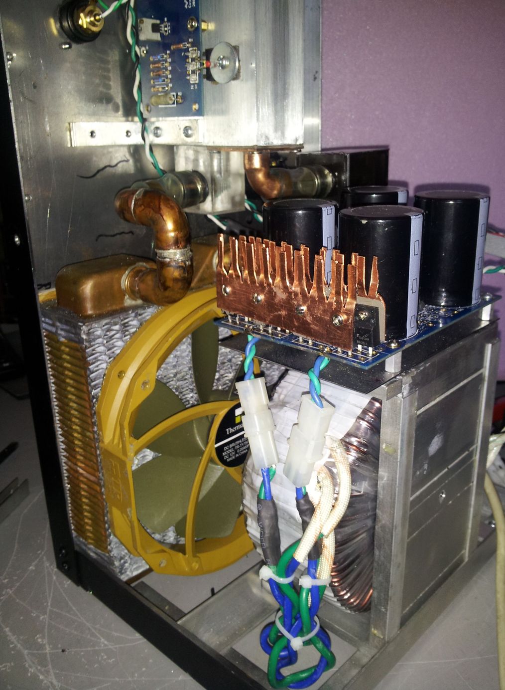

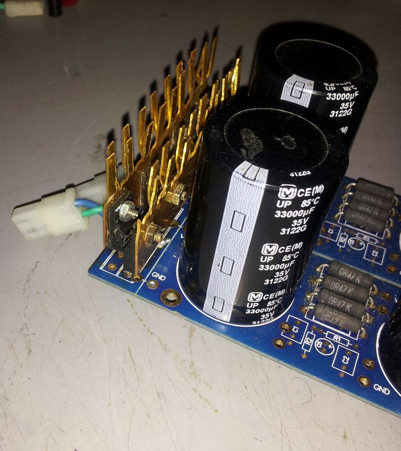

My plan is to do the same DIY fabrication as used on the F5 PS. It is made with 0.70 mm copper plate (4" X 10" @ $7) from the local hobby/craft store. Once I decide which cap will be used I can make the HS any shape and size needed.

Partsconnexion has a sale on Mundorf AGs so I thought I would try some of your 1000uF Elna Silmic II caps also. What voltage did you use?
They are 25v. You will have to bend the terminals to get them to stand upright on the pcb (see top of page) but I think it is worth it.
