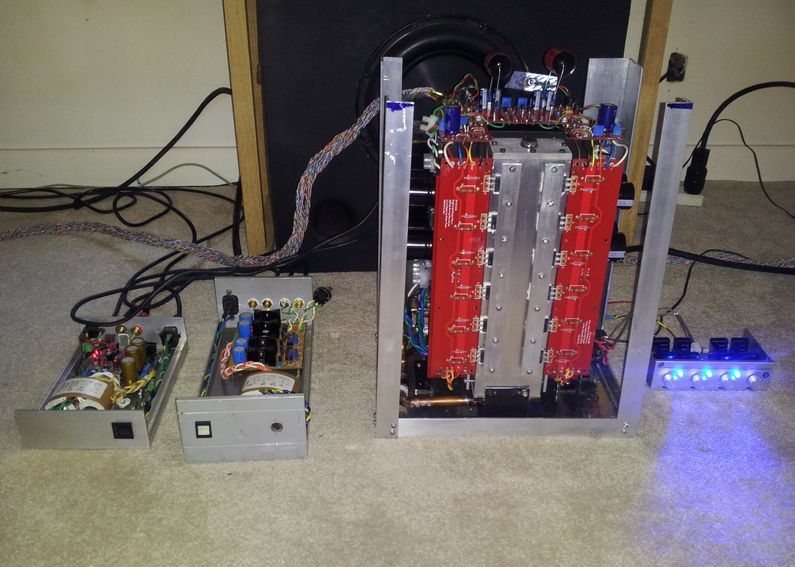

Just had a minor OOPS!
I blew a fuse - but it was after playing for several hours yesterday and about three hours this morning. The toroids are 500 VA/18 with CL-60s on all four primaries. The PS caps (four per side) are 27,000 uF/35 on a standard Pass layout. Have two 5A slo-blo fuses in this AC entry module. All this is feeding 24 output transistors.
So my question is whether to just increase the fuse value or should I be looking for a problem elsewhere? The amp is fine with a new fuse, but the long delay before burn-out has me concerned.
