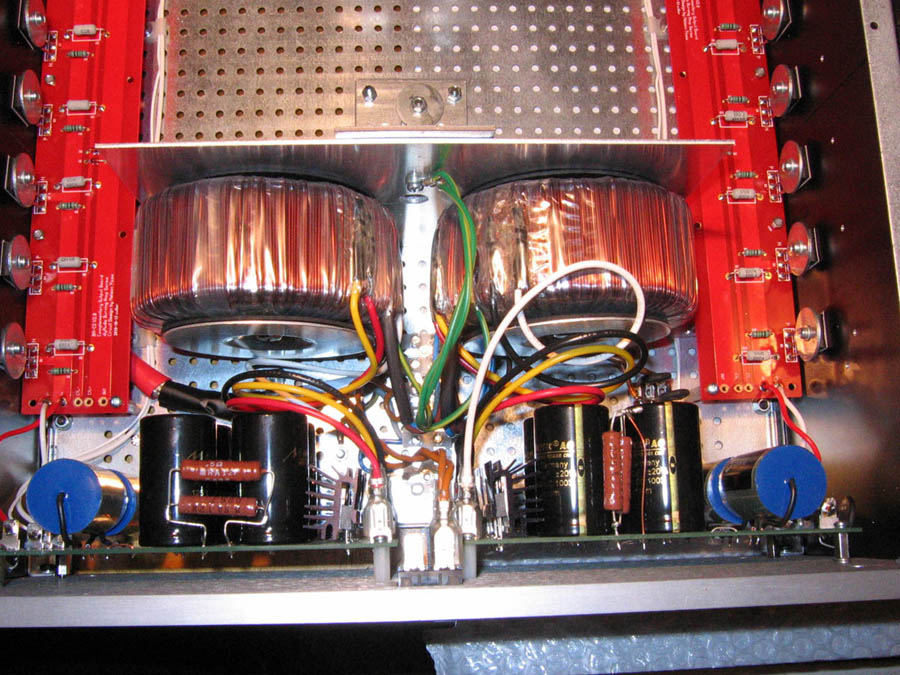

Your power supplies appear more complex than the Pass units. Can you give some details?
What are the large brown caps and why did you select them?
Are you using one bridge rectifier for both tranis? Just can't see a second.
Can't quite see where the speaker grounds are connected.

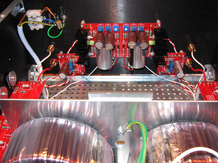

Power supplies are same as Nelson's design. I use boards from Avondale Audio over here in the UK. There is one each side. I have soldered a bank of 4 Schottky diodes (fitted with heatsinks) at one end which then feed into Nelson's CRC arrangement with a final 10uF 250V output cap made by Clarity. This gives the split rail supply so only one set of rectifying diodes per channel. The rest of the caps are 10,000uF Mundorfs. If you want the boards from Avondale unpopulated as I did you will have to phone them and in fact they may not do this size anymore but it is worth asking. They are mounted on the back of the front plate.
The large brown caps I think you are referring to are the 1000uF Elna Silmic II on the front ends. They don't quite fit the boards but they sound very good. They have an element of relaxed analogue about them without any loss of detail. Not sharp or brittle.
Speaker grounds are taken from the central pin on the power supply output boards (they are the white ones) and they pass to the upper speaker post. The other white ground is attached to the same output pin of the power supply and passes to the front end ground.
The central ground of the power supply is also connected to the earth ground via a CL60.

Elna Silmic CORRECT
The bridges are discrete, on the PSU PCB, under clip-on heatsinks. CORRECT
The bridge on the back panel is a ground-breaker. NO BRIDGE SORRY THAT IS WRONG
