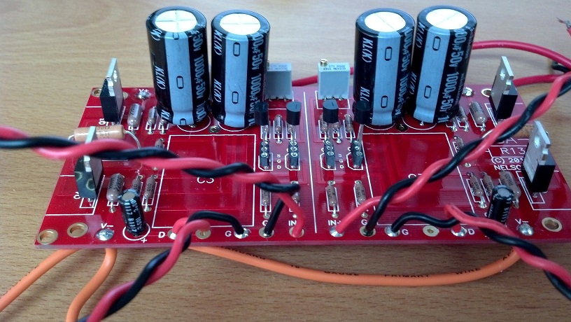

Need some help 🙁 I installed my F4 and biased it without any issues. I then installed my BA-3 front end and have not been able to bias it at all. No matter how many turns I make on P1 and P2 I get very little mV. I then then took my voltmeter and checked V- & G and get about 23V and the same for V+ and G, but I noticed that when I took those readings, I have -23V on the V+ and +23V on the V-.......I have wired V- on BA-3 FE to V- on universal power supply v3 and same for V+.....should this be reversed?
If you hooked up the BA-3 backwards, the fets are all likely fried.
However...
Did you just measure it backwards? Set DMM to DC volts, put your black lead on GND and measure +23 and -23 with the red.
However...
You definitely don't want to reverse the voltage polarity. The BA3 boards are correctly marked for +ve and -ve.
Check the mosfet positions. Looking at the BA3 board on the left (the side of the output cap) mine is marked Q4 (K2013) and on the right is marked Q3 (J313); I think there was a misprint somewhere that suggested they should be the other way round so that may be an issue. It was for me on my first build anyway.
The other issue is the Idss of the jfets. If they are low then you will find that nothing happens when you try to adjust P1 or P2 if they are rated at 500ohms. They would need to be 1k to do the job.
I got a feeling I overlooked the mosfets.....let me check that first. Thx 6L6 and Backbones - I hope I have not fried my fets.
I took measurements and they are correct polarities - dont know where I was measuring last night but obviously wrong and such a sigh of relief 🙂 Q3 and Q4 for both channels are correctly placed and so are Q1 and Q2.
Worth checking the Idss of Q1 and Q2. I had some marked BL but they read as GR. A lot of fakes out there. Anyway as I said, if they do have low Idss then you need P1 and P2 at 1k or you will twiddle until the cows come home and the mosfets won't bat an eyelid.
lol thats funny Backbones. My jfets I got from Spencer and all were 8mA. Looking at Nelson documentation he also indicated upping P1 and P2 if jfets were low but I don't recall him mentioning a specific value. On another thought I did not get Bournes pots which I should have because they have a clicking sound 🙂 I also am not quite sure which direction is min or max - will need to check with DMM, but if 8mA is low then I might as well get Bournes 1K pots now. If I dont plan to mess with P3, can I eliminate it all together?
I'm going to take my BA-3 out of the equation first and make sure my F4 is running. Not sure how much sound I will get with my DCB1 but its a process of elimination.
If you have 8mA then 500ohm should be fine. Set them to zero before firing up the amp. No, keep P3. You will be surprised the difference its setting makes to the sound. It's a marmite changer.
Good news is that my F4 is playing music, did not get to hear it much but its sounding very very nice. Could not hear its potential sadly...hence BA-3.
here is a pic of my BA-3 FE. Orange wires up front are V- and red wires in the rear for V+. I took the heatsinks off to remove it from the riser panel.
Where is that ground wire going that is twisted around the wire from D? It is going to star ground I assume.
Funny you mention that Backbones, I was just looking at it and realized that none of my ground wires were going to my power supply board. The ground for inputs is going to the input jack and currently the ground of "D" or output is going to the ground of the F4 input section but nothing going to my power supply board.
