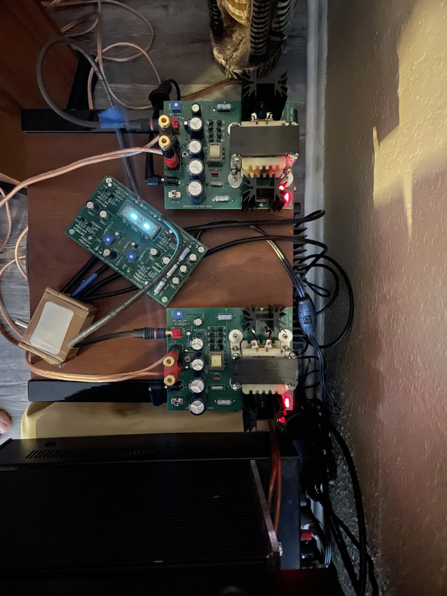

Just got the “autographed “ NuTube pre mocked up to the Zenductors (yes, it a brown box rk27 lol). Sounding great.
Only issue was the female end of the Wall wart supply connector not working. The parts fit fine, just no electrical connection.
Now, just need to source parts to display they awesomeness!
Kevin

That's odd. But those connectors are generally a pain in the rear. The centre pin comes in many diameters, so one must be careful to choose the correct connector for the chosen wall wart.Only issue was the female end of the Wall wart supply connector not working. The parts fit fine, just no electrical connection.

No kidding! I've stocked up on female 5.5Xxx fittings with pigtails to go from 2.1 to 2.5 (both ways). I have crammed small bits of aluminum foil in a 2.5 female to work with a 2.1 male, but that sounds a bit like begging for trouble.

It was the stock parts from the wall wart that didn’t work out of the box.
I didn’t think to use a bit of tin foil?!
But the trusty multi meter told me where the electrons got held up, and it was easy enough to fix.
My comment about the chinga dera not working was more for others that may have the same issue. I thought it was odd it didn’t work as well.

Now that I think about it, there are different barrel lengths as well. I learned that the hard way. It's truly remarkable how the world just keeps clinging on to crappy connectors. I feel the same about banana plugs.pigtails to go from 2.1 to 2.5 (both ways)
