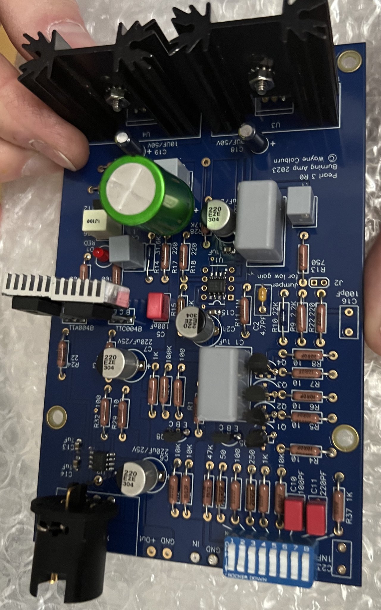

Hi Dennis, It looks like most of the part values and ratings are printed on the Pearl3 PCBs that Wayne so kindly distributed. I hope 6L6 doesn't mind me sharing but I managed to snap a picture of his completed board. As for the unobtainium low-noise ZTX BJTs that are specified, Wayne said ZTX550/450s or similar should work just fine. A schematic would be nice though, did anybody manage to snap a picture during the presentation? I only thought about it after the fact.

D'Oh! I didn't think to check since I don't have the boards with me. Thank you Olen.

I'm not Wayne Colburn of course, but I think that the ZTX857 (in stock at Newark, Farnell, and DigiKey) would work just fine as both the cascode amp and the tippy top ripple filter in the first stage of the Pearl 3. I also think the ZTX457 (in stock at Mouser) would work in those positions, too. But I'm not Wayne Colburn.

I snagged a pair of the Pearl 3 PCBs and would like to start gathering parts.

I think those are good suggestion to try. I also have some KSC1008 to try out when I get some time.I'm not Wayne Colburn of course, but I think that the ZTX857 (in stock at Newark, Farnell, and DigiKey) would work just fine as both the cascode amp and the tippy top ripple filter in the first stage of the Pearl 3. I also think the ZTX457 (in stock at Mouser) would work in those positions, too. But I'm not Wayne Colburn.

I have a year old Pearl 2 with fancy components and a very nice real panel with all kinds of knobs to adjust settings, no DIP switches. It also has a very upgraded power supply. I love the way it sounds. It has very low noise, which combined with a belt driven table. (*) is a truly quiet front end. It beats the upgraded phono section (teflon caps, Russkie tubes) of my vintage CJ PV9 by a wide margin on the bass and treble and noise.
So, now I'm planning for the Pearl 3... because, like ZM and NP et al... you guys don't stop and it's.... there.
What will be the improvement from the Pearl 2 to the 3?
Can we make the 3 so we can roll op amps with sockets? I looked at the pads in the circuit board ( yeah, I got a pair ) and it seems doable.
So, short of being able to roll op amps, what would be the main benefit to the 3 over the 2?

@tonyEE If you build Pearl 3 you’ll be smarter, better looking, more attractive, taller, have whiter teeth, more hair, a winning smile, and friends on all 7 continents. The advantages cannot be understated, it’s simply amazing and your entire life will benefit from it.
Or not. Who knows. 😎
You’ll just have to build, compare, and tell us all about it.
(Oh and yes, you can absolutely put a socket on the opamp.)
