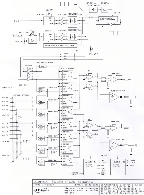

The TDA1541A DEM clock oscillator produces similar clock signal amplitudes, 5VPP signals may prevent correct DEM clock injection, and increase switching noise levels. I would at least put a 22 ... 100 Ohms damping resistor in series with the DEM clock signal.
You need to double the reclocker master clock frequency from 48 to 96 MHz. This could be done with a clock doubler (few gates), or by using a Tent 67.7376 MHz low jitter clock (exact multiple).
Since both BCK and master clock frequency are now doubled, the LRM should function correctly. You have to divide BCK by 16 in order to get the 352.8 KHz DEM clock.

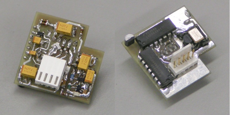

I implemented the DEM Clock. I understood that the attenuator (680/180) was here to give 1 Vrms pp. I tried to remove it and let only the 470 pF caps... This has effect on sound mainly louder bass and so more bodied sound. So the question was why 1 VRms should be used ?
I know fit a DIR9001 and is planning to use the last LRM as described here too. With the SAA7220, i will have BCK à 5.6448 MHz which is not at least a multiple of 48 Mhz... To keep the same ratio (x17) will I have to use some 96 Mhz Xo ?

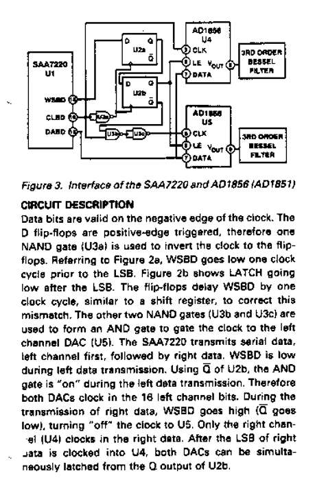

stopped-clock operation
Hi audiodesign,
Left channel output is latched on negative going edge of WS, (LL), right channel output is latched on the inverted WS signal (LR) > 74HC04, on the moment that WS goes high. If the WS signal frequency equals 44.1 KHz, period time equals 1 / 44,100 = 22.6uS. The time delay between positive and negative going edge of WS then equals 22.68 / 2 = 11.34uS.
I attached a schematic for stopped-clock operation (Analog Devices application note)
Hi audiodesign,
Why 11.34us ?

DI8M block diagram
Hi all,
I get a lot of questions through email about DI DAC operation. So I made a block diagram that shows how all major DI8M circuits are interconnected.
At the top is the UTOS2 digital audio receiver. It has a PCM2706 in bus powered mode that's connected to the DAC through high-speed opto-couplers. This blocks source noise and prevents ground loops. The PCM2706 runs on a separate 12 MHz crystal oscillator.
The CS8416 SPDIF receiver has galvanic insulation at both input (TOSLINK & coax / BNC), and output (high-speed opto-couplers). The unused interface is shut-down completely, either by computer power-down, pulling USB plug or by the SPDIF power supply switcher. Only the receiver that's operational, passes the I2S data (opto-couplers are open collector type). The receiver status LED indicates what interface is selected, and if the CS8416 is locked.
The timing signal (BCK) is reclocked in the shiftregister reclocker (LRM2), running at 96 MHz. The LRM2 blocks phase noise up to a few thousand pico-seconds. So digital audio source jitter is now irrelevant, and no longer affects sound quality. Jitter is now determined by the LRM2 only. This means that it's sufficient to provide bit-perfect data only.
Next The I2S signals enter I2S buffers (on the timing module). BCK drives the DEM clock divider to derive 352.8 KHz @ 2.8224 MHz BCK rate. Note that DAC1 gets non-inverted BCK, since both DATA and WS don't change on the negative going edge of BCK. DAC2 ... 8 get both WS and DATA from the delay circuit, since these delay circuits latch at the positive going edge of BCK, the DAC chips need to be triggered at the negative going edge of BCK (when both delayed DATA and WS are stable). That's why they get the inverted BCK signal.
The DAC chips receive (and latch their outputs) after 8BCK delays, so the sample will appear sequentially as illustrated in the timing diagram. In other words, the sample rate is multiplied by 8, giving 352.8 KHz sample rate (interpolated samples).
There are also two DAC groups, each containing 4 DAC chips, one group receives non-inverted data, the other inverted data. Note that each group outputs a partly interpolated signal. The combined full-scale current of each DAC group equals 16mA. Depending on DAC bit accuracy, bit resolution could be doubled by each doubling of the DAC chips, theoretically providing max. 19 bit resolution. This resolution is obtained by adding 8 * 16 bit full scale currents (4mA), then dividing them at the DAC output to obtain 2V RMS signal. Now if only one DAC chip would be operational, max. output voltage would be 2 / 8 = 250mV, but it would already have 16 bit resolution.
As more DAC chips add their output current, both output voltage and bit resolution will increase accordingly. Since DAC currents are added together, this process should provide monotocity within each DAC group. Errors could be introduced by tolerances in DAC full scale current, IV and diff amp stages. These errors can be minimized by tuning.
Each DAC group drives an OP-amp I/V converter (LM4562). In order to eliminate most of the typical OP-amp I/V "issues", the OP-amp outputs were isolated from capacitive loads, low noise components were used in the feedback loop, output was pulled into class A, and noise-gain manipulation was applied. Now we have 4 I/V outputs: IV(L), NIV(L), IV(R), and NIV(R). These I/V outputs contain DC offset voltages.
The diff amp completes interpolation by adding both IV and NIV signals, doubling the signal amplitude, cancelling DC offset and common interference. The output signal of this "semiconductor" diff amp is routed to a resistive output attenuator. Both IV and NIV outputs are also connected to a tube diff amp, it does basically the same as the semiconductor diff amp, but has no thermal memory distortion. This output is also routed to the resistive output attenuator, and added to the semiconductor diff amp signal. Both diff amps create a fairly neutral harmonics pattern that results in a transparent sound. So the tubediff amp is NOT added for the typical "tube" sound.
At the bottom of the diagram there is the DI8 power supply, it has a an integrated two-stage mains filter and can be set to both 115 or 230V operation. It feeds both the DI8 core, part of the UTOS2 module, and the LRM2. It also drives the tube status LEDs, these indicate when the tubes are operational. The DI8 power supply can be switched on / off by a 5V signal. The DI8M power supply also routes the mains voltage to the TUBEPS module.
The TUBEPS module provides the pre-stabilized 220V anode voltage, -12.6V filament supply (filaments in series), and -40V for the current sources. The filament current is limited, and slowly increases depending on filament temperature. If the filament voltage reaches a specified threshold, a FET supplies full power to the now pre-heated filaments. Next HV is switched-on, now the tube circuit smoothly settles to operating conditions.

I added a photograph of the LRM2, it's a new 96MHz shiftregister reclocker with clock doubler.
