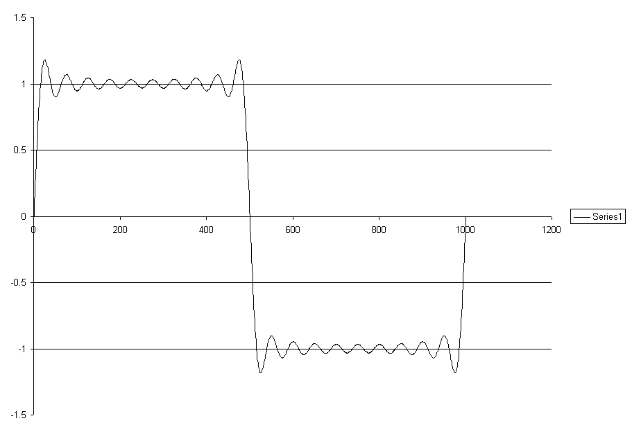

poobah said:This is what a 1 kHz squarewave looks like with frequency range limited to 20 khz.
Now... to get rid of that nasty ringing........................................................................ you have to ADD higher harmonics... beyond 20 kHz.

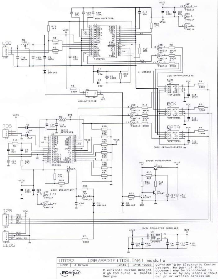

UTOS2 schematics
Hi ims,
I will try to attach the UTOS2 schematic first. diyAudio members can always email me for schematics.
It consists of a PCM2706 USB receiver and a CS8416 SPDIF receiver on one mall PCB.
The PCM2706 is bus powered (receives power from computer), and HPCL2630, dual high-speed opto-couplers are used for galvanic insulation. The opto-couplers are driven by 74HC14 buffers, and operate at low power levels. The opto-couplers support sample rates up to 96 KHz (CS8416).
The CS8416 I2S outputs also run through these opto-couplers (source selection). I use a small TOSLINK receiver module for SPDIF, but design is such that a high-quality pulse transformer can be added too (coax).
U3 (opto-coupler) signals the presence of the USB bus voltage and then swithes to USB automatically. The unused interface (USB or SPDIF) is powered down automatically, either by removing USB bus voltage, or the SPDIF power down circuit.
CS8416 receiver is straight-forward, it's runs in hardware mode, programmed to support I2S, 64BCK/WS, one's complement as required by the DI core. The required 3.3V is derived from a low-dropout voltage regulator.
The LED indicator signals the following:
USB (ON)
SPDIF (OFF)
No lock (flashing)
UTOS2 REQUIRES a reclocker, as opto-couplers increase jitter. So UTOS2 is followed by the completely redesigned local reclocker.
Due to the low jitter required (<2.7 ps RMS), I had to insert resistors of specific values in the clock distribution, and connect all IC shieldings to GND.
The IC shielding now also act as low impedance decoupling route, as I soldered a NPO / COG decoupling caps directly between the IC VCC pin and the copper shield. This also contributes to very low jitter levels.

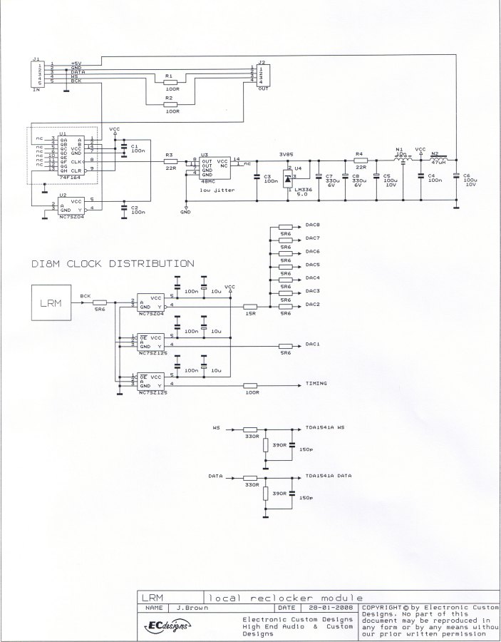

LRM schematics
Hi ims,
The DI8M / DI6(8*4), require very low jitter 1 / 352,800 / 2^19 / 2 = 2.7ps RMS.
so just connecting a PCM2706 or CS8416 receiver is NOT going to work. CS8416 clock jitter is specified at 200ps RMS typical, PCM2706 is even worse. So in order to achieve the required 2.7ps RMS, reclocking is always required.
The LRM reduces phase noise, but introduces some low amplitude correlated jitter in the process. Performance is similar to that of a synchronous reclocker.
The LRM schematics,
The low jitter 48 MHz master clock feeds the shift register through a 22R metal film resistor. The shift register is not reset like with the previous reclocker, but the output is inverted, and fed back to the second input. This results in a rotating bit pattern, fully synchronous with the master clock.
The master clock power supply is a shunt regulator (precision band-gap reference diode), programmed at 3.85V.
The module lay-out is extremely critical (HF), and required many redesigns to get a very low jitter amplitude with a jitter residual spectra that gives optimal sound quality.
BCK distribution was just as critical, by inserting resistors in the BCK signal path, jitter could be reduced at the both the TDA1541A clock inputs AND the master clock itself.
I also had to use special power supply bypassing on all ICs in the timing module. The copper shielding is now connected to the IC GND pin on one side, and a COG 100nF capacitor is connected between the IC power supply pin and the copper shield. The low impedance of the copper shield ensures short HF return paths.
