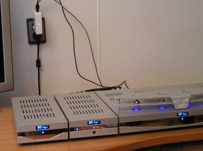

I tried a different approach, instead of going through extremes trying to achieve bit-perfect audio through the most logical "audio route", I used (wireless) network and a dedicated network audio device (similar to squeezebox). This bypasses the windows "audio route", by just sending plain data across a computer network.
I used an Apple airport express module, it connects through a (wireless) computer network, and has a fixed 44.1/16 bit-perfect output:
http://www.stereophile.com/digitalprocessors/505apple/
I added a photograph of the Apple airport express in action, I connected TOSLINK through a 3.5mm adapter, and used a wired network connection.
It works seamlessly with iTunes for windows. Direct comparisons between a 450 MHz IBM system running XP, and a 1.8 GHz iMac running mac OSX tiger, resulted in identical sound quality. It doesn't require any drivers, OS tweaks, or special software / computer hardware.
This basically illustrates the problem, every windows, hardware, software, driver, OS combination seems to produce different results (when playing back digital audio).
Bit perfect playback is as good as it gets.
Linux/Mac guys use these Operating Systems for very good reason. Reverting to windows = downgrading.

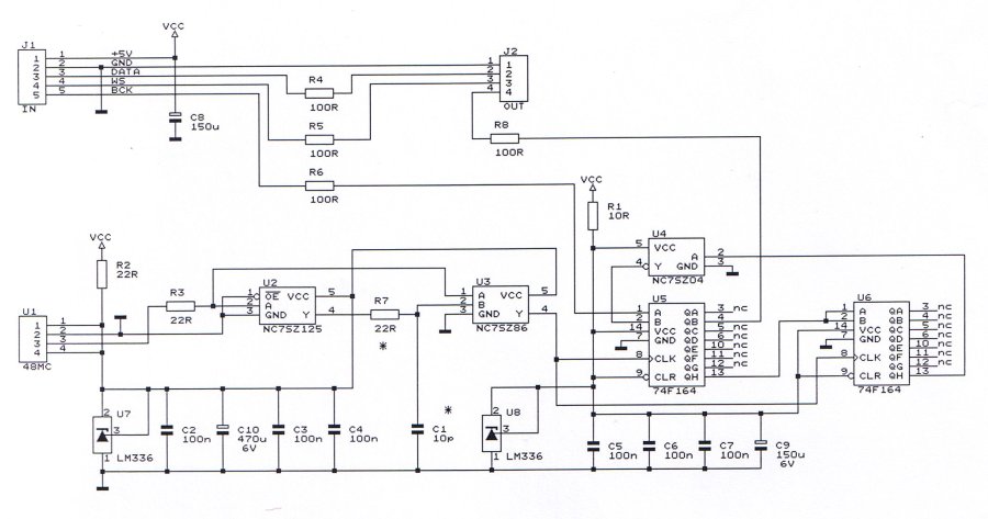

Hi ecdesigns,
i would like to see the LRM2 schematic or a brief description of the differences with LRM1 (Post #1839), only 2x (96MHz) clock or something else?
Andrea
Andrea
LRM2 schematics
Hi anbello,
I added the LRM2 schematic. The LRM2 uses a 48 MHz low jitter oscillator, just like the LRM1. However, a clock doubler (U2 + U3) is added to create a 96MHz low jitter clock. Due to the doubled reclock frequency, two 8-bit shift registers are required to enable locking to the 2.8224 MHz BCK input timing signal.
The series resistors in clock and I2S signals are required to reduce the effects of ground bounce, and result in lower jitter. Both R7 and C1 must be tuned to the PCB lay-out and gate propagation delays.
The LRM2 is a prototype currently being tested, and not a final design.
Clean power supplies are also important for best clock circuit performance. Battery power supplies work pretty well, but aren't very practical. I tested super regulators (6nV), but they simply couldn't beat the reference battery power supply. I used a switch to toggle between battery and mains power supply, so I could immediately hear the difference in sound quality during playback. I used 3* 1.5V alkaline batteries, and 4 * 1.2 NiMH rechargeable batteries (AA-size) for reference,
The mains power supply resulted in a slightly darker smeared sound. Battery power supplies result in a slightly "thinner", cleaner sound. This effect is probably caused by changed master clock jitter spectrum.
After lots of experimenting, I was just about to give-up on mains power supplies (for the reclocker) and was was planning to connect a rechargeable battery pack to the DI8M, but then I got an idea, a passive filter with back-up capacitors.
I used 10 ... 20mH ring core inductor and a Panasonic 0.1F (100,000uF) / 5.5V back-up capacitor. To my surprise this filter actually "outperformed" the battery reference supply. These filters are placed after each shunt regulator.

Well I agree that clean power supplies are very important for clocks but actually clean supplies are also important for every aspect of the audio chain.
If the chokes are added to EVERY other stage in your design and done one at a time, as well as getting a minor eureka with each stage you will probably notice a very big difference when the last "noisy" supply is replaced.
. . . for maximum effect you also have to replace cheap resistors in critical positions ( those in signal path or feedback path ) with good quality low noise types e.g. caddock TF020 or vishay bulk foil
All this may seem like a huge effort & expense but when it is all done I expect your ears & emotions will conclude it was worth it.
( This is assuming that you do not have cheap or electrolytic capacitors in the signal path. )
