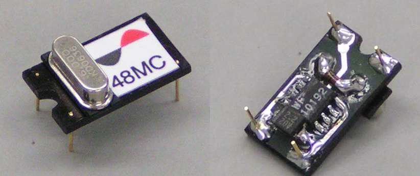

I now use a 48 MHz master clock oscillator based on a selected 16 MHz crystal and a WF10192. The 2.2 uF tantalium decoupling cap is soldered very close to the WF10192 power supply pins. The traces between crystal and the WF10192 are very short as well. There is a 2.7 K Ohm resistor in parallel with the crystal. The crystal oscillates on the third overtone.
The module only has a few parts and is quite easy to construct. I added a photograph of the module I experimented with, so soldering is very messy. The PCB is single sided.

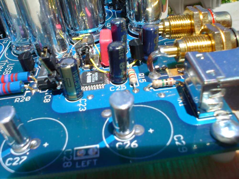

Included is a picture of how I implemented it. The clock beneath the stack of 4 SMD chips is the 48MHz clock with 1ps jitter. This used to be a 12MHz clock. I have at least a dozen DACs to modify. I will experiment with using two clocks (leaving the 12MHz clock alone) to see what affect that has. That would be a simpler mod then replacing the clock.

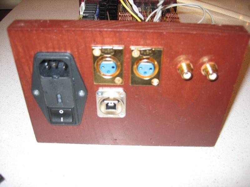

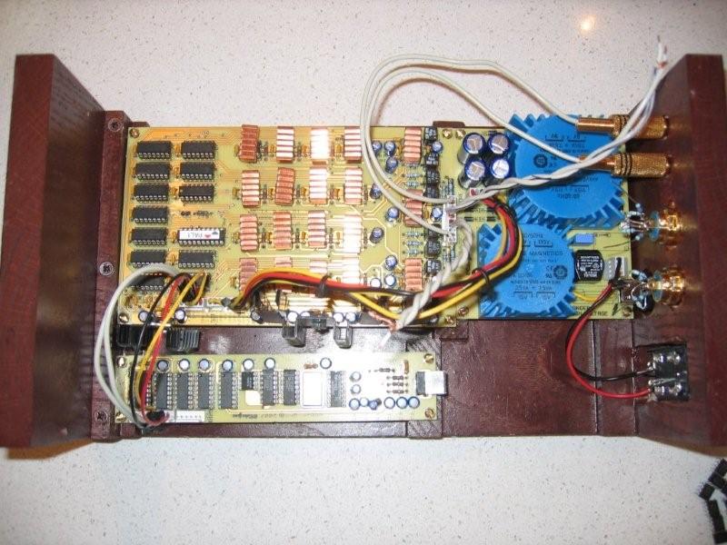

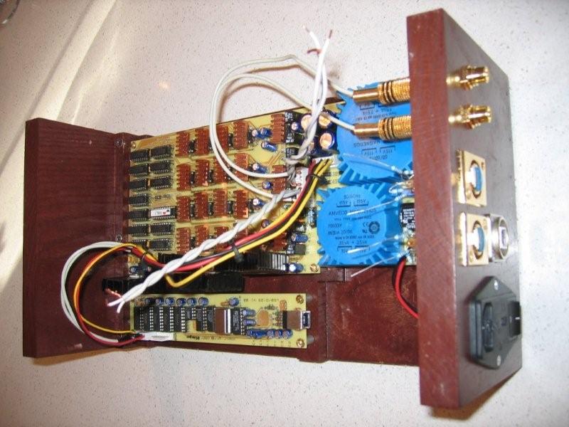

My (almost completed) DI16
Attached are some pictures of my almost completed DI-16.
I used a left over piece of oak I had to make the case, and plan to fold some perforated stainless steel over the top as a cover that will provide ventilation.
I haven't hooked up the balanced outputs yet.
I also need to hook up a small USB cable to the pass through USB connector before I can close it up.

I think that the jitter frequency components (the way the clock signal phase is modulated) have the biggest impact. If we take a perfect clock signal (square-wave) with zero jitter, all subsequent signal transients are perfectly time-aligned. When viewed on the oscilloscope, we should see a clear square-wave signal with very clean signal transients.
So I would say that it's most important to have as many clock signal transients time-aligned as possible. When a clock signal is phase modulated with noise, almost all signal transients take place with slightly different time intervals, and are by no means time-aligned. The clock signal shows hazy transients on the oscilloscope, the exact clock signal transients can no longer be determined.
With asynchronous reclocking, using two cascaded D-flip flops, we get two time displaced clock signal transients, both have the same brightness when viewed on the oscilloscope. So approx. 50% of the transients are time aligned in one "cluster" the other 50% in the second "cluster". Since the transients within a cluster are still perfectly aligned, both clock signal transients can still be determined accurately. Despite of the much higher time displacement, this clock signal will actually produce a sound quality that doesn't suggest high jitter is present.
The shiftregister reclocker is basically a digital one-shot circuit that generates a well defined pulse after each positive going edge of BCK. The pulsewidth is always exactly 7 masterclock pulses wide (BCK input = 2.8224 MHz / masterclock = 48 MHz). In order to maintain sync with the BCK input signal, the time between two subsequent fixed pulses may vary, but since both BCK and the masterclock are almost perfect multiples, there are few corrections needed. The shiftregister reclocker is also able to phase-lock to the BCK input signal, within the available time resolution.
The BCK output of the shiftregister reclocker looks like a single square-wave on the oscilloscope (unlike an asynchronous reclocked BCK signal). When the brightness is turned-up, a very dim second clock signal transient becomes visible, this is caused by the sporadic corrections needed to maintain perfect sync.
Hi Terry Demol,
2.8224MHz and 48MHz arent syncronous or integer multiples
so I don't quite understand how this can work properly.
I would imagine you will be generating sidebands and
running into DFF setup / timing issues.
I ran tests with both 48 and 47.9808 MHz, the oscilloscope shows very little difference between the BCK signal reclocked by either 48 or 47.9808 MHz.
The sound quality (sound depth, transparency, details, midrange and bass) I am getting with the DI 8M after the latest mods (Vishay bulk metal foil I/V resistors and 3.3mA bias current for the LM4562), show that jitter isn't causing any audible problems whatsoever.
More disturbing is the fact that sample amplitude ripple during the time the sample is output, causes similar problems as jitter. If you managed to get jitter values very low, you're only halfway.
The TDA1541A is one of the very few chips that have decoupling caps on the active current divider outputs. This enables the possibility to achieve a very low ripple signal on the current output. By increasing both DEM clock rate and decoupling capacitor values, the ripple voltage on the output can be reduced to very low levels.
