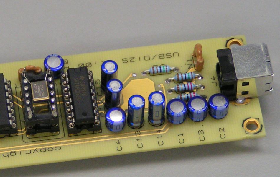

PCM2706 reclocked with two clocks
I am happy to report that reclocking the BCK line from the PCM2706/7 chip with a separate 48MHz clock works/sounds very nice.
This means it is very easy to add this reclocker to many existing DACs. For example no need to replace the 12 MHz clock and no need for the divide by 4 chip.
The 48 MHz shiftregister reclocker masterclock doesn't need to be synchronized to the PCM2706/7 12 MHz clock in order for the reclocker to function correctly. The 12 MHz crystal oscillator is only used for USB communications and has little or no effect on jitter. PCM2706/7 BCK / SCK clock signal is generated by a built-in SpAct (Sampling period Adaptive controlled tracking) PLL, similar to the circuit used in some SPDIF receivers.
However, I rather have one crystal oscillator than two that could intermodulate. With the DI 8M I get slightly better perceived sound quality when using just a single 48 MHz oscillator with a divide-by 4 circuit for the PCM2706.
The shiftregister reclocker can basically do the same with ALL I2S sources, so a jittery CS8412 I2S output can be reclocked in the same way.
Yes this is correct, another advantage of this reclocker is that standard 48 MHz low jitter (<1ps) / low cost crystal oscillator modules can be used, without the need for superclocks.
When the reclocker is placed close to the DAC chip(s), you have similar performance as with a slaved transport.

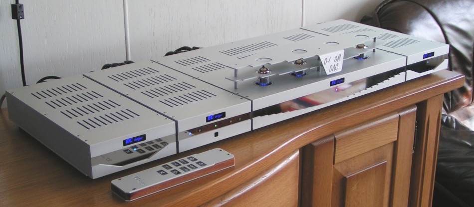

By the way, I (sort of) completed my new audio set, well you know how it is with diy projects, there is always room for improvement. I added a photograph of it. It consists of two 80W rms monoblock amplifiers (two outer modules), a passive volume and input selection unit (with remote control), and of course the DI 8M. The remote control housing consists of a piece of CNC machined teak wood and some anodized aluminum sheets. The keys are made of clear plastic with engraved symbols.

Sorry for the late reply, I plan to demonstrate my new audio set on HI-FI 2007 in Belgium next week:
http://hifishows.be/content-12.html
So I spend a lot of time boosting performance of my audio set. The modifications are now down to component level, most significant improvements were made this month. I will share these mods, as I think they are very important to achieve ultimate (DI DAC) performance.

The next spectacular mod was using a CTX315LVCT-ND (Digikey) 48 MHz SMD oscillator module with less than 1ps ! jitter. Needless to say what impact such extreme low jitter values have on sound quality. I used a rather unusual construction to reduce external resonances affecting oscillator performance.
I added a photograph of this mod. The DI 8M now performs like never before. My CD transports / changers have now become obsolete.
