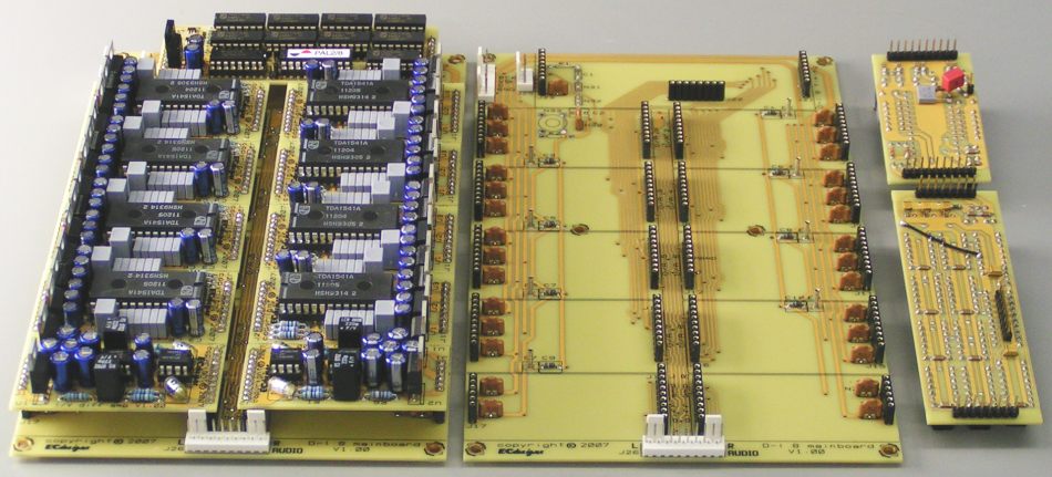

DI 8 DEM clock mod
Hi agent.5
Thanks for your reply [post #1565]
I need to reclock using the circuit (post #1522) on the eight 1541A modules, by applying an independent, external 352.8K HZ clock. Reclocking is not performed on the USBI2S module.
You don't need an external 352.8 KHz clock. The DEM clock signal is provided by the DI 8 timing module. All it takes is using Q2 instead of Q3 on the 74HC161 synchronous divider.
Using the 352.8 KHz DEM clock on the existing DI 8(M) only require some minor modifications. The DEM clock is derived from BCK, so (slightly) different BCK clock frequencies also result in a different DEM clock frequency. In other words, the DEM clock is "locked" to BCK.
I tested both 44.1 and 48 KHz sample rates, and the DEM clock circuit works fine with both. 48 KHz sample rate (64BCK / WS) results in 3.072 MHz BCK, divided by 8 gives a 384 KHz DEM clock.
It's important to have both BCK and the derived DEM clock running in phase, this is guaranteed by a fixed division factor and a fully synchronous divider.
DI8TIMP module modification:
Interrupt the PCB trace that is routed to the DI 8 timing-chain module DEM clock output and Q3 of the divider 74HC161. Then make a connection between the DEM clock output and Q2 of the divider 74HC161
DI8MAIN module modification:
N33, R2 and C2 are not placed. Wire bridges are placed on locations R1, C1, N31, and N32. The eight 470pF caps are replaced by small 680 Ohm 0.4W resistors, these match the 5.08mm pitch of the 470pF caps.
DA1541A module modification:
Interrupt the PCB trace between TDA1541A pin 16 and the external DEM clock connection, solder a 180 Ohm SMD resistor between AGND and the external DEM clock connection, and solder the removed 470pF cap between TDA1541A pin 16 and the external DEM clock pin. Solder a 100nF decoupling between TDA1541A pin 17 and AGND. Connections between DEM clock circuit and TDA1541A need to be as short as possible.
This mod was made on all eight DA1541A modules.
When all modules are placed on the DI 8 mainboard, the mods are not visible.
I added a photograph to illustrate this mod.
