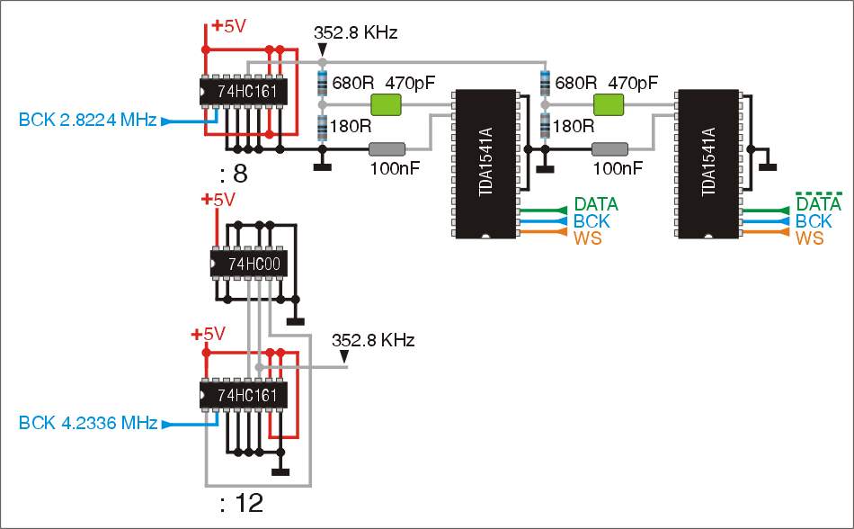

352.8 KHz DEM clock schematics
Hi all,
I mentioned the new 352.8 KHz DEM clock circuit a number of times now,
Here it is, I attached a diagram of the 352.8 KHz DEM clock I currently use.
Depending on BCK frequency, BCK needs to be divided by a specific factor in order to get 352.8 KHz. When BCK equals 2.8224 MHz, a divide by 8 counter is needed, with other BCK frequencies the division factor needs to be adapted.
2.1168 MHz > divide by 6
2.8224 MHz > divide by 8
4.2336 MHz > divide by 12
5.6448 MHz > divide by 16
11.2896 MHz > divide by 32
Division factors like 6 and 12 can be obtained by resetting the synchronous counter, depending on a specific counter output code. Division factors like 32 can be obtained by cascading synchronous counters. This is achieved by connecting the clock inputs (pin 2) together, and connecting the TC output of the first counter (pin 15) to both CEP (pin 7) and CET (pin 10) of the second one.
When using a synchronous counter with asynchronous reset like the 74HC161, a divide by twelve counter can be constructed by resetting the counter at output code 1100 (12). This will produce an asymetrical output signal. To correct this a divide by 6 counter can be constructed (reset code 0110), followed by a synchronous divide by 2 counter.
When using synchronous counters with synchronous reset like 74HC163, the same divide by 12 counter can be constructed by resetting the counter at output code 1011 (11) as the synchronous reset causes a 1 clock delay.
Resetting is done by using a NAND gate like the 74HC00 (dual input), 74HC10 (triple input) or 74HC20 (quad input) between outputs and the 74HC161 / 74HC163 reset (pin1). The "1" represented in the counter output code should be connected to the NAND gate inputs. So an output code of 1011 (11) would require 3 inputs (74HC10).
Don't use asynchronous ripple counters like the 74HCT4040, these will introduce unwanted delays that in turn cause inter modulations.
If multiple DAC chips are used, a common synchronous divider is used for all chips. Each chip needs a separate attenuator (680R / 180R), timing cap (470pF) connected to pin 16 and decoupling cap (100nF) connected to pin 17, this is also illustrated in the diagram

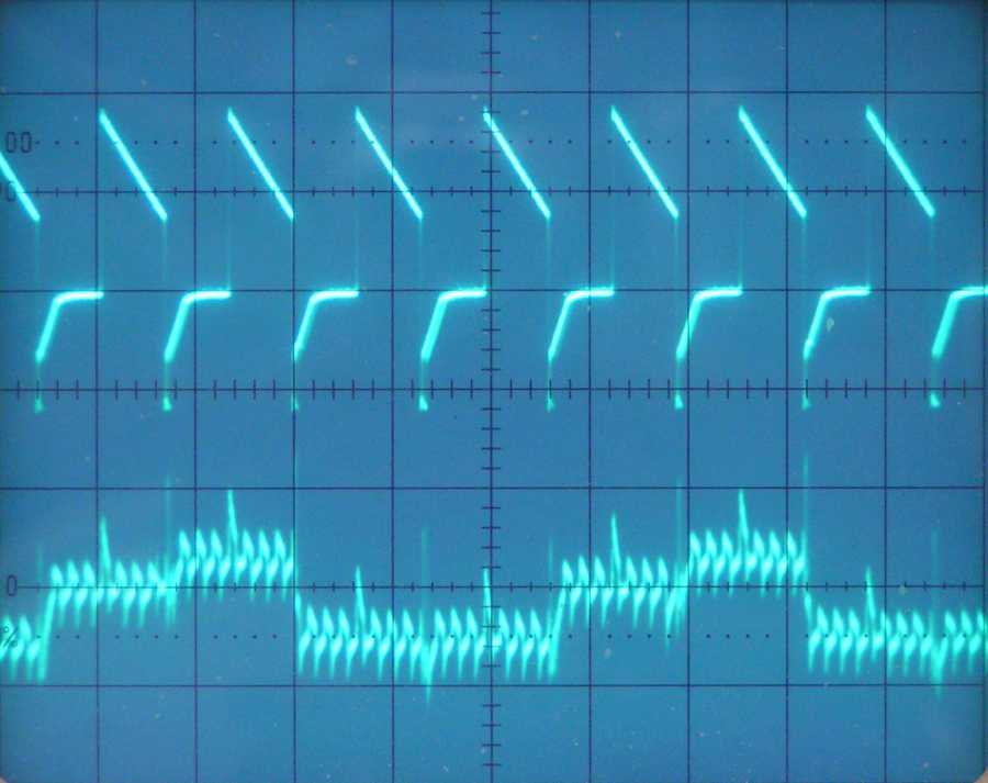

DEM clock and active divider output oscillogram
Hi tubee,
Thanks for your reply
Nice to hear you got better results now. I added an oscillogram I made today. Upper trace is the DEM clock (352.8 KHz), measured at pin 16. The sawtooth shaped ramp is generated by the 470pF timing cap and the DEM clock oscillator internal constant current source.
The lower trace is one of the 14 active divider outputs (100nF decoupling cap temporarily removed). It's clear to see that the step value changes synchronous with the DEM clock signal. This way correct DEM clock injection can be verified. Also visible is BCK crosstalk, this signal also shows that HF components need to be attenuated by the decoupling caps, so these caps should have low inductance.
We are looking at one (of the 4) outputs of the active current divider. Two passive current divider are closely matched on this particular output, the other two have tolerances.
One active divider output is switched sequentially between the 4 outputs of the preceding passive current divider. Since the output currents of these passive dividers have certain tolerances, it reflects in a unique step shaped ripple current at the active divider output. Every time the pattern is repeated, a full DEM clock cycle has been completed. It's clear to see it takes 4 DEM clock pulses to complete one full cycle.
The active divider is toggled on the negative going edge of the DEM clock.
By connecting a (100nF) decoupling cap to the active divider current output, the current ripple is averaged, resulting in a very accurate averaged DC current. The same happens with the other 4 active divider outputs. The idea is to get 4 exactly identical output currents, despite the tolerances in the passive divider. The TDA1541A has 3 of these active dividers (with each 4 outputs) for each channel. They correct the 6 MSBs.
The other 10 bits are generated by passive dividers, based on emitter scaling. They consist of 1024 darlington transistors.
The analog output signal is obtained by connecting combinations of the binary weighted currents to the DAC output by means of bit switches.

I hear no artefacts now with this version, it seems music plays some slower now with it, i find that always a good sign. Soundstage is deeper.
Treble is still some sharp.(I have a new main speaker design in my head and should start building it. The planned tweeter could be much sweeter on the ear i suppose (B&G Neo 3) The now used Focal has a rising curve to 20k.)
Looked with scope at some waves: the 11Mhz masterclock (Kwak 7) it has not a squarewave anymore, but looks more like a sine, and is only 1,4V. When i fitted the clock it was square for sure. From the dividers they show allmost square and 2,5V.
scope on pin 16: Looks like a combination of your two traces: (sorry no dig. camera):
*The falling/rising edge is pinsharp now.
*The horizontal plateau is not really visible on scope here, but has a rising concave shaped curve. I hope it's not a problem.
*The sawtooth ramp has sharp spikes on them (with your upper dem trace it is a faint thicker line) and BCK remains are visible on the ramps (counted seven/ramp) I thought they where from the current divider caps, but indeed they are BCK remains because it is a divided frequency.
I removed the six pair 100N MKT's and one pair 0.47uF for MSB, replaced them by your advised value's. Took simple and cheap yellow MKT's 63V, no name, but shows an oblique "T" before value marking.
The 0.22uF's are blue MKT's (siemens?) like:

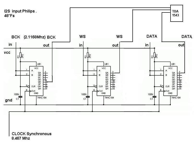

since this is the thread of the "timing" for excellence , why not fly a little off topic ( but not too much ) for a while .
I was interested and curious finding the information on this site RETRO AUDIO DAC (look at "the problem" section ) about the timing between the channels L and R of the audio samples .
Is someonelse aware of the fact that in the data stream the left sample arrive before the right sample ? And moreover is it a reliable information that on the " recording side" the 2 channels are made at the same time ?
Well , I tried that on a 48*Fs system , with 3* 74HC164 and one TDA1543 per channel .
The results are interesting.....
One TDA1543 has the DATA shifted of 24 BCK and inverting its WS is just like shifting it of 24 BCK . So one TDA1543 works normally but has its outputs shifted ( delayed ) in the time domain.
The other TDA has the original DATA stram , but its WS is inverted ( delayed-shifted by 24 BCK )
So taking the audio output at both L pins of the TDA1543 offers the stereo set where the L sample is delayed of 24 BCK and the R sample is transferred to the DAC at the same time of its forerunner .
Does someone else tried this ? What are your impressions?Does it make sense for you?

Sorry but I don't get it.
Being a serial bus some data has to come first and some after ;-)
The receiver (i.e. DAC) has some internal registers (memory) to store the word to be converted and then both conversions (L-R) should start at the same time, so it shouldn't matter at all which channel data comes first.
Or am I missing something?

Ciao Andrea , what about 2 mono dacs ??Andypairo said:Sorry but I don't get it.

Ok inverting WS enable the dac to store the sample for the channel desired
In the listening things seems to be different anyway .
sometimes its all about experimenting
I know it sound absurd and nuts a little 😀
inverting WS in a tda1543 has the effect of splitting the channels ( R go to L and L go to R ) but are they the same 2 samples in the time domain ? ( for what that may interest ? )

The RETRO DAC schematics show a AD1865 application that uses each DAC to construct a balanced output. DAC1 generates L + NL, DAC2 generates R + NR.
By using WS and NWS to latch the DAC chips, a delay between both L and R channels occurs. At NOS mode (44.1 KHz) this delay is half the period time or 1/44100/2 = 11.33 uS.
By delaying data for one channel, or by using so called clock stopping (freezing one channel clock input until the other channel has received all data), both L and R samples can be time-aligned again.
Since timing between both L and R channels is critical in obtaining correct spatial information, it makes sence to prevent delays between both channels.
First of all, the TDA1541A / TDA1543 latch the data automatically on the first positive going edge of BCK after WS has gone low. Internal registers / latches are used to ensure that both samples occur at the DAC output simultaneously.
Your circuit is similar to taking the left signal from the left output of DAC nr. 1 and the right channel from the right output of DAC nr. 2. Your example might have the advantage that the same circuits are used on each DAC chip (only the left channel).
About your example:
TDA1541A nr. 1, delay 24BCK inverting WS, L output = L-1, R output = R-1
TDA1541A nr. 2, inverting WS, L output = R-1, R output = L
Now when taking stereo information from both L channels it results in
L output TDA1541A nr. 1 = L-1
L output TDA1541A nr. 2 = R-1
BCK would become problematic, DAC nr. 1 would receive delayed data that changes on the positive going edge of BCK (otherwise the data couldn't be sampled by the shiftregister). DAC nr. 1 needs to receive NBCK in order to sample correctly
DAC chip nr. 2 would receive normal data, so it needs BCK.
So the correct L + R data is output, and is time aligned (because both WS signals are inverted), but they do have a small time delay of 1/BCK/2.
Since both chips process / generate L + R channels as indicated, crosstalk between both channels is still present in both TDA1541A chips so the circuit isn't optimal.
It's better to change the circuit so one chip would receive L + NL or L + L, and the other receives R + NR or R + R. This way crosstalk could be reduced, and output current is doubled.

Well in my tests I forget to invert BCK for the shifted channel , infact that is why the difference in the stereo imagine was so big and the channel wanst reproduced correctly .
If you are able to produce a schematic for 48Fs system that ebable one TDA to rerpoduce L and - L ( or L+L ) and the other R and -R( or R+R ) I would be grateful .
