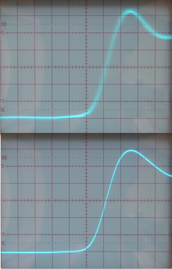

I hope your comments on "huge" differences are based on comparing the two designs life and not based on trying to elevate your kits compared to my humble design based on paper study ?
My aim is "live" sound quality, not elevate kits. The differences I mention are based on both measurements and listening tests. I shared a lot of information and research results on this thread for almost a year now, that document the design / optimation process step by step. By carefully studying this information, it must become clear why certain improvements resulted in better performance and why.
Paper studies are fine, but sometimes it requires an entirely different approach in order to get real improvements.
I am not going to explain why I think USBDI2S has better performance, I just added oscillograms of BCK using the standard TI PCM2706 application (upper oscillogram), and the same BCK signal after the shiftregister reclocker (lower oscillogram). Then consider that I continued to optimize the USBDI2S interface, after these pictures were taken.
I would like to call for some more prudence on cracking my designs on expected audible outcome. You would be adding yourself to a line of people who judge the dddac on paper and drawing conclusions on expected measurements they never did, not to mention, never listened to it. Which is strange, as I very much like your approach of combining pure technic with intense listening sessions.
It was not my intention cracking your designs, and if it appeared as such, I apoligize for this. You make great audio kits, and this is confirmed by the feedback of many people who built them. I have respect for people who design products like these.
May be your comment on "huge" is just the way you express yourself.... I remember you talking about your earlier design sounded like a "transistor radio", which was hard to believe too 🙂 But not everyone would understand it in this way.
I use the term "huge" in a relative sense. Small improvements can result in a very clearly improvement in sound quality, I might call this huge in order to express the significance of this improvement in comparison with other (previous) improvements. I sometimes get too enthusiastic, like with the transistor radio incident, it was just a way to express how I perceived the audible improvement at that time.
If the USB module would be that bad and jittery as you suggest and as you conclude therefore must be effecting negatively the sound, it would not be so much better compared to the best SPDIF like implementations, I have heard my self (and many others)
Jitter consists of specific frequency components, and these frequency components together have a certain average amplitude. The more different frequencies present, the worse it gets, so it's not just the jitter amplitude degrading sound quality, it's also the contained frequency components.
Jitter is only one of the many factors that degrade sound quality, and the sum of all these factors determine how an audio set sounds. One factor could attenuate or increase another. You can't pick-out one single component, without tuning it to the rest of the audio set. Basically optimizing a DAC, includes optimizing the interface that drives it, and all that's connected to the DAC, interlinks, amplifiers, and speakers. This is why I suggested trying to use the USBDI2S module, as it forms a unity with the DI DACs.

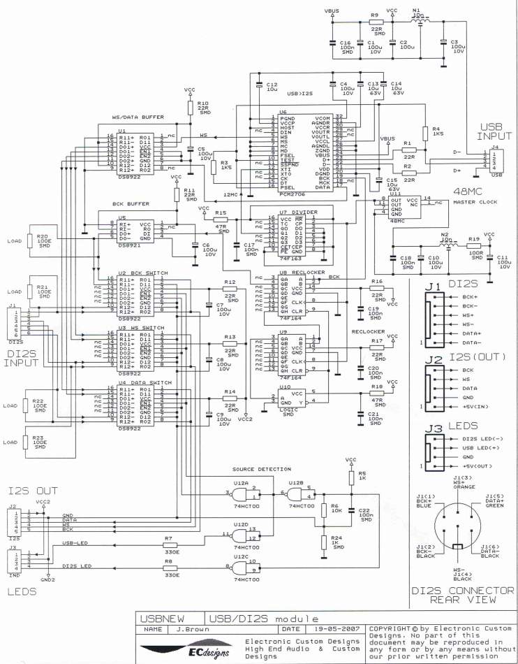

USBDI2S schematics

The schematic in post #1024 is only an early prototype, the new USBDI2S module is much more refined, it has extensive power supply decoupling down to chip level. There is an autodetecting input source selection, and the decoupling capacitor values are changed. It has split power supplies and an on-board DI2S transceiver between USB interface and I2S output.
The tweaked version in the DI 8M has even more extensive power supply decoupling, a 330uF tantalium capacitor for master clock decoupling. I also applied some trace capacity compensations. It also has a discrete low jitter master clock oscillator module.
The PCB traces are fully gold plated, this also improves HF performance. I had to re-design the PCB many times before I got optimal HF performance and minimal crosstalk / lowest jitter, it's all quite critical.
I added the schematic diagram that comes with the kits.
