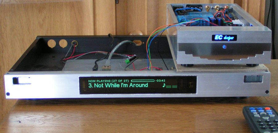

Hi ECdesigns
Instead of "relaxed" I should have written "slower", but you' re wright about the long interconnects. I don't have USB cable longer than 2m
I consider making an fanless audio dedicated PC (with a conventional PS?)
Thanks for your detailed explanation. It appears that those PCM USB chips are prone to sudden death (there are some posts about this). What is your opinion?
DI16' sound is perceived as "continuous".
Here I need advice: do you think 8 towers of 8 chips will sound better than 16 towers of 4 chips???
Frankly, 8 towers will be easier to accommodate than 16...
Thanks,
M

Hi Maxlorenz,
Thanks for your reply,
Have you calculated the cable capacitance? it could well be around 60pF/m so a total of approx. 300pF! I use 40cm interlinks (max. 25pF).
USB cable length is specified to max. 5 meters, when using a USB cable with built-in buffer, cable length can be increased even more. I successfully used a 10 meter USB interlink.
You could also have a look at second-hand iMacs (500MHz) they come very cheap, they have a picture tube built-in and have convection cooling (No fan). They run very well on mac OSX Panther, you only need to perform a firmware upgrade, that will only take a few minutes. It runs the latest iTunes with coverflow, so it should be ideal as a low cost digital music player. The internal HD can be upgraded to max. 160Gb.
Mac OSX Panther is based on linux.
I am not surprised at all of the PCM USB chips sudden death, it's caused by self powered mode and the lack of buffering the I2S outputs. With self-powered mode, power-on sequence is now very important to avoid damaging of the chip. Most PCM2707 chips are damaged during a power-up, power-down or connecting / disconnecting from the computer.
This is the reason why I used bus-powered mode (now nothing can go wrong with the PCM2706 power supply). I also used extensive buffering to fully protect the PCM2706 I2S outputs:
PCM2706 I2S > reclocker > I2S to RS422 transceiver > RS422 to I2S transceiver > DAC.
Yes, when using the DI 8(M) as reference, the D-I 16 changed to D-I 8 mode sounds better. With 8 "towers" of 3 DAC chips, the modified DI 16 sound quality was almost identical to the DI 8 (without tube stage).
I suggest you try this first. When you bend the TDA1543 pins enough, you could "clamp" 3 of them together without soldering, I used this method for a quick test, it took me about 5 minutes to prepare a 8 * 3 chip setup without soldering.
Place the TDA1543 chips in the DI16C IC sockets with reference numbers as indicated in post # 1461.
If you want to boost performance even further, it makes more sense to use selected (for lowest bit errors) TDA1543 chips.
Using 8 towers of 8 chips could introduce more problems than benefits. First of all power consumption / power dissipation goes up, the BCK buffers can't drive so many DAC chips (FAN out). Next the I/V converters would clip (32 * 0.0022 * 470 = 33V), the diff amp would clip for sure. The combined HF noise from all 64 DAC chips could start degrading sound quality as well.

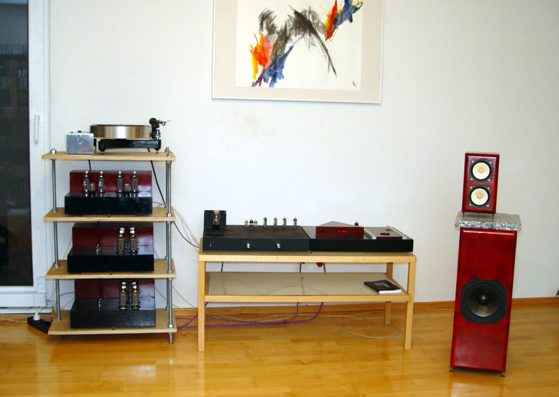

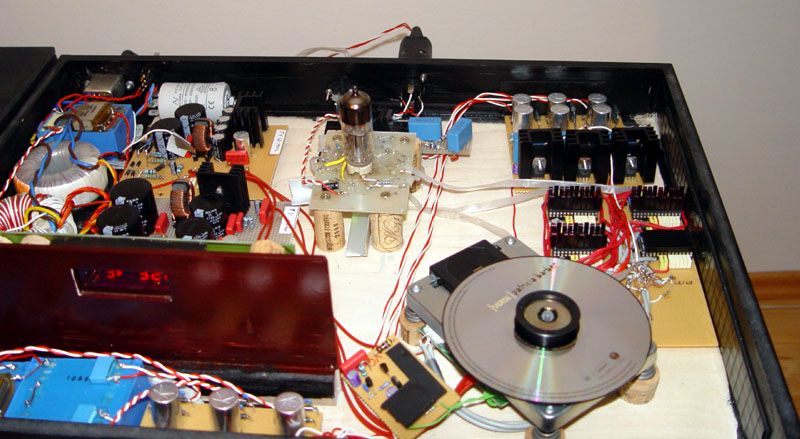

Re: interpolation / TDA1543 vs TDA1541A
Thank You Ecdesigns,
I like my audio on the extreme side
Here is a picture of the inside of the CDP
I found linear phase to be one important issue in sound reproduction. The active speaker has a first order crossover. Coul'd You post some info about Your sonic resonators? Has the principle common sides with Bösendorfers Hornresonator?
I woul'd like to compare Your design with direct interpolation to my just paralleled DACs. Did You compare DI to parallel ICs?
Perhaps there is a room for improvement with a tube transconductance amplifier for the I/V conversion. I'll try that soon. Currently i settled on a small resistor followed by a step up transformer. this combo gives for me the most natural sound. Transformers are - as you noted - non linear components, but sometimes they do magic to the sound. High frequency trrash filtering of the non-os design included
Ciao
Peter
-ecdesigns- said:
By the way, quite an impressive audio set on the photograph you posted.
Ciao
Peter

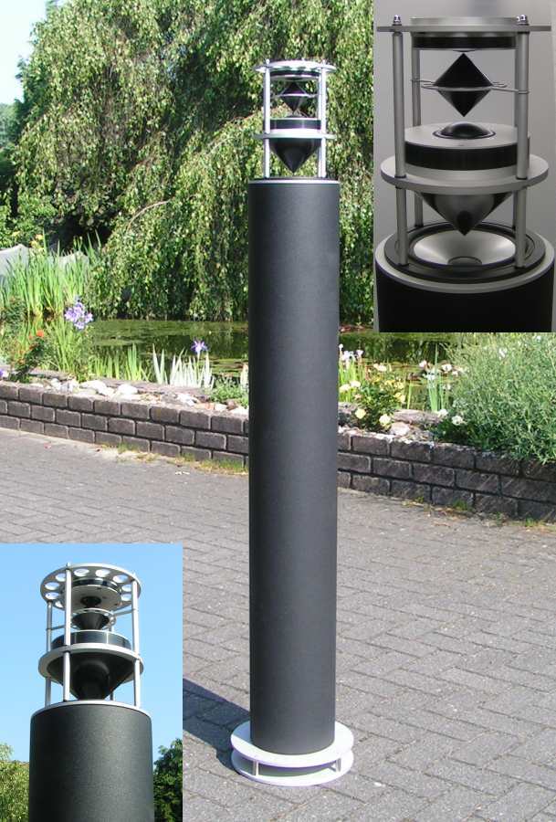

Hi omalnlk
Thanks for your reply [post #1468],
The sonic resonators are a bit off topic, but since they are very important for D-I DAC development, I will post some information.
I added a photograph of different viewing angles of the sonic resonator. I also performed tests outside for fine-tuning sound coherency. This resulted in a coherent sound at large distances from the resonator.
The sonic resonators are point sources, they emit sound in a spherical pattern. When placed outside, you can walk around them, and sound won't change at all. Even at different listening heights, sound is virtually unchanged. Due to the coherency of the sound, placement of instruments and voices is also accurate, unlike most omni-directional speakers. Where conventional speakers start to color or distort sound at higher volume settings, the sonic resonators just get started. The sonic resonators have very high efficiency, 5...10W rms is often more than sufficient for normal listening levels. With 60W rms, it's like you are attending a live concert.
The heart of this unusual looking speaker is the sonic resonator, it's driven by a 7" aluminum cone bass-midrange driver. I used a small driver for fast impulse response, and for limiting the resonator maximum sound pressure.
The sonic resonator is a dual chamber resonator with an acoustic-magnetic correction element. The correction element makes it possible to generate uncolored sound with very low distortion at high volume settings. It also enables very fast response time. The tube has a bass port at the bottom. The sonic resonator also has an integrated sub-woofer that's acoustically driven, it's also controlled by the corrective element. The sub-woofer is responsible for very deep accurate bass reproduction, the major problem is preventing other objects in the listening room from starting to resonate.
The resonator housing consists of a aluminum or plastic tube. This construction is very strong and avoids refections. The bass-mid driver is mounted on top, all gray colored parts are CNC milled from aluminum. Many neoprene rubber gaskets are used for damping and sealing. Even some of the speaker chassis were completely disassembled to insert these gaskets. This eliminates all unwanted resonances. I also replaced the midrange and tweeter internal damping materials.
The bass-midrange chassis emits the sound in a spherical pattern using a large acetal copolymer cone (CNC turned).
On top of this cone, a ferrofluid soft-dome midrange driver is mounted, similar to the bass-midrange driver, it emits sound in a spherical pattern, using a smaller cone. Titanium-aluminum alloy dome mid drivers sounded "metallic", cone mid drivers had too high moving mass (slow response).
The ferrofluid titanium-aluminum alloy dome tweeter is mounted up-side down, and emits sound in a spherical pattern too, using a third cone. Soft dome tweeters couldn't cope with the high sound pressure and started to distort. Ceramic dome tweeters had too little efficiency to cope with the sonic resonator, and had limited high frequency response. Iso-dynamic drivers (traces etched on a foil, placed in a very strong magnetic field), didn't work here either (too low efficiency and very "thin" sound).
Polariser discs are added to create zones with slightly different phase, this way 3D sound information is re-constructed, up to a certain degree.
The speaker had to be tuned (mechanically and by the crossover filter), to obtain a coherent sound that appears to be generated by one single point source. This was the most difficult part of designing the sonic resonators, tuning took a few years.
The passive crossover filter couldn't be calculated accurately enough (too many parameters), calculating a bass reflex speaker is child's play when compared to a sonic resonator. There are many varying parameters, that in turn depend on mechanical settings.
so I started to roughly calculate the passive crossover filters. Next I used a special test setup with a sweep generator to dynamically tune the filters, while the chassis were already mounted in the sonic resonator. This way I got the correct filter crossover points. This was the easy part and only took a few weeks. During filter design it became very clear that the simplest filters provided best results.
Next the crossover filters and distances between speaker chassis and cones were fine tuned, this took me about a year. It became clear that due to the limitations of the filter components used, no further improvement was possible. This resulted in re-building the filter with higher quality parts like Intertechnik polypropylene plus and tin foil capacitors, stranded wire copper resistors, and hand-made air core inductors using stranded copper wire as well.
So I had to re-tune / fine tune the filter again, as these new components had different properties. It took me another year to fine-tune it. Now finally the passive filters are integrated in the sonic resonators, this also introduced some unexpected problems that needed to be solved.
Yes I have, by swapping the timing-chain module with a interconnect PCB, I could place all 8 DAC chips of the DI 8 in parallel. The sound was now less refined and very edgy. I needed to add an 8th order Butterworth filter, but it still wasn't able to match or improve D-I 8 sound at all. The D-I 8 sound was much more transparent, detailed and natural.
I already experimented with passive I/V and tube transconductance amplifiers, the result is sound coloring (sound is no longer neutral and transparent). The tube amplifier would also add significant distortion, I am not saying this couldn't sound good, tubes can produce a very nice sound quality despite the distortion. In fact, I have added a tube diff-amplifier too, but it runs in parallel with a LM4562, and there is a specific "mixing" ratio between the OP-amp signal and the tube signal. This creates a sound that no longer has the typical semiconductor or tube sound, but is much more natural and transparent.
I am trying to obtain a completely neutral, transparent and natural sound. This way all recordings, regardless of the music content will be re-produced in the best possible way.
Hi omalnlk

Hello Maxlorenz,
Currently I have a one Year old kid - the whole audio setup is on the ceiling to save the last survived tubes and chassis
So the CDPRO with a headphone amp is the last audio toy. I'll try that soon
PLease let us know about Your results with the DI-16 and CDPRO
Ciao
Peter

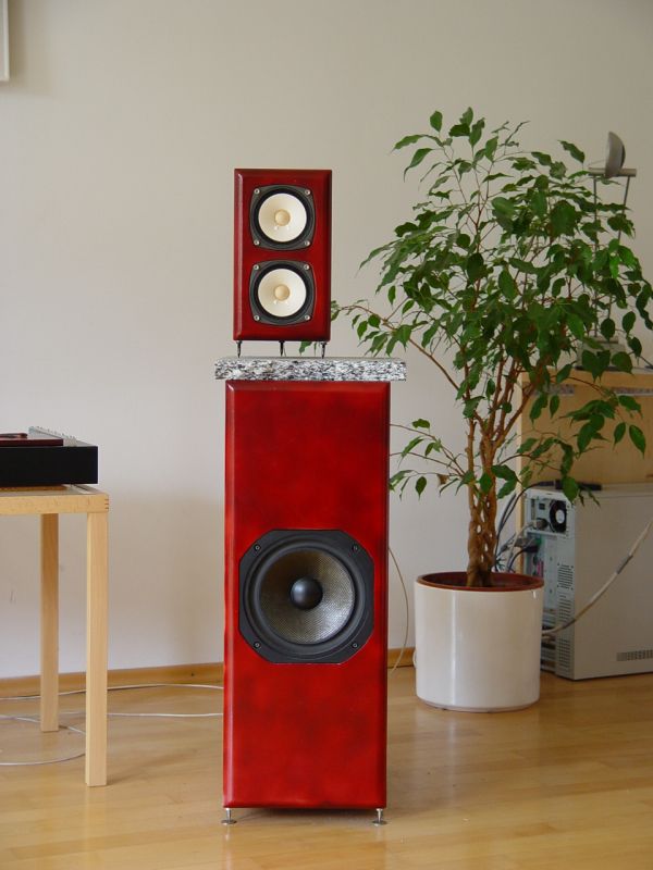

-ecdesigns- said:The sonic resonator is a dual chamber resonator with an acoustic-magnetic correction element. The correction element makes it possible to generate uncolored sound with very low distortion at high volume settings. It also enables very fast response time. The tube has a bass port at the bottom. The sonic resonator also has an integrated sub-woofer that's acoustically driven, it's also controlled by the corrective element. The sub-woofer is responsible for very deep accurate bass reproduction, the major problem is preventing other objects in the listening room from starting to resonate.
Hello John,
The description of this speaker sounds really impressive. Coul'd You explain more about the acoustic-magnetic correction element?

maxlorenz said:
I also own a CDPRO. Please note that the magnetic clamp for the CD is probably causing harm to the sound.
Hello Maxlorenz,
Ciao
Peter
Connecting D-I DAC to squeezebox using I2S
Hi coolbiz,
Thanks for your reply [post #1477]
Well Actually I dug out my squeezebox 2 player, bought it years ago... The attached photograph shows it driving a DI 16 directly trough I2S
The I2S signals were located quickly: R5 BCK, R6 DATA, R7 WS. Then compatibility problems occurred as expected, they were solved by adding complicated glue logic....well, it only took 1 D flip-flop to delay the DATA signal 1 BCK period, that's all.
D flip-flop: clock connected to BCK, D input connected to the I2S data signal of the squeezebox, Q output connected to the DI 16 DATA input.
The I2S BCK signal was a bit jjiitteerryy. It could be corrected using the shiftregister reclocker.
But there are other elegant options for music player. I use a 17" iMac G5 with 500Gb HD, connected to the DI 8M / DI 16 through USB. The USBDI2S module provides exceptional sound quality by providing a very low jitter timing signal.
If you want a hi-tech remote control, use a cellphone and install Salling Clicker remote control software (Bluetooth). Now you can remote-control your computer, that can be located in another room (fan noise), and use the full colour screen of the cellphone to browse through your CD collection. The USB connection between computer and D-I DAC can be up to 5 meters (passive USB interlink) or longer (active USB interlink).
The mac mini with a 500Gb external storage drive could serve as a beautiful compact music player, no screen or keyboard needed, just remote-control it with a cellphone.

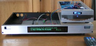

Hi coolbiz,
In case I missed it in this very long thread: Has anyone successfully interfaced a Slim Devices Squeezebox to one of these DACs? Is there any reason why it cannot be done? In the Slimdevices forum there seems to be several owners who have modified their Squeezebox to provide I2S output.
