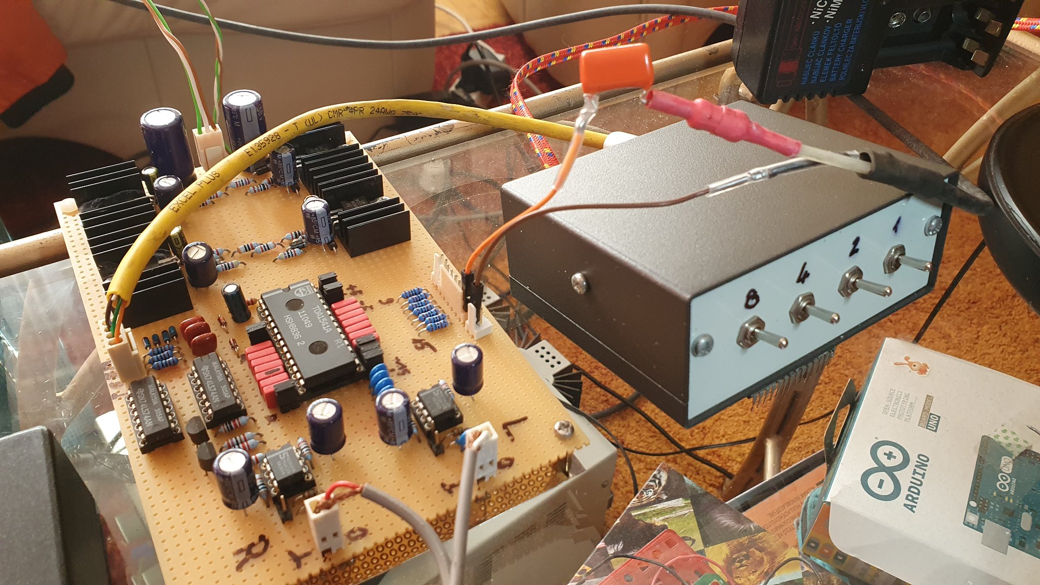

Ideas needed for better understanding the DEM filter circuit
What is the impedance of the DEM filter pins where the external capacitors are connected? Do the capacitors need to be the same, or different? If some pins are lower impedance, the capacitor attached there should be higher capacitance, for achieving the same ripple rejection - so I think.
I can generate special I2S signal where each bit 9 to 15 can be turned on individually. All other bits remain zero, except the bit being turned on. This results in an analog DC output between ~0 mA and -2 mA (~0 V to +3 V after I/V conversion). Then I inject a 440 Hz current "disturbance" into the selected DEM pin and observe the analog output. I injected 1 Vrms via a 10M resistor and a DC blocking capacitor. Here is what I get:
Bit 9: 27 uVrms
Bit 10: 54 uVrms
Bit 11: 99 uVrms
Bit 12: 71.4 uVrms
Bit 13: 97.5 uVrms
Bit 14: 97.7 uVrms
Bit15: 128 uVrms
All other bits show just DC and some noise, except the bit being "disturbed".
The impedance of the DEM pins is clearly not the same, because they attenuate the input signal of fixed 10M source impedance differently.
I am stuck at the intepretation.

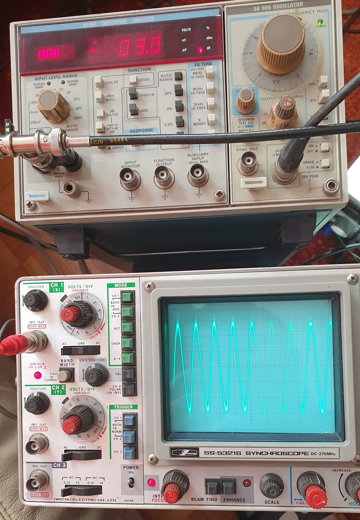

My numbering scheme is:
Binary representation of analog values on 16 bits is 0x0000 to 0xFFFF. MSB is the highest order bit with weight 2^15. LSB is the lowest order bit with weight 2^0. I simply named the bits 15, 14, ..., 2, 1, 0. Bit 9 decoupling capacitor is on TDA1541A pin 24 (L) and pin 7 (R). Bit 15 is on pin 18 (L) and pin 13 (R).
Now I measured the -3 dB cutoff frequency of each decoupling internal R and external C (100 nF). Here are the measured values:
Bit 9: 175 Hz
Bit 10: 170 Hz
Bit 11: 370 Hz
Bit 12: 235 Hz
Bit 13: 360 Hz
Bit 14: 360 Hz
Bit 15: 800 Hz
The calculated internal resistances are:
Pin 24, 7: 9.1k
Pin 23, 8: 9.4k
Pin 22, 9: 4.3k
Pin 21, 10: 6.8k
Pin 20, 11: 4.4k
Pin 19, 12: 4.4k
Pin 18, 13: 2.0 k
