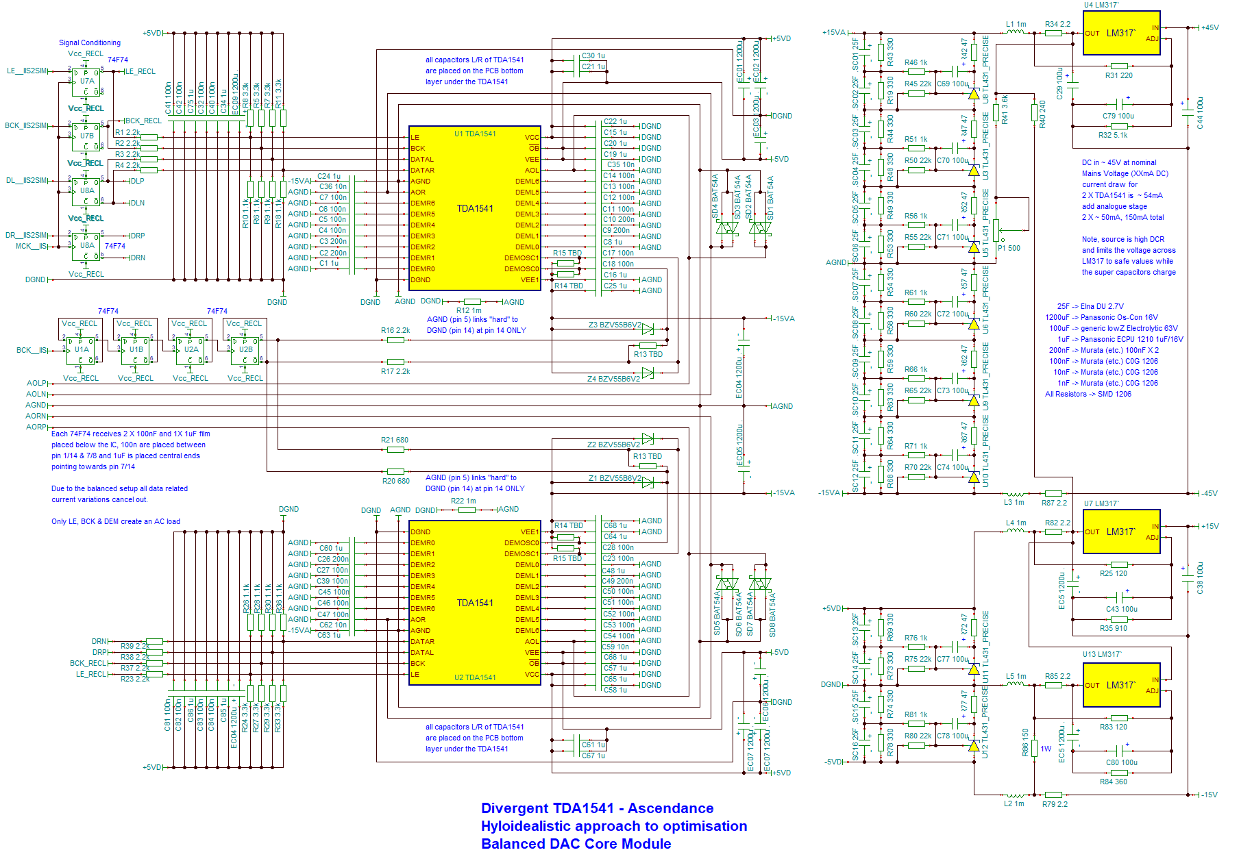

Ok, I promised the AscenDance version (pun intended).
First draft and it shows both the possibilities and penalties in complexity on really going out on a limb....
There are few little things here that may be worth explaining.
First, I decided to switch the DEM SYNC to a balanced Grundig Circuit. Reason is, that in the sim the very "light handed" version can be instable at higher speeds. In the end when the oscillator circuit has one transistor shut off and the other at maximum current current flow stops. Being balanced, there is no net current injected. The two TDA1541 run at opposite polarity, this means any switching noise tracked into the power supplies happens at 1/2 the current of simultaneous switching and twice the frequency. In my books a "good thing".
The TL431 circuit around the super capacitors is a forced protection/balancer, using a style of circuit normally seen in the regulation of SMPS. The capacitor from anode to ADJ sets the AC loop gain, 1K & 100uF gives a 1.5Hz turnover. The 22k resistor makes sure that each 431 only turns on with typically 5.2V across the series connected block. That is, as long as things are normal, the 431 is actually off. If it turns on it will progressively not try to regulate anything above 1.6Hz. The 47R resistors limit the current in each TL431 to 60mA, appropriate for SMD versions. If TH TO-92 is used, the resistors can change to 27R.
There are a few resistors to balance out all currents to pretty much net zero. The analogue voltage comes from 30V DC, the analogue stage will run from +/-15V and be no-buffer balanced with a passive LC filter as output. Nope, no Op-Amp's (I think). Each channels output stage is current steering and needs around 50mA.
There is technically no negative regulator. Instead we regulate DGND to 5V higher than the -5VD line. The 150R resistor makes sure to draw enough current that there is always some current flow. The +5V line is regulated to be 10V higher (under load) than the -5V line.
This allows us two completely floating voltages of appx. 45V and 15V DC giving respectively 30V & 10V well regulated and passively filtered supplies.
The 317's use a trick to limit current used long ago for battery charging (Lead Calcium or Acid trickle charging), with current limited to ~ 0.5A the charging time is around 120 seconds or 2 minutes. So this DAC will have a significant warm up time.
I'll sit on this for a few days to see if any more ideas percolate and then start a PCB Layout in Altium.
Thor

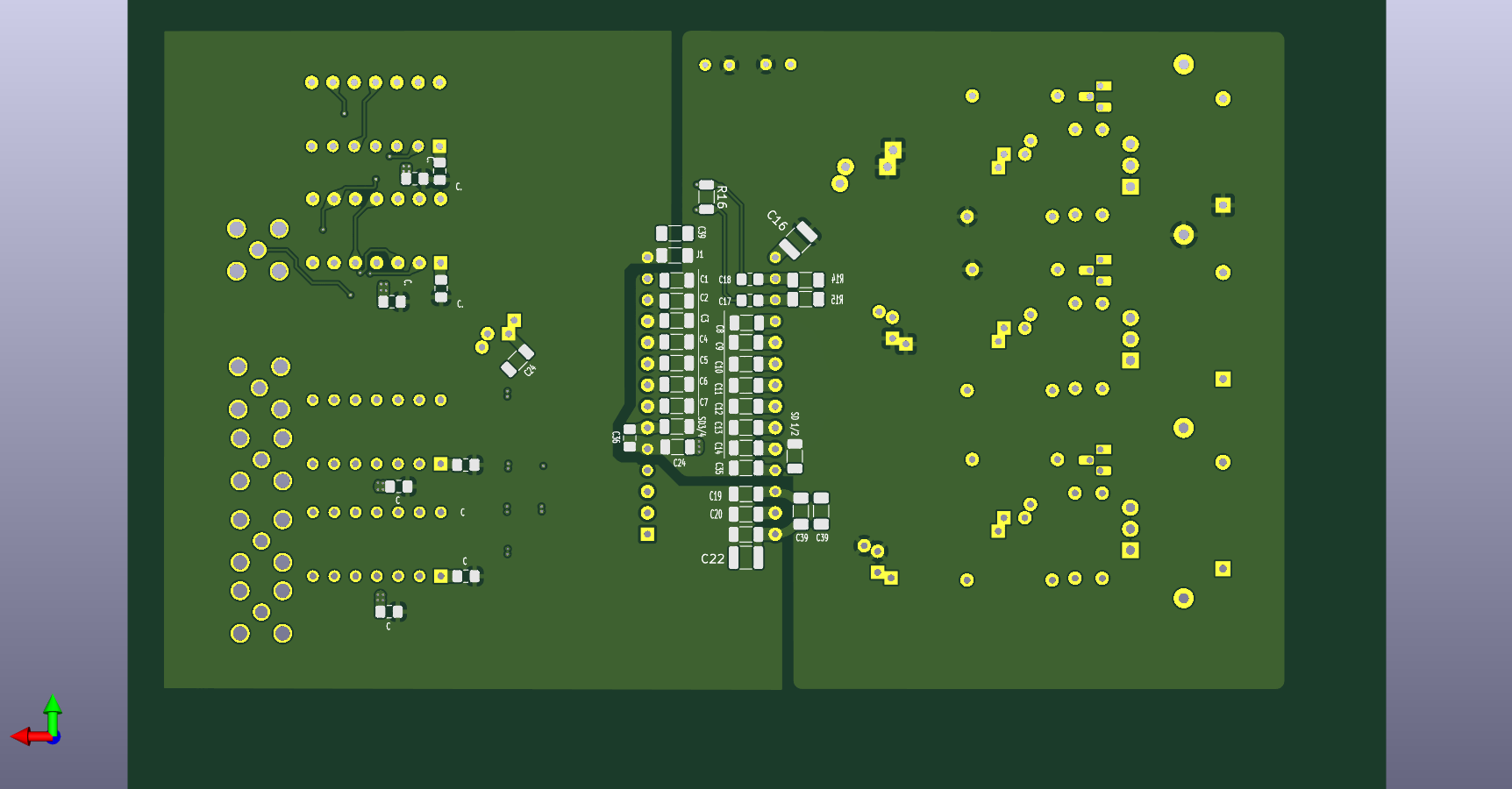

We could piggy back a Core pcb daugther ( that is almost finish) with the same core sharing the supply of the mother board (extended core with supply) as I shown in PM ?
Edit : I see, all the suply is different, so not feasible. I wonder if I should continue the standalone one, better to jump direct on a 2 IC version directly made by you than mine with your advices 🙂 ? And no doubt Altium IS the pcb cad Soft. Calculating impedance of tracks is a nigthmare I find in Kickad... as doing clean pads for decoupling with vias.
No, this will be deliberately split into +/-15VA and +/-5VD which is more doable on a balanced setup. It will also include the analogue stage on board.
As I do not have the time to deal with supporting PCB's I will consider if I make the actual PCB public domain.
I will make a PCB because that is now well past veroboard, kapton and copper tape.
The argument up to now for the single was that TDA1541 are rare, expensive and so on.
I now have enough donor CD players to not mind.
But I think most people would probably prefer a single TDA1541 PCB without super capacitors and with limited complexity, but as high performance as doable within this set of limitations.
Thor

How the I/V stage presented in post #9243 can be used in this differential version? is it sufficient to simply remove the phase splitter and duplicate the ciricuit?
you have the decoupling caps under the chip and facing toward chip centerline now (I like it but why?).. assume AOL/R skirt around the IC as per T's CD-77 v7.0 layout (?) - you really might be the guy with the PCB ..
It is progressing everyday, don't focus on what I posted above.
And changes migth happen with Thorsten Losch ideas and Icsaszar work.
