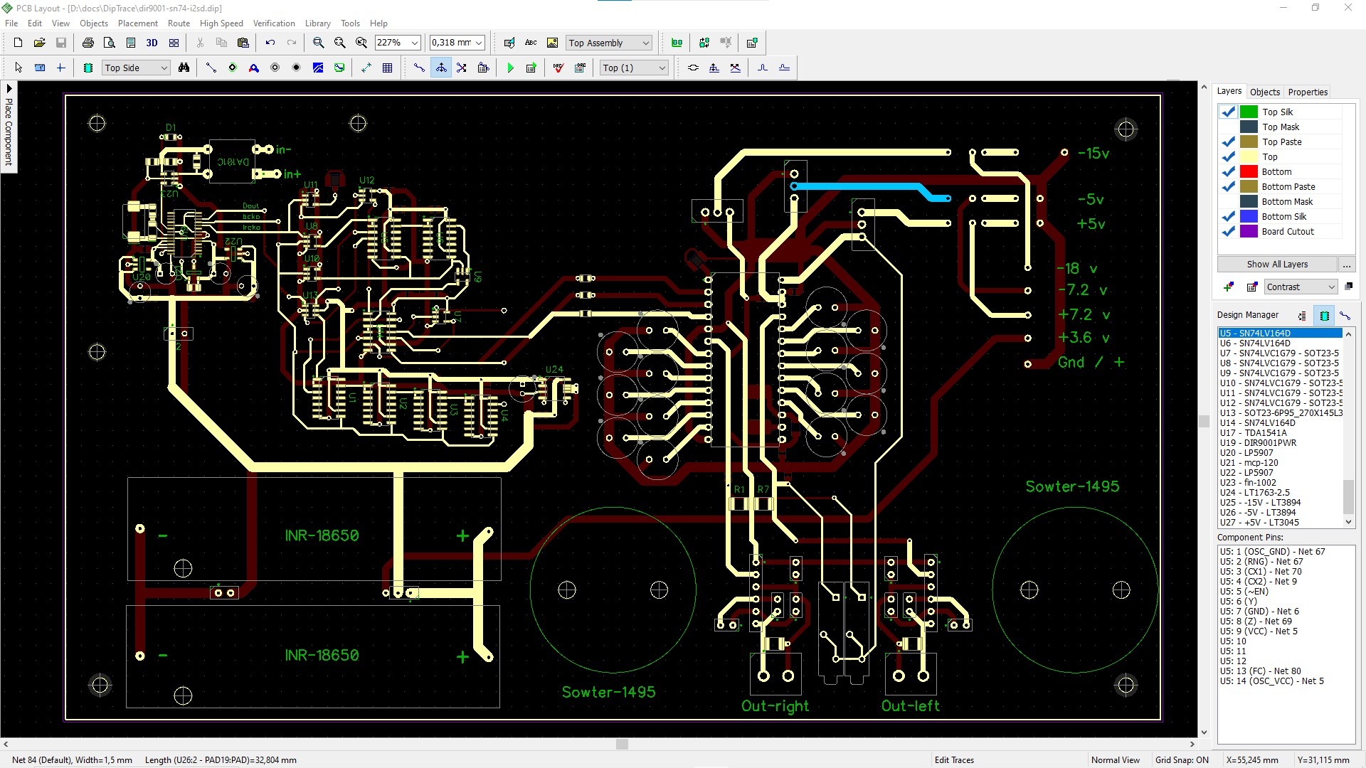

Here is my next pcb , for the simultaneous version , including 50 Hz DEM and some others features
it is battery powered , the logic schematic is from John
as before there is an usb to spdif CM6631A board on top of the dir9001 , copper pour on both side are not shown
and as usual any constructive thought welcome 🙂

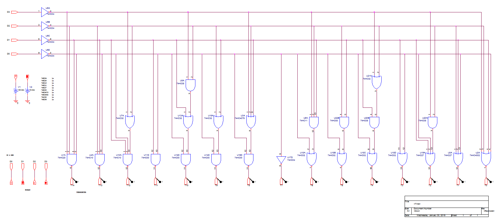

This is first 4 bit of binary transcoded to 15 bits of thermometer code.
Apologies for the veer, it is however very tenuously TDA1541 related.

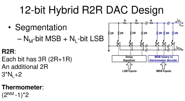

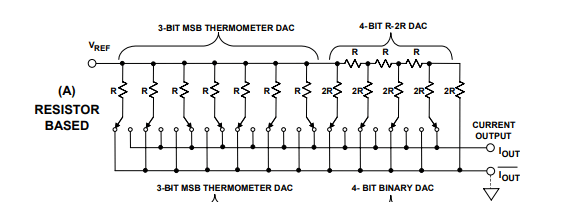

The reason to use thermometer code and not binary weighting is to use DEM error scrambling. Thjat is exactly what Philips did with TDA1541.
By doing the 4 MSB this way instead of R2R we have much better precision for the downstream It's an extension of this principle design:
This means we use a random selection of individual unitary weighted elements (all 16) and by updating the selection at a high multiple of the sample rate (say 32 Fs using BCK) and thus "average out" resistor tolerances.
In effect using 15 Resistors averaged twice we get a 8 times improvement of tolerance even for a single weight. So our 0.01% resistors become in effect 0.00125% Resistors.
Of course to create a bitstream at such a rate we need in effect 16 Bit (switches) from something like a FPGA, serial update is not workable. I guess we can use Bit 16 bit switch for the LSB of the R2R DAC which will receive a 32FS DS modulated signal with the lower bits. The lower bit's could be loaded serially, otherwise we would need 32 Pin's on an FPGA (or 64 to do it balanced) which is quite manageable.
So I would suggest using an FPGA with 64 Bit output that handles all the logic and if followed by "bitswitch" drivers that differential, that is each IC is used half for positive phase and second half for negative, which should largely also reduce the Vcc/Vss current from charging/discharging the gates inside the IC).
I do not see a sensible way of doing this well without FPGA or a rather high power, large pin number CPU.

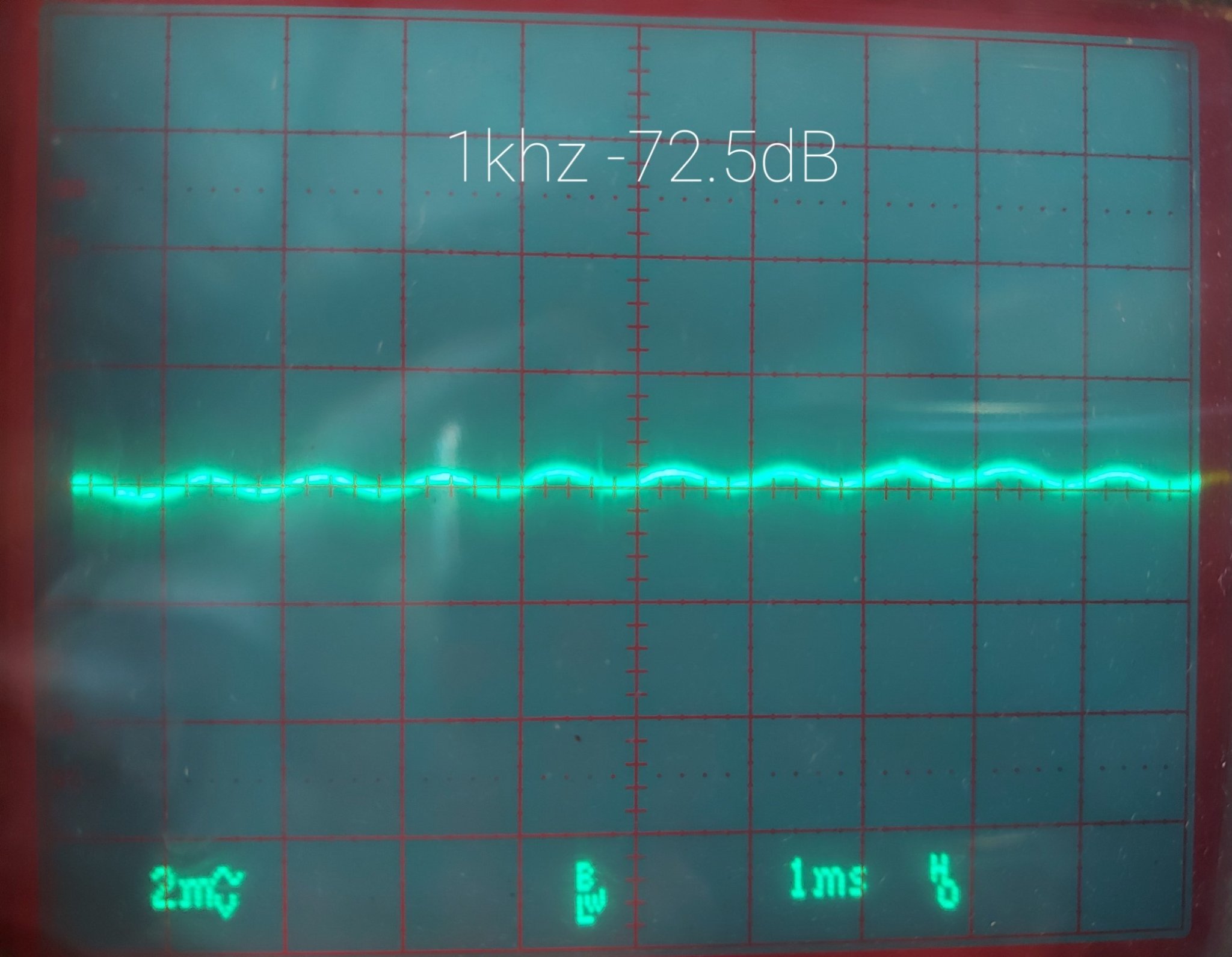

Well , if you look at the previous measurements there is no 50 Hz spike ( -105 dbv ) , the one you see is an ambient pick up , very common at that level , especially in a home setup 😉
DEM seems to be operating just fine in this 4 x 1541 deferential setup i tested, this is a 1k sine at -72.5dBFS. Surely without the DEM operating correctly this wouldn't be possible?
