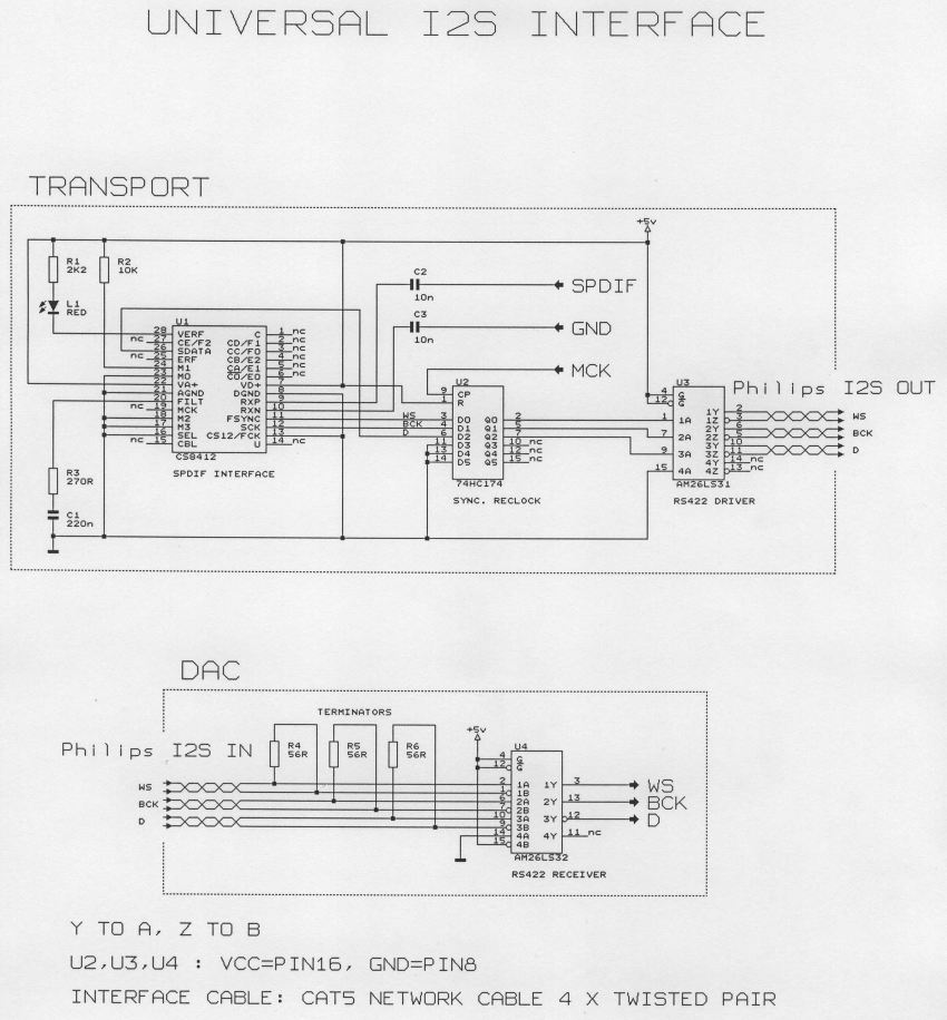

Yes, I already know the balanced i2s transport technique, I'm already using it via amls31/32 transmitter/receiver.
I didn't mention to simplify.
I also know how to switch i2s with logic gates.

IMHO, that design is suffering of a high jitter and is not made for high quality playback whatever it is 16/41 or 24/192, simultaneous mode or not.
Best bet is to put a fifo buffer and reclocking just before the sim board where here the cable length will be short within less than 10 cm between the reclocking and the dac chip. Maybe IanCanada 2 blocks classic fifo board and reclcok board : despite being two boards they share some logic and must work together (they were sold in two boards more for commercial reasons i believe). This design is imputing I2S and outputing clean reclocked I2s.
Then you can put any passive sim board or a fgpa based one as the Iant I2S to PCM board that can be slavered by this clock for jitter reason and can outputt sim mode for tda1541A and few pcm other chips (ad1862, pcm63, pcm1704, pcm56, etc). I have 4 of those board if interested by one if you need one.
Despite you use balanced with the cables I really use in your shoes a dedicated gnd return cable by pair, so each shielded and isolated from the gnd return cable of the other pairs. Should be feasible with the lastest high speed tcp/ip cables which pairs are all shielded.
I cam report that I was using digital balanced transmission with theese pairs AM26LS31 / AM26LS32.
Even in "no-need-for" short connections.
And sound always was significantly better. I cant explain why?
Althouht this termination of 50ohm might be so low, inspired the datasheet recomm... I think that i used larger value 220ohms to 1K.
And with a resistors in each line for the signal inefrity. to eliminate spikess at the edges and reduce ground bounces... Google for signal integrity.
Cant remember now BUT that could be maesured with a scope and chope what is better? I did that way...
With enable function at every chip You can acheive a selection in addition when nedded. BUT and transmitter and receiver should be EN or DISS in the same time...
Another feature is that You can have inverted DATA line, by simple routing transmitter +out to recever -in and tr -out to rec +in
Off course that other trans/rec pairs could be used. The principle remains the same.

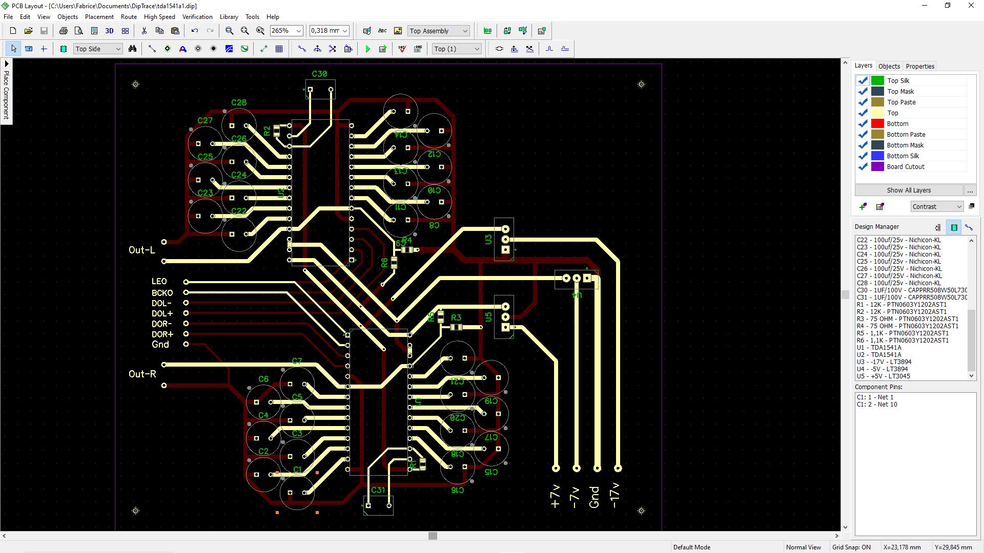

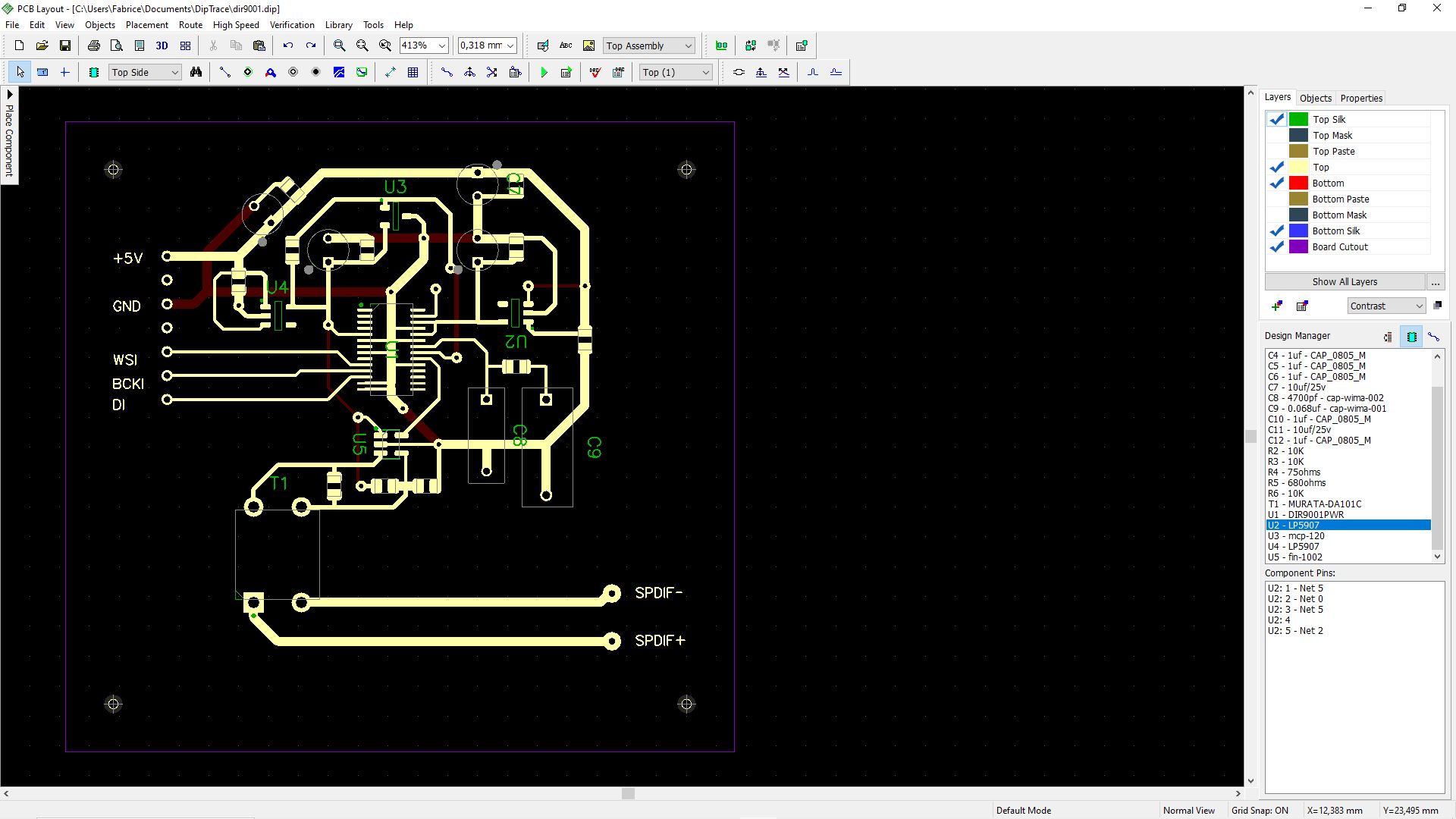

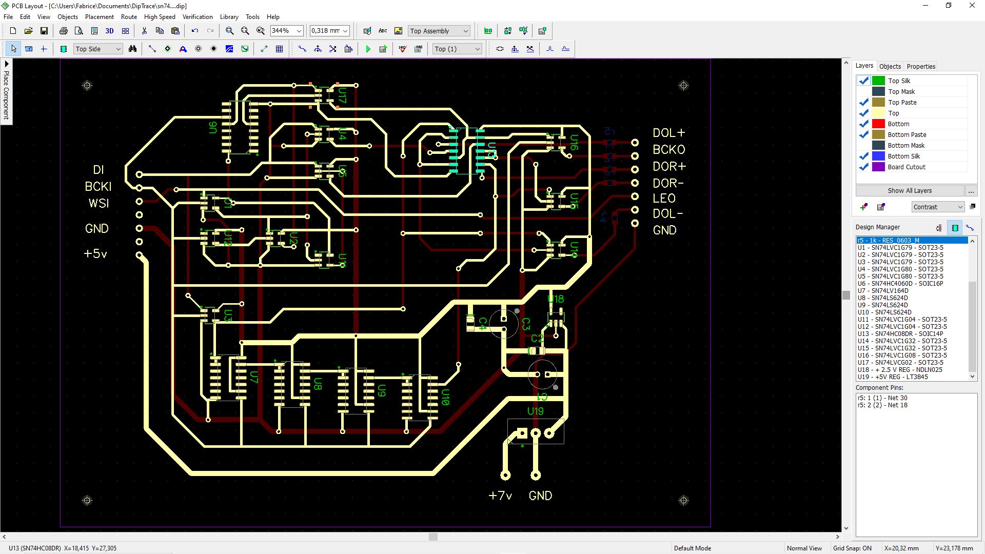

Hello everyone ,
I finally finish to read the all thread , and comes to the idea to build the DAC as per John from Ecdesigns
the TDA1541A Dual Mono 17 bit Signed Magnitude DAC
I want to do it as close to his recommendations as possible , here are the first attempts to get pcb from his notes and shematics :
I/V out will be passive , a pairs of Sowters 1465
any thought are welcome

Copper pour will be on the bottom side , where most of the ground connexions are , if by shape you meam the width of the trace , I will grown them as much as possible , it is difficult to be large enought and far from other trace
I am a beginner and have a lot to learn

And regarding the layout: try to keep traces on one layer only, make the traces on the other layer as short as possible, returning them as soon as possible to the designated "signal layer". The other layer shall be your "ground layer".
For PCBs with THT, that basically means top layer = ground layer, while bottom layer = signal layer. Use multiple vias when changing layers (reduces via inductance).
