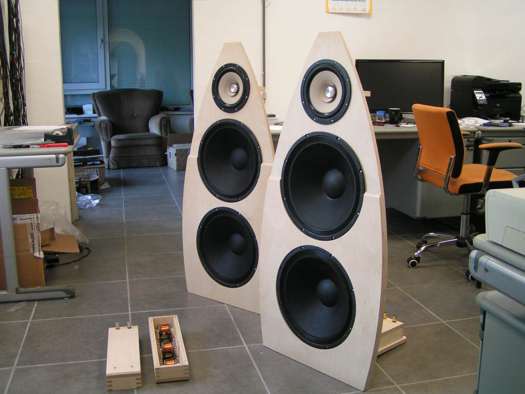

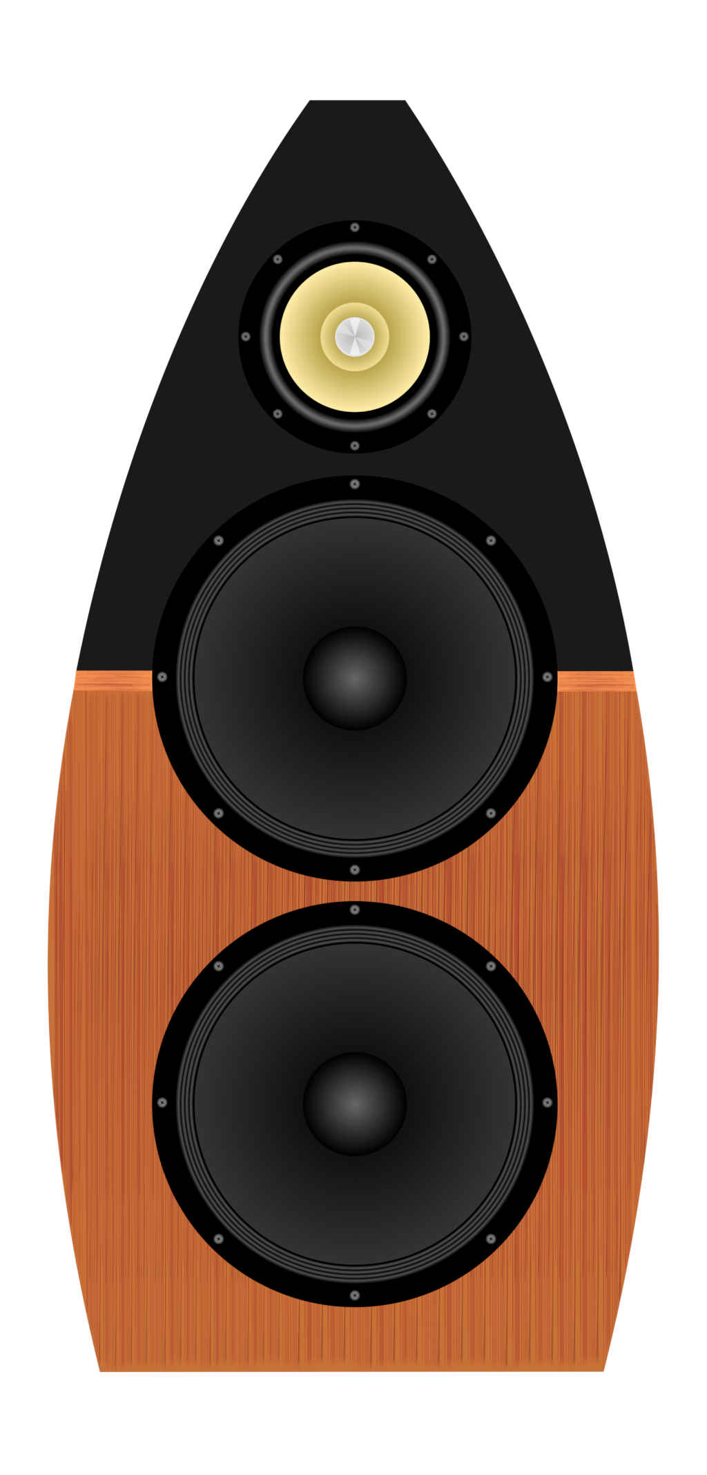

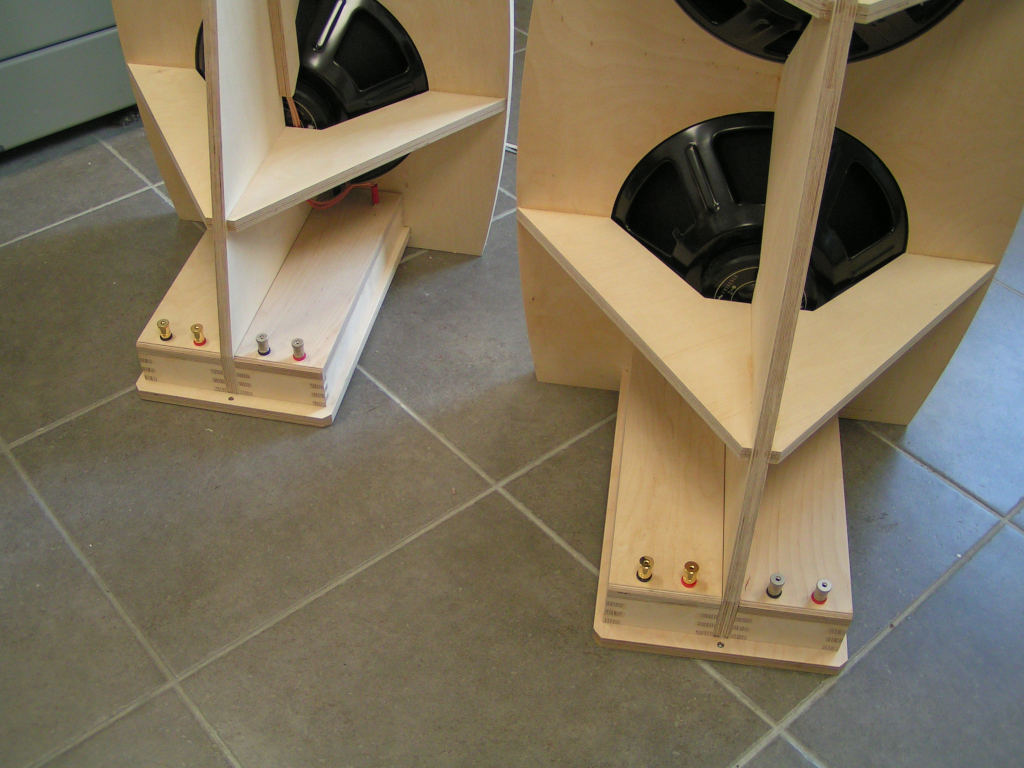

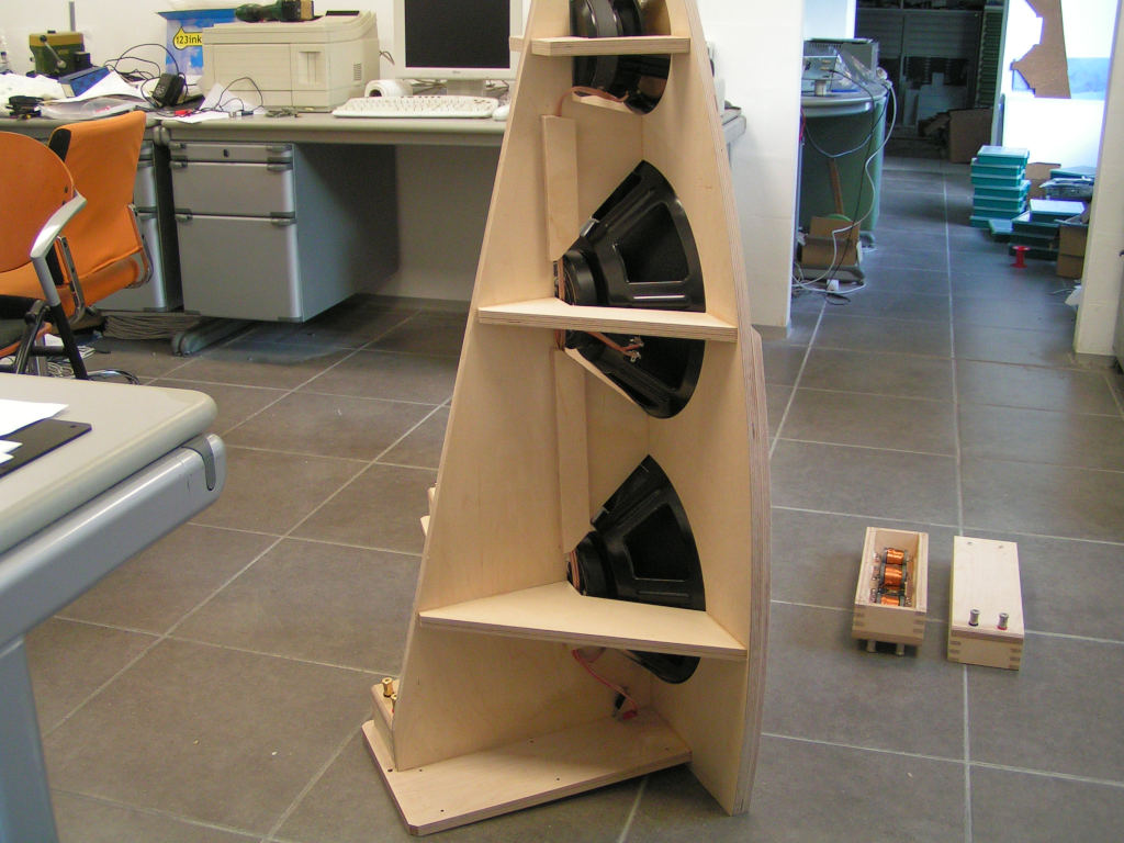

Hi BarG01,
It is based on one Tangband W8-2145 8" full range driver:
W8-2145 - 8" Paper Full Range - TB SPEAKER CO., LTD.
And two Eminence Alpha 15A:
https://www.eminence.com/pdf/Alpha_15A.pdf
Crossover filter:
W8-2145 (no filtering).
2 x Eminence Alpha 15A in parallel, 4.7mH choke.
This crossover filter was designed for use with the PowerDAC.
Impedance 2.67 ... 8 Ohm.
Crossover frequency (bass) 135 Hz.
Sensitivity: 90dB.
Height: 122 cm
Width: 58cm
depth: 46cm
It is constructed from 12mm and 18mm plywood.
I attached pictures of the speaker construction. The boxes that hold 6th order Linkwitz Riley low / hi pass filters are no longer required.
We plan to offer these open baffle speakers for use with our PowerDACs. These speakers will be introduced together with the PowerDAC, introduction is planned for late 2021.

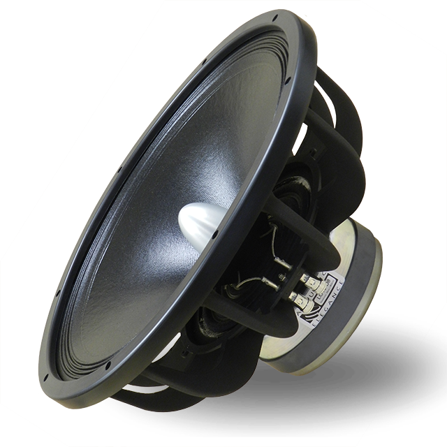

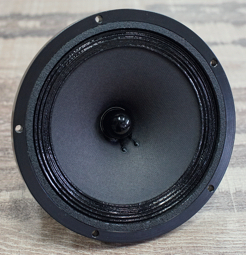

It's very similar to the speaker system I'm building, if ever I will find the time to finish it.
A couple of 15" driver for the bass section, the AE LO15. Then a fullrange driver, the Supravox 165 GMF. And finally the Great Heil to refine the high section.
The sensitivity is around 97 dB.
I use a minimal crossover although very different from yours. The AE drivers operates up to around 100 Hz, but I cut them with acoustical filter rather than electric. Then a single series capacitor for the Supravox to avoid very low frequencies that only generate distortion. Again there is an acoustical filter at about 7 kHz for the fullrange. Finally a single capacitor for the AMT driver that could be damaged by high escursion.
After years of listening I believe that the Open Baffle is the only way to get realistic sound.

The Supravox 165 GMF has very nice mid, one of the best I ever heard. It's more linear than the L CAO, while I have never listen to the EMS drivers.
The baffle will be enough wide but the excursion of the Supravox will be limited by a high pass filter with a single capacitor. I think to cross it at around 100 Hz, but the best crossover frequency will be experimentally derived.
Yes Andrea, I agree this particular Supravox (and the 16") has something quite nice. Papers cone from PHL seems better though but mayve not as FR than the 165 GMF. I believe the new Fertins with EMS-Speaker to be a little above old SUPRAVOX -mms very low that causes break-ups in FR which they are made for -
think if you HP with a single cap you should have to cut-off high and it will suffer more with the natutal acoustic short of OB in these frequencies. SO certainly the bass driver must overlap and be a little Linkwitz-transform helped.
