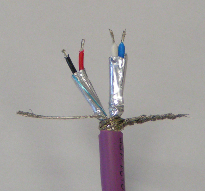

After getting annoyed with the flimsy USB interlinks with poor shielding and super thin wiring I decided to construct a better option. I use individually shielded data and power wiring pairs and thick wire with low DC resistance so I get a decent power supply at the USB receiver (reduced voltage drop / reduced load induced ripple voltage) and more reliable data transfer over larger distances. Note that with USB audio streaming, data transmission errors cannot be corrected. The individually shielded wire pairs minimise unwanted crosstalk between both, USB bus power wire pairs and USB data wire pairs.
I attached a picture of cable construction
