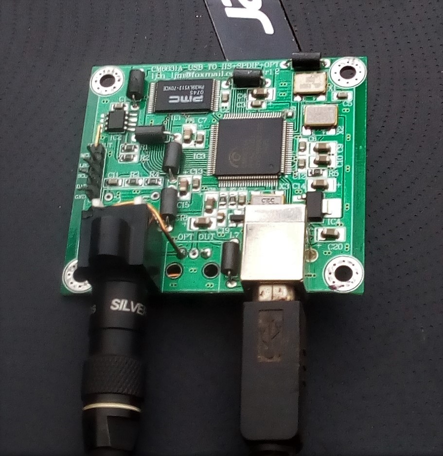

Another option for those intrigued about Elektro-optik link.
Use an USB-to-SPDIF/Toslink converter, like the one in the picture (inexpensive and good), remove the Toslink Transmitter and wire the Toslink output to the SPDIF connector. In this particular module, which I am very fond of, the coaxial output is transformer coupled so I removed the Tx and made sure that the ground of the connector was properly grounded.
Edit to be more clear:
1) Remove the Optical Transmitter.
2) Remove the SPDIF coupling transformer.
3) Connect "optical signal" to "coaxial signal" and "ground to coaxial ground".
Of course you still have to install the Red LED/Toslink adaptor to one end of the signal cable to be connected to your DAC's optical input. This is to have totally clean and high Q sound from a PC source. 😎
Of course, your software will then be the limiting step to great sound...
I hope you like it,
M.
PS: of course, you can also keep the Toslink Transmitter and wire the Coaxial connector in parallel, to be able to compare between cable formats...😉
