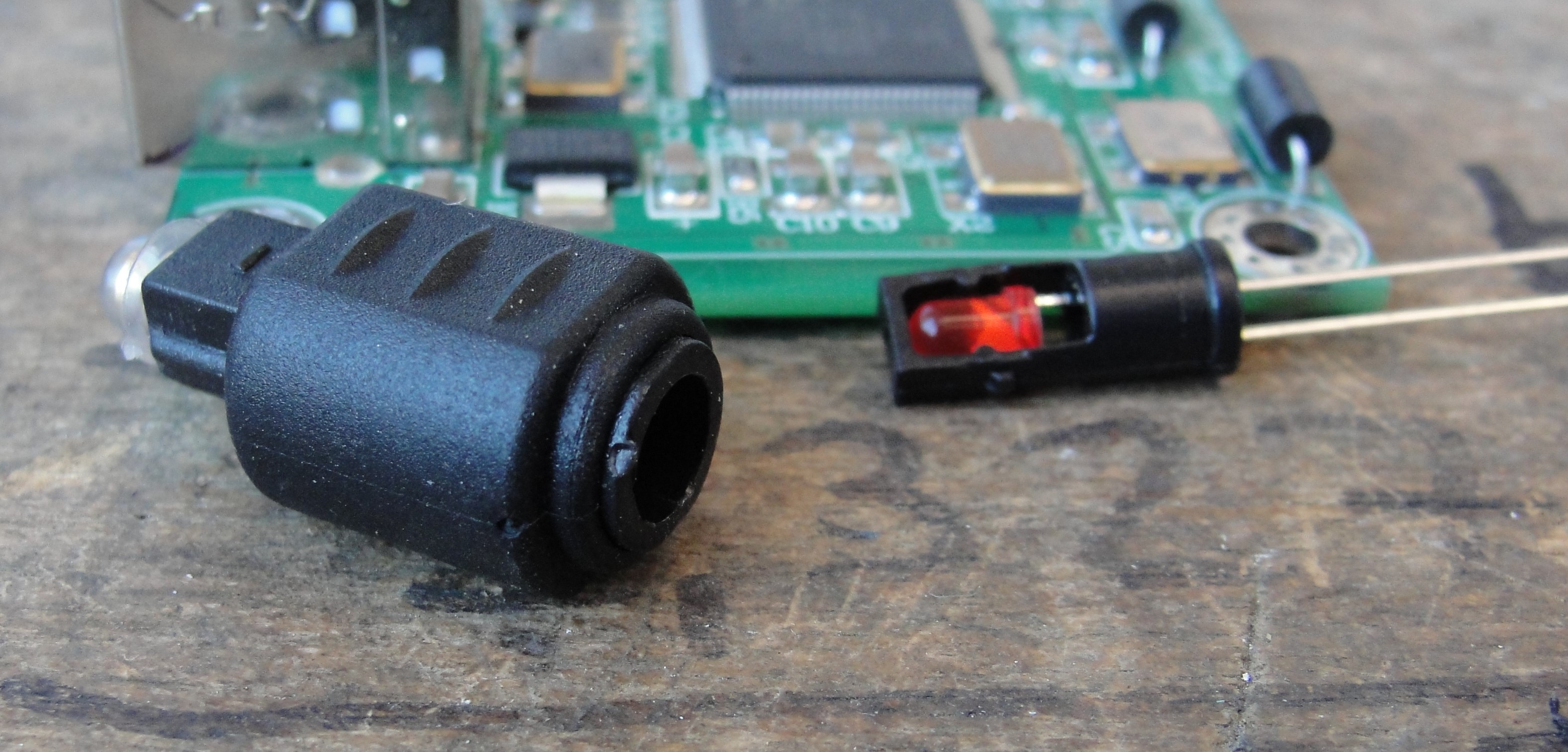

Elektro-optic link, part 3.

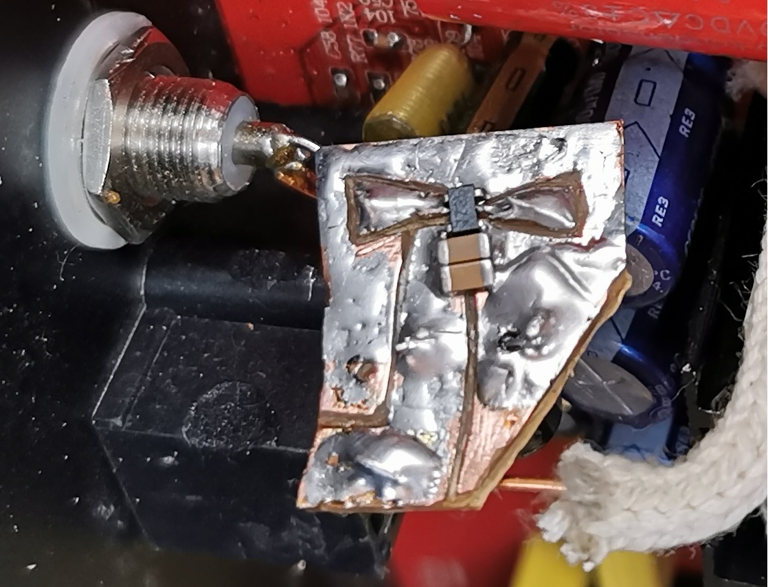

But what if your source cannot drive your Optic input receiver and the DAC end, via your electric coaxial cable??? 😕
You can always use a tiny UHF buffer 😎 like I did with my son's (unused; he listens to his phone) Chinese SD-card player.
https://www.onsemi.com/pub/Collateral/NC7SZ125-D.PDF

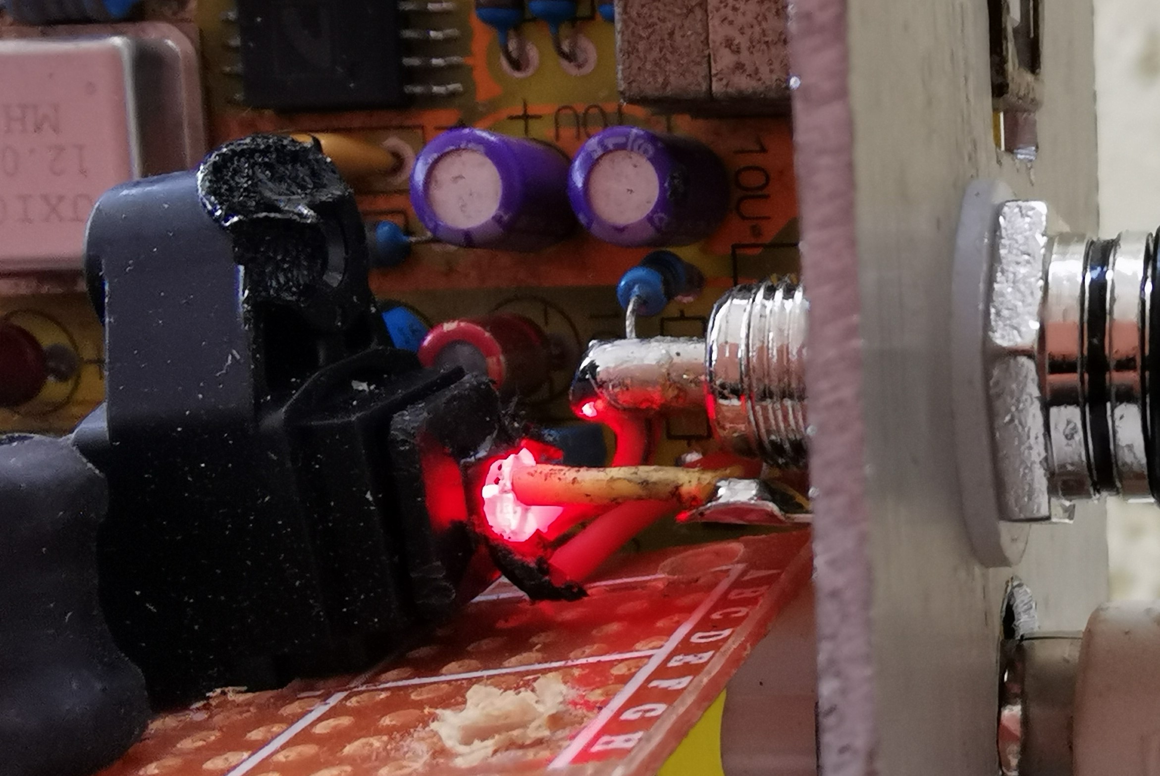

Now I wonder, how long will the red LED last?... considering maybe 50% duty cycle and +/-5V supply...
How would an elektro-optic linked I2S input perform??? :lickface:
My daughter n°2 has a good cellphone camera. Here you can better see the red LED gently convinced to enter the TORX177 protector cap. 🙂
The tiny buffer is not a joke to work with!
Now I am sure I can transform any digital source into an Elektro-optik capable source.
I hope you like it and feel encouraged to try it.
M.

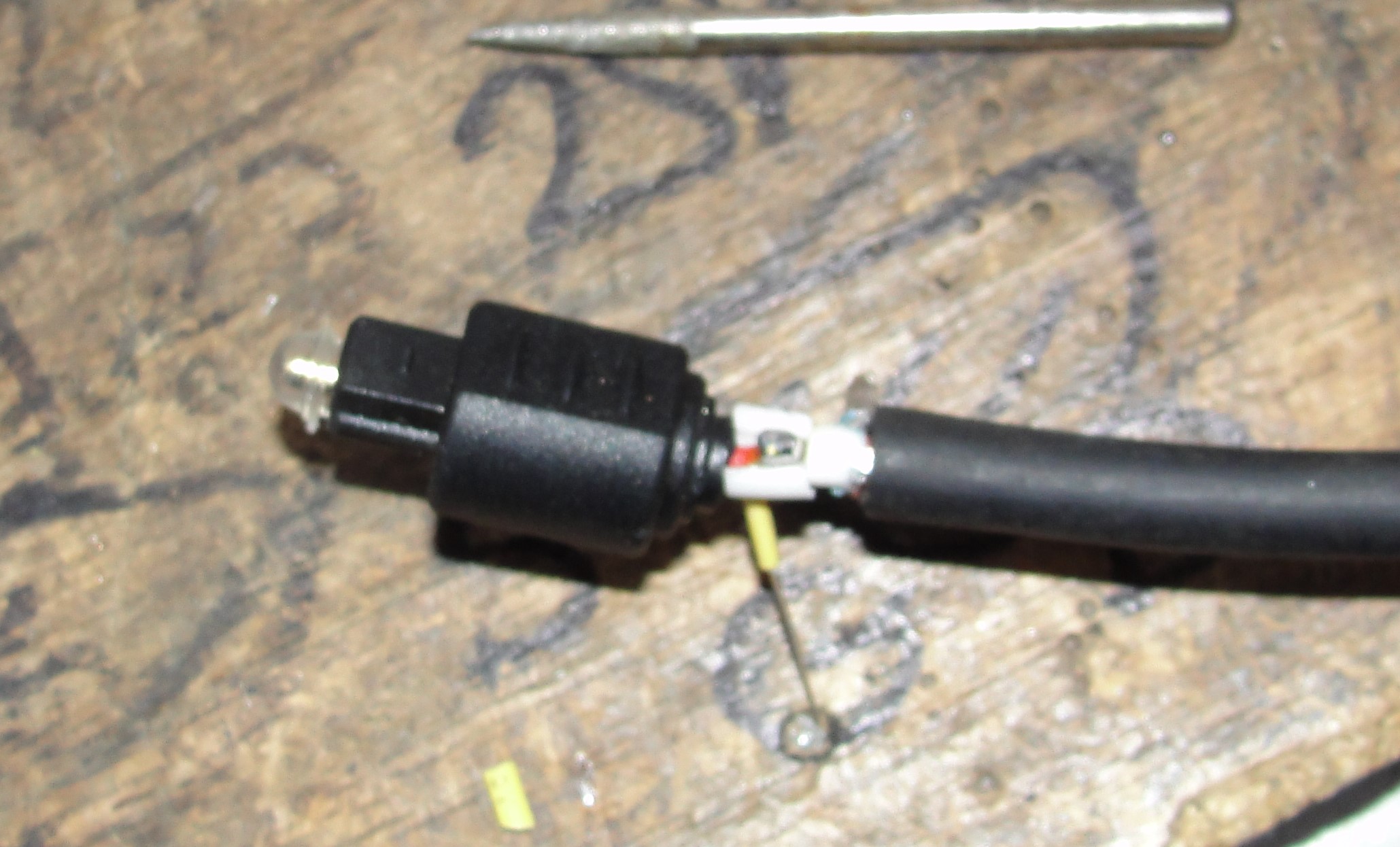

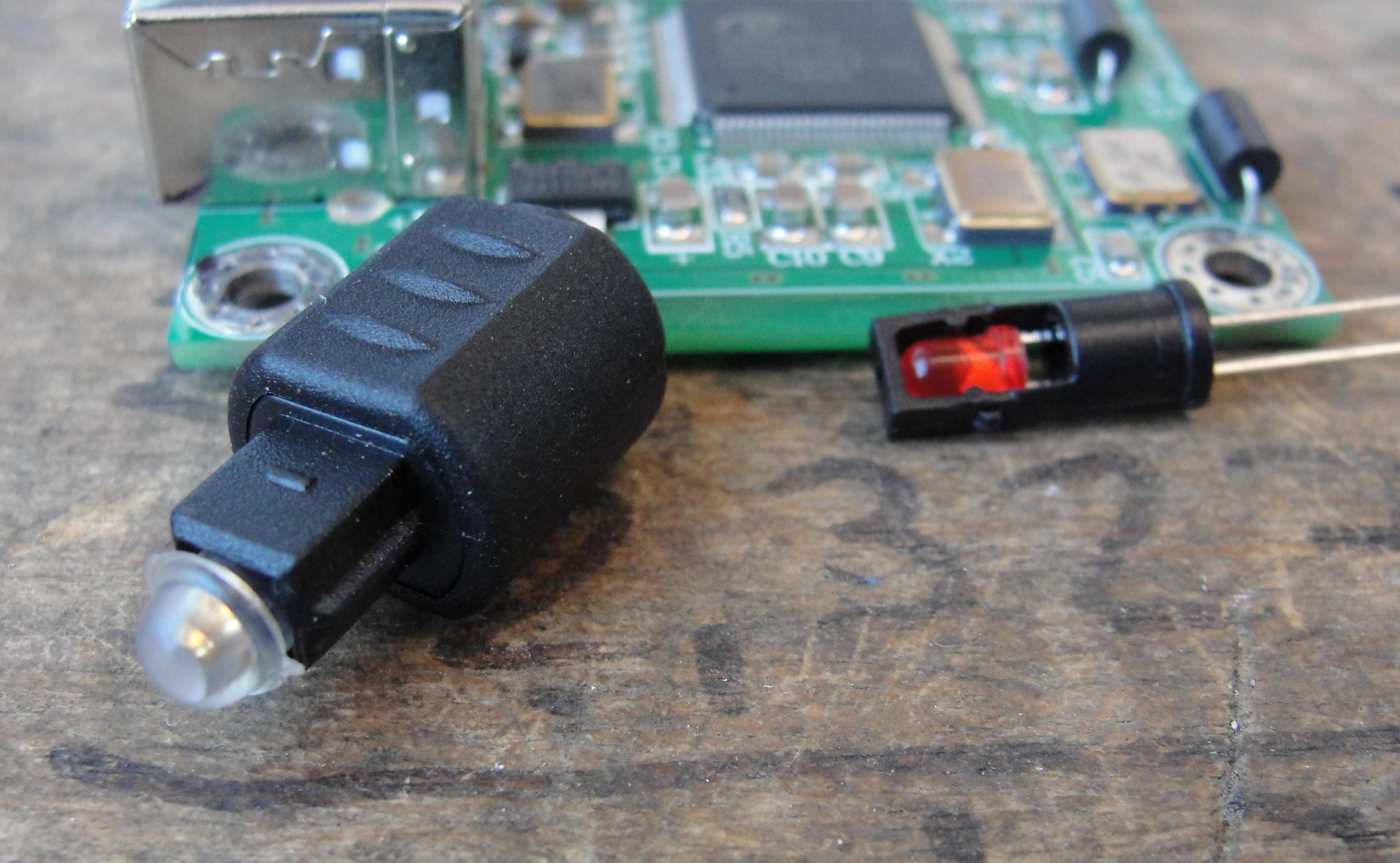

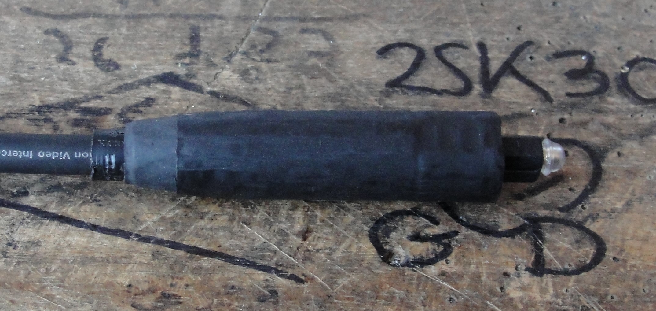

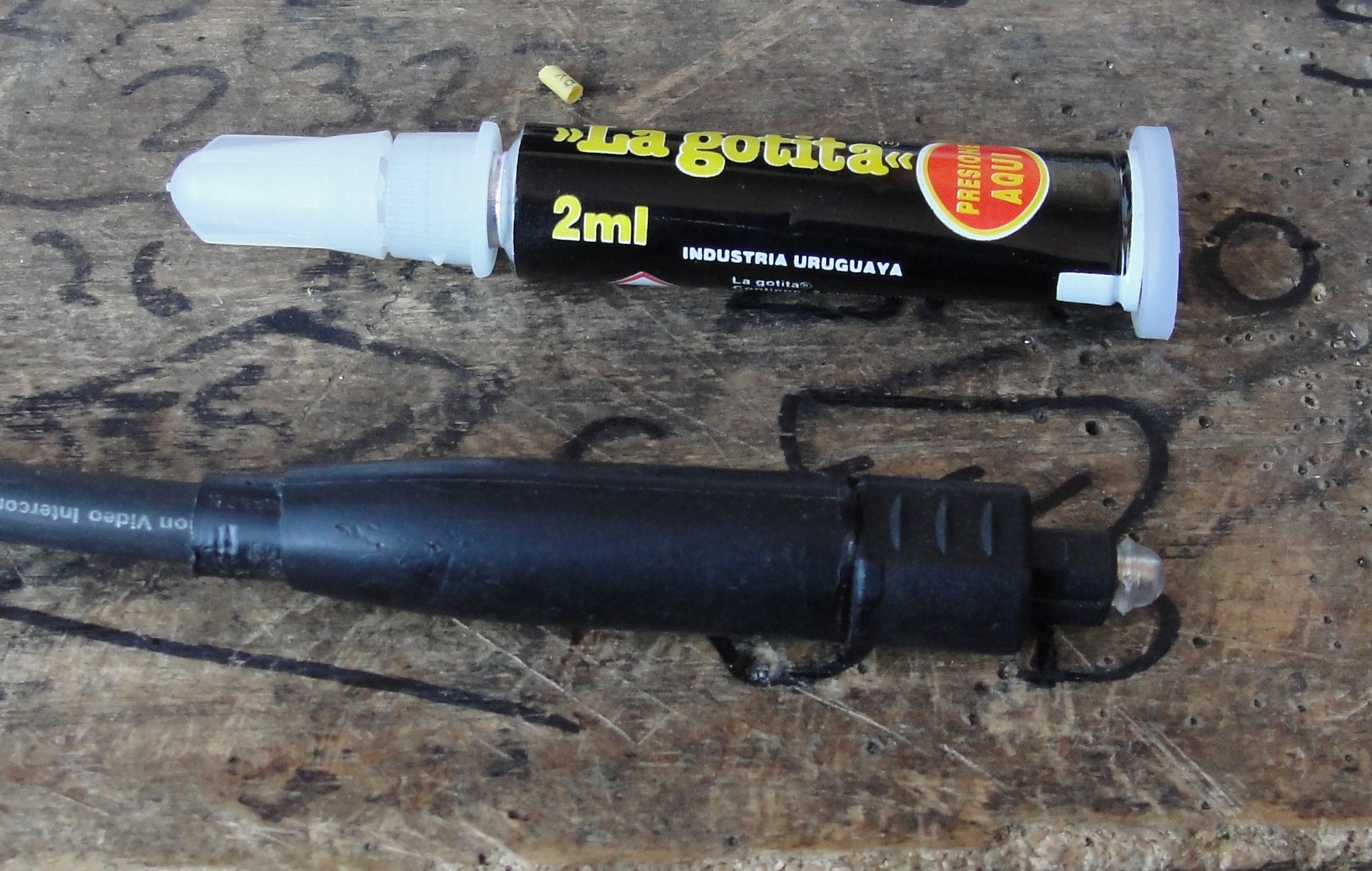

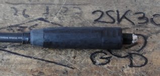

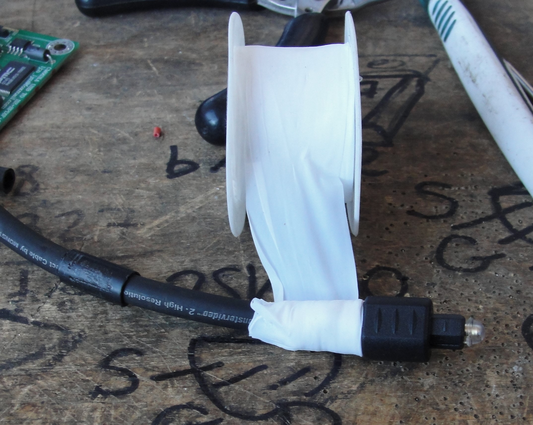

More pics.
Use a little epoxi to fix the red LED and to fix the sleeve, a "Sharpy" pen cover. Then heath-shrink.
Of course, a metal cover connected to ground could also be used...
Perfect grip and I hope near perfect Data transmission.
I hope you like it.
M.

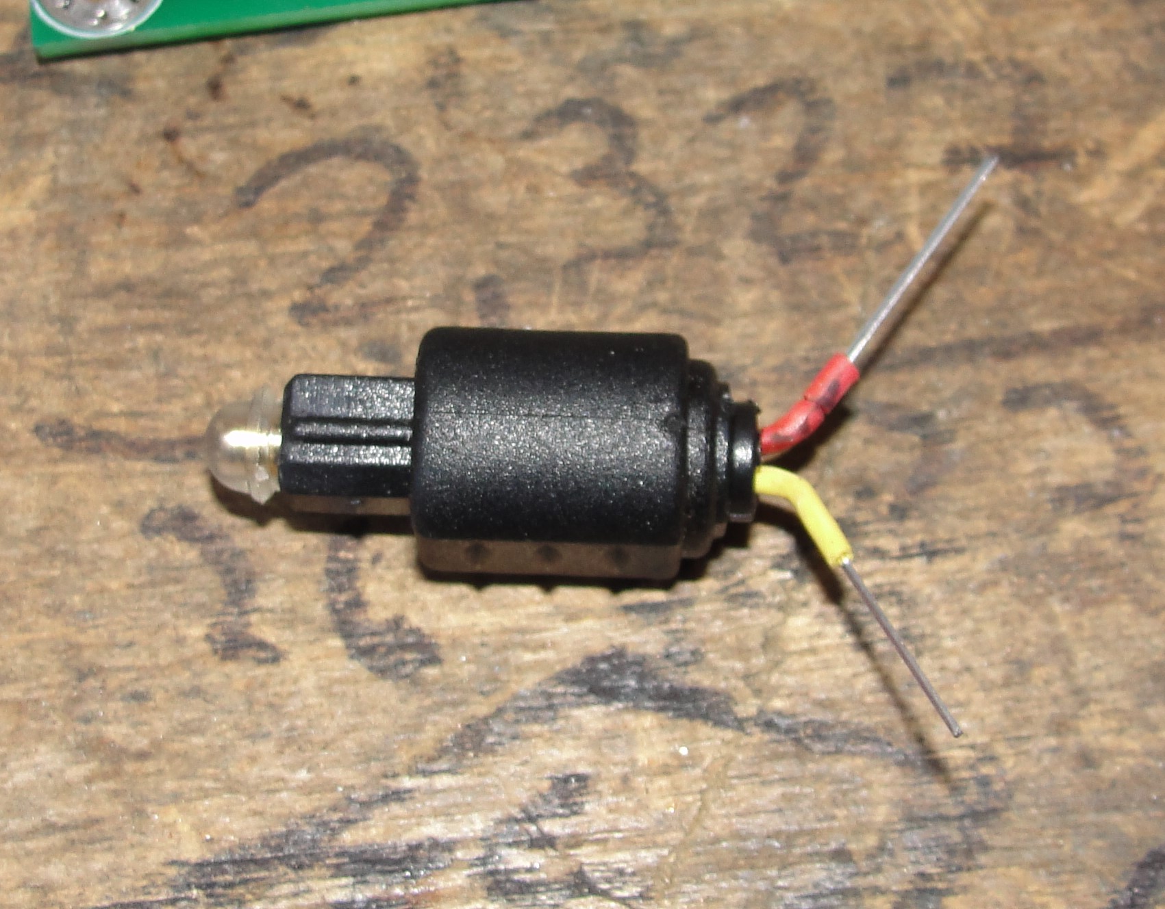

Best solution so far: adapter from mini to regular Toslink.
I hope pictures are self- explanatory.🙂
Sound seems fuller now.

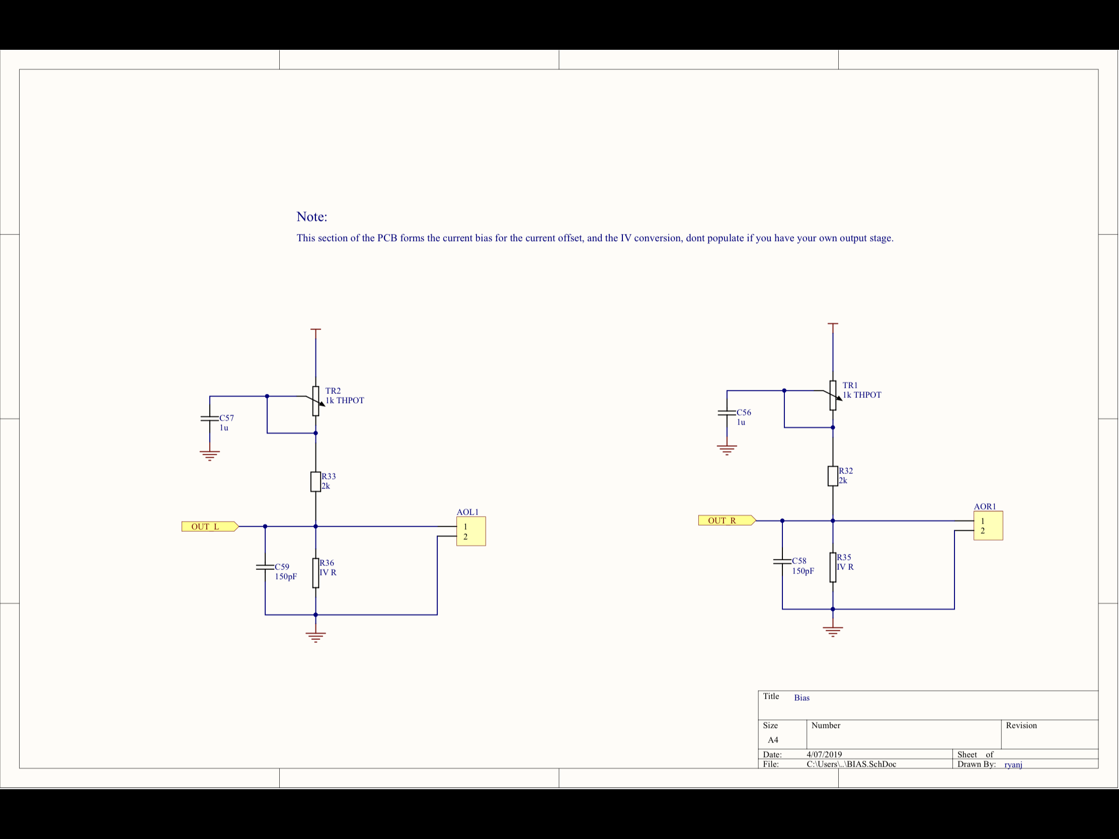

The I/V that Ryanj integrated into his TDA1541 D3 smd board, which I’m pretty sure was designed by our very own ecdesigns.
I own the D3 board and this is also the Board that i want to create an IV stage for.
Am I missing something ? I thought that i need to connect an IV stage after Ryan's circuit... The circuit is only to bias the output and should be followed by an IV stage that amplifies the signal. Or is a simple resistor really enough for IV ?
The whole circuit branch, including R35 / R36 is an I/V. That’s all you need. 😉

Yes! The item has it inside. You can see the damage I produced when pulling it off. 🙂
