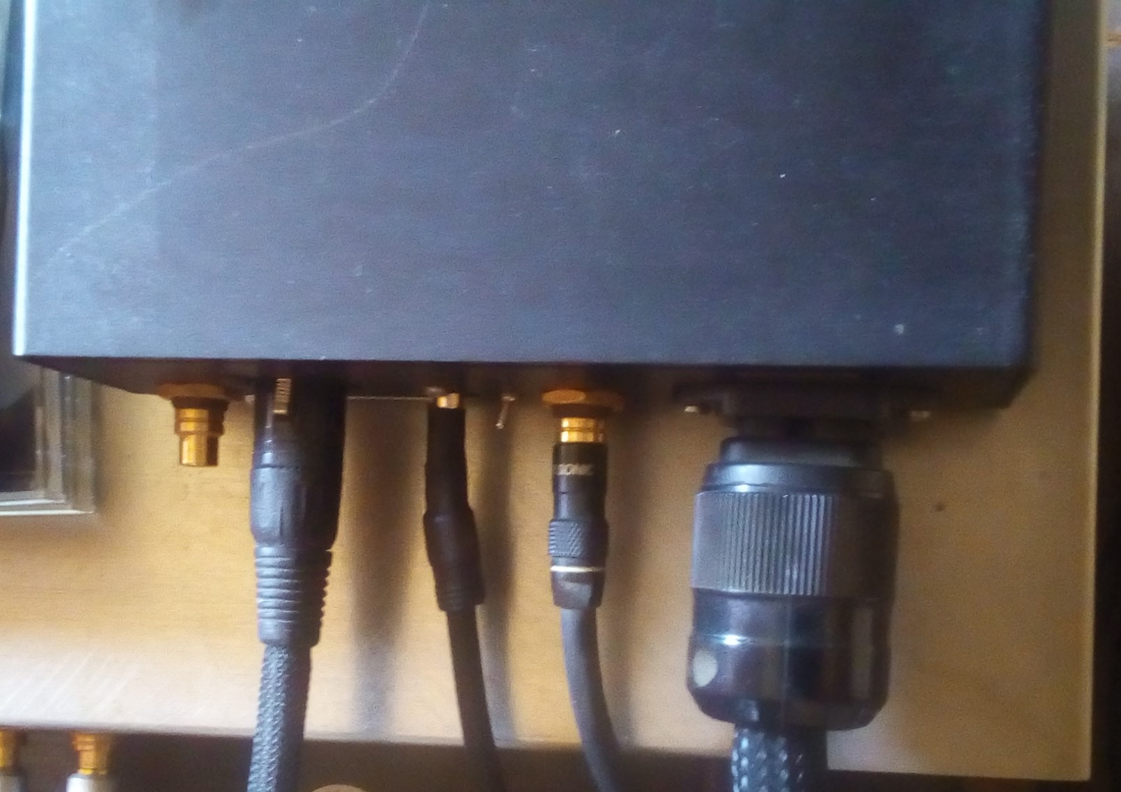

I modded a digital SPDIF cable with a miniature red LED instead of the usual connector and voilà! Signal locked! 😎
I used a modded transport in the form of a Bluray player to which I added an SPDIF output fed from the digital optic circuit: last time I checked, it produces a big signal, around 5V. Not perfect but it works. Now this SPDIF digital cable produces an optic signal through my cable which is fed to the Monarchy DIP Upsampler--> M-Audio SuperDAC-->TVC--> Amnesis amp...all galvanicaly insulated now.

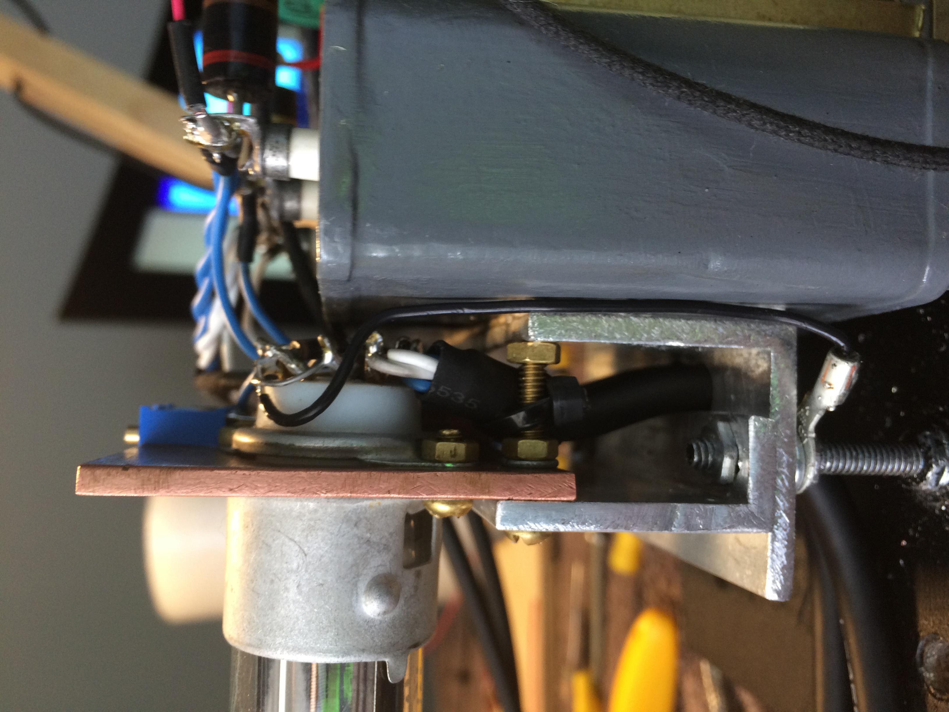

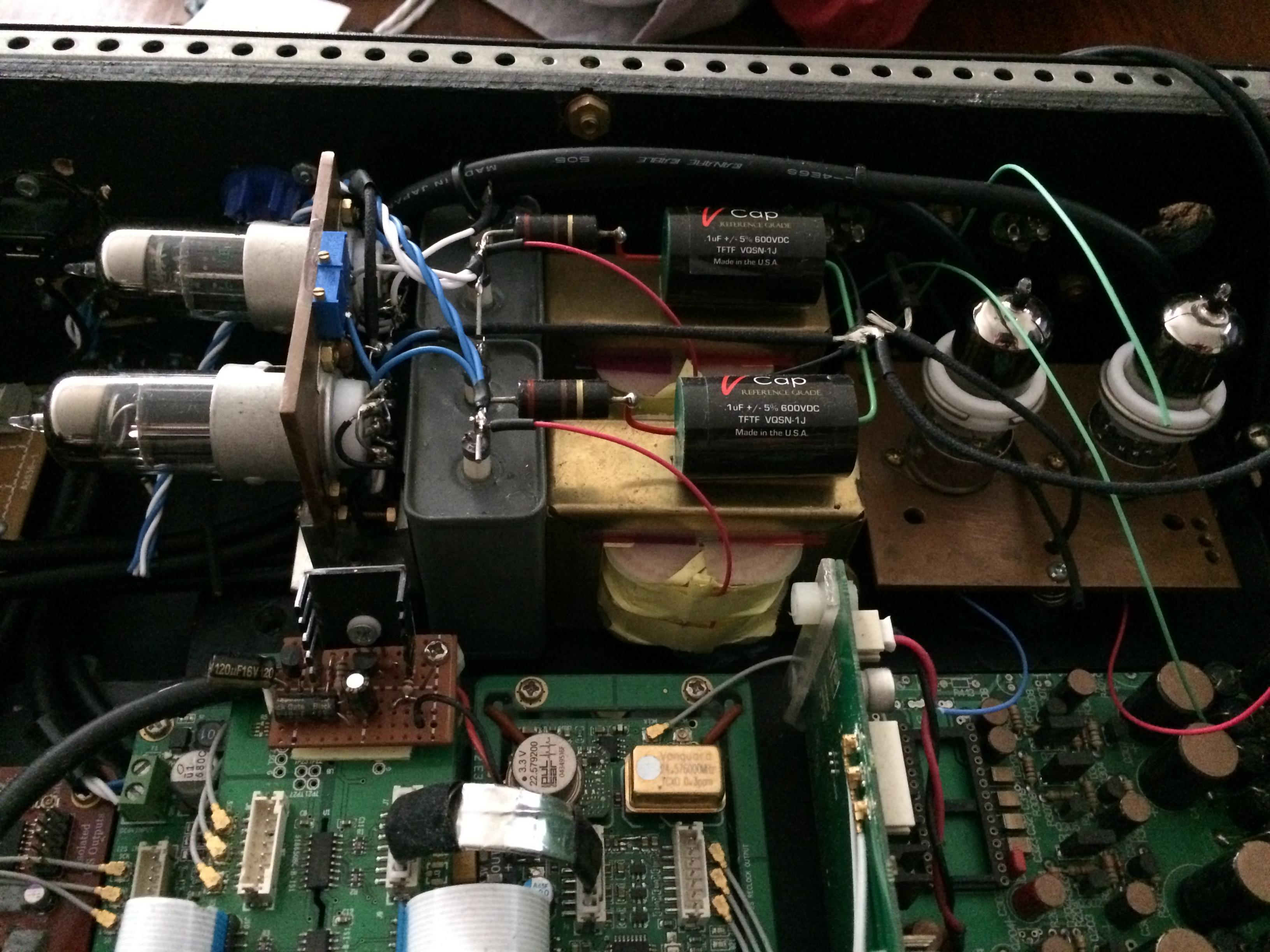

Here is my 1541A DAC. 12B4 hybrid shunt regulator (adj), TDA direct to D3a biased by DAC offset current, cathode to signal common, 80% nickel cored OPT 2:1 >2vRMS at <600 ohm out.
HK
HK
Nice.

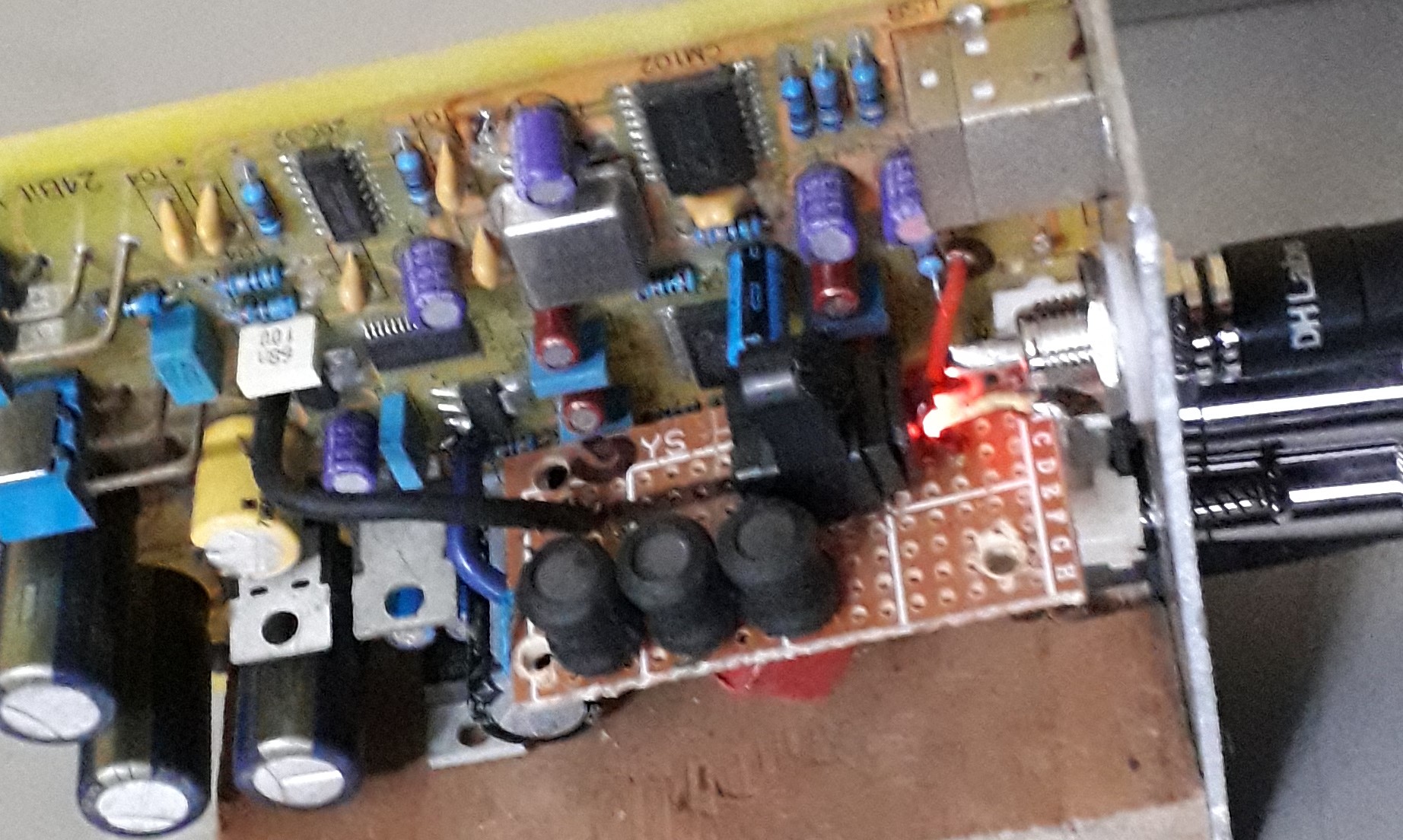

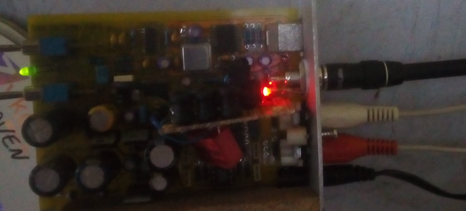

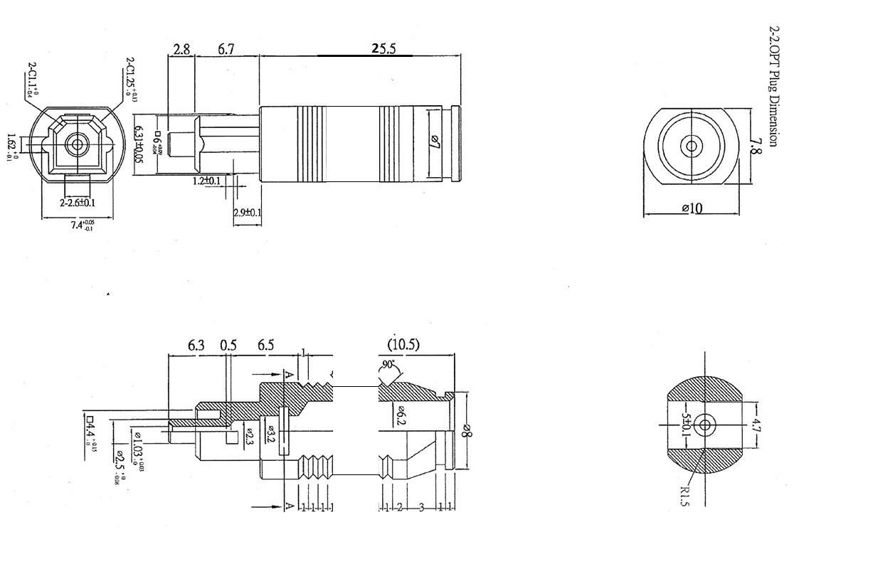

Following with the "Electro-Optic link", not to use John's proprietary name 😀, and which must be the discovery/invention of the decade, I will comment that I have been thinking about ways to improve the mechanical execution of the same.
For example, instead of 3D printing a special connector, I will try those "micro to standard optic adapters", which I believe, have a small fiber optic path to reach near the receiver photo-diode...anyway, I am waiting for their arrival.
I did the following experiment as prove of concept:
1) I modded an old DVD player by making an extra electronic digital output taking the signal from the signal path for the Toslink transmitter.
2) I modded a cheap DAC (Wolfson DAC chip; maybe 8840...; eBay of course) by installing a TORX177 optical receiver in the signal path. Then I connected the (new) electronic digital signal RCA connector to a miniature red LED. To improve the mechanical connection to the TORX177 receiver, I drilled the protector cap for the receiver and now the LED rests (partially) inside it, in a stable position, firmly connected to the TORX177.
3) I use a common SPDIF digital cable to connect both units.
It worked. 😎
Even while I am sure my technical execution is far from optimal, it worked, and not only that but also it sounds good, better than stock, with the same effect that on my other system. In a word: limpid.
This is most recommended experiment/mod.
Now I wish to make something alike for the MOSAIC DAC. 🙁

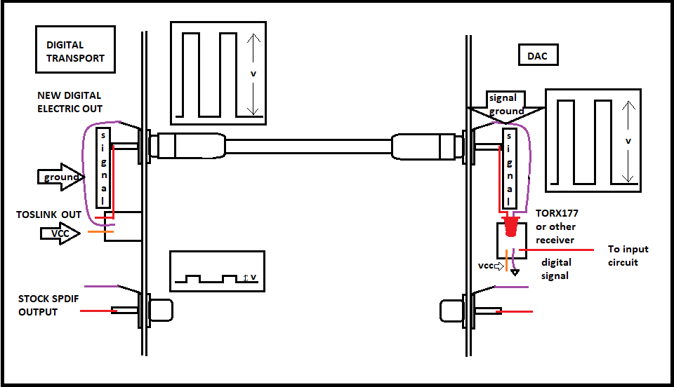

Anyway, here goes the circuit. I accept remarks in order to perfect it.
Note that you also can flip an existing optical receiver...
BOM:
*1 mini LED USD$ 0.1
*1 TORX optical receiver USD$ 4.
*1 RCA connector USD$ 1.
*1 XR7 0u1 cap USD$ 0.1.
*1 47uH inductor USD$ 1.
*spare cable.
= we dreamers are not good at Maths...😀
Well, actually 2 RCA connectors are needed, unless you re-purpose an existing one...if you are cheap like me. Suddenly, it is not that an inexpensive mod. 😀
