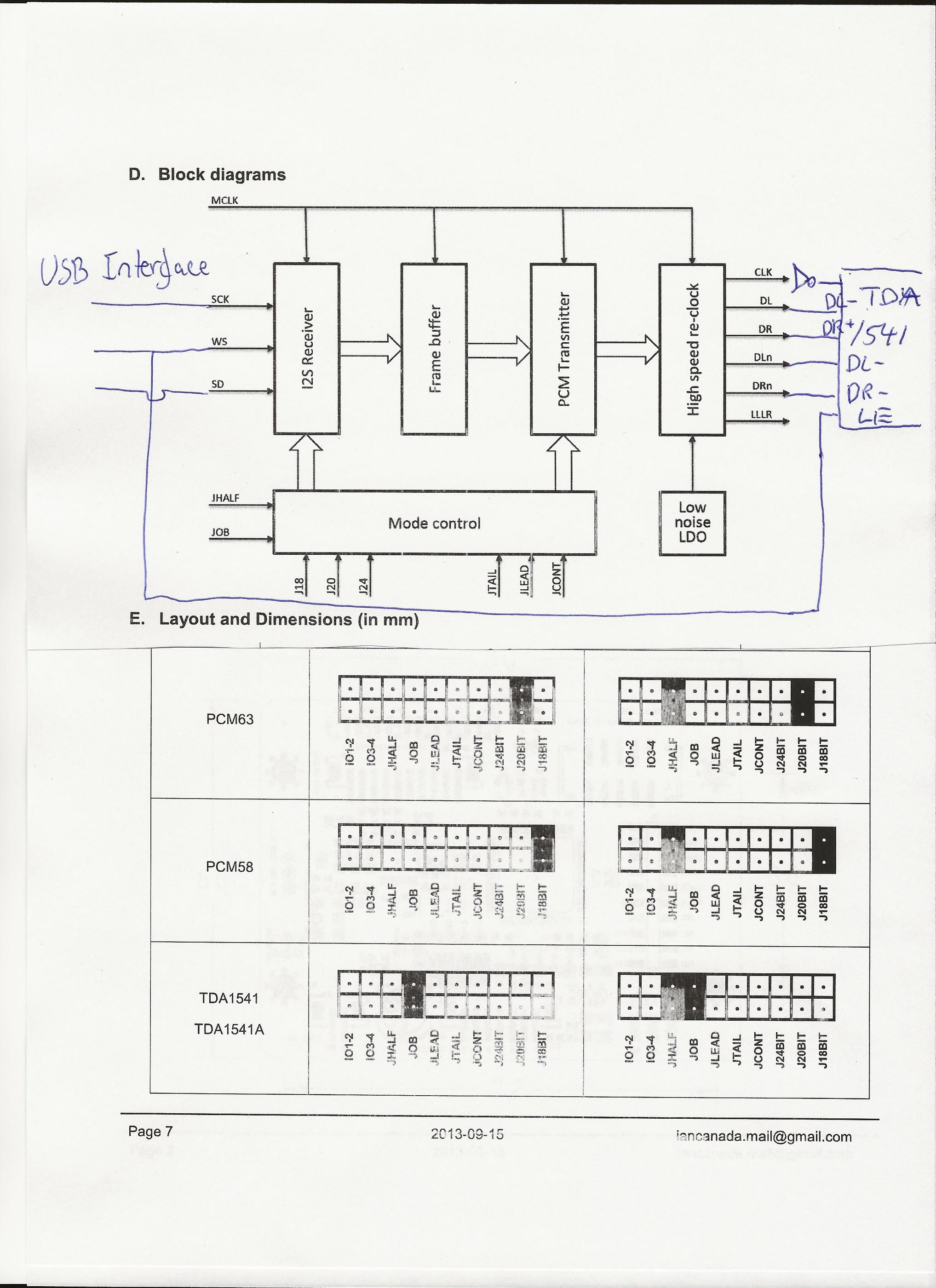

Hi could someone draw exact diagram what should be done. And i n what specific mode. Because many users have Ians FIFO.
Here you go. I hope this is clear enough. The jumper setting is of course as shown for TDA1541
If you have a FIFO you can use LE out of the FIFO clock board’s second set of i2s outputs (first set going to the i2s2pcm ofc).
Hi, thanks 🙂
This is for 2 x TDA1541A? One chip per chanel -data/+data to inputs of L/R per chip, in Simoultaneous mode (pin27=-5V), right?
Can I suggest to add 2 x inverter (or 4x) in WS(LE) line for compensate eventual delay?

Yes it is for two TDA1541A balanced in simultaneous mode, but you can use just one also and then only connect Dr+ and Dl+ .

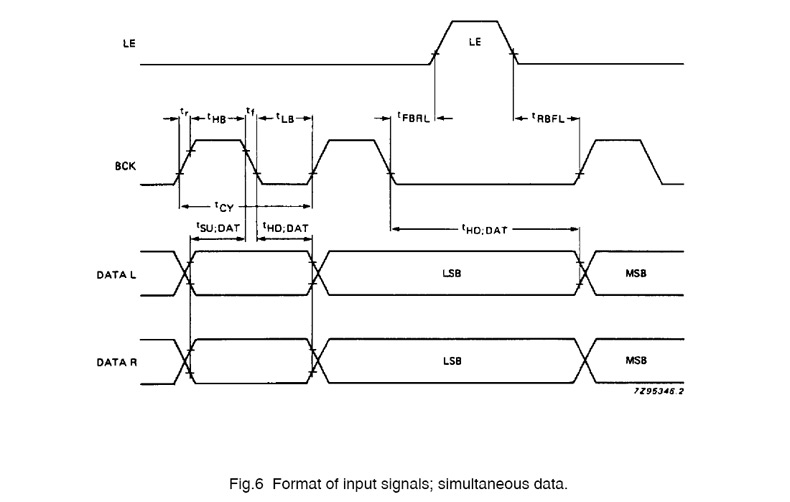

There is no reason to delay the LE as it goes high long after the clock has stopped. One of the main features in the suggested change. See post 6662.
Here you can see that the clock has been silent for quite some time before LE goes high.

Just an update inverted bclk from Ian’s Board doesn’t seem to work I get no sound. I suspect it’s due to the clock staying high instead of low when it’s stopped?
That should not be a problem, as it is the transition from high to low that moves the data into the register..
BUT--- I don't recall that I have actually tried to invert the clk. I only tested the LE mod. So if it works without inverting the clk, I guess there is no reason to tamper with it. It was 3lite that suggested the clk should be inverted.

I took a look at the TDA1541A data sheet and it is quite obvious, that the CLK needs to be low before the LE is active.
I cannot think of an easy way to overcome this right out of my head, but I guess some of the algebra wizards here can 😀
