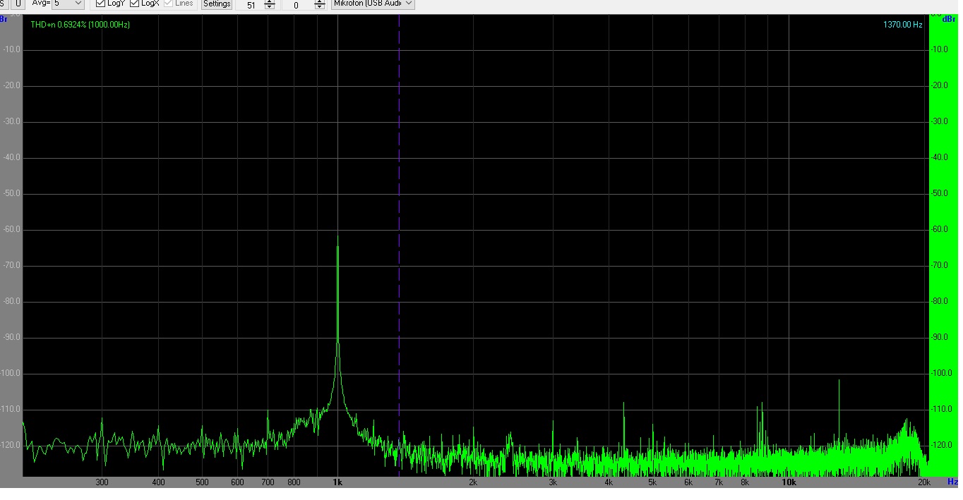

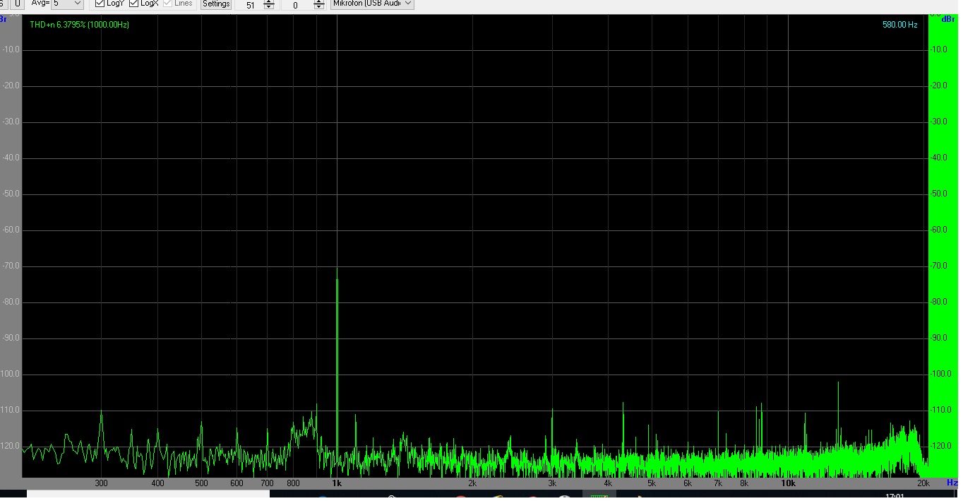

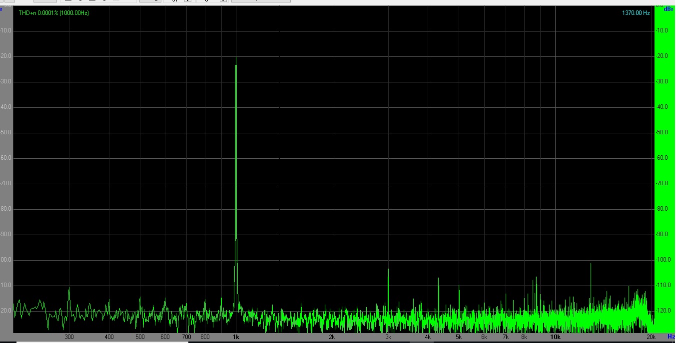

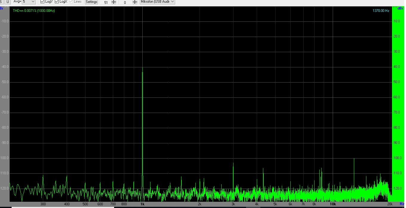

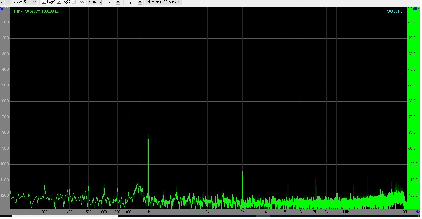

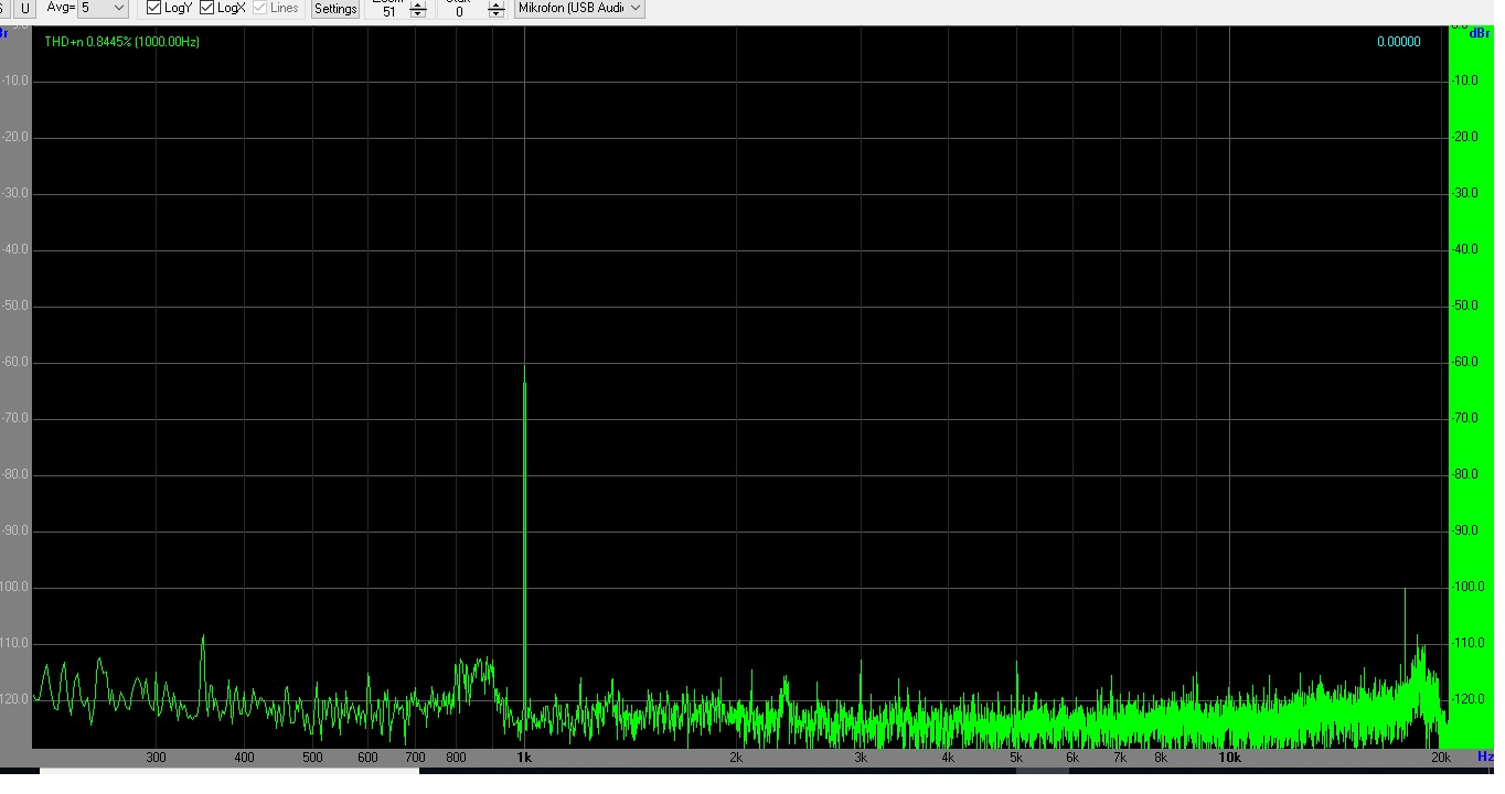

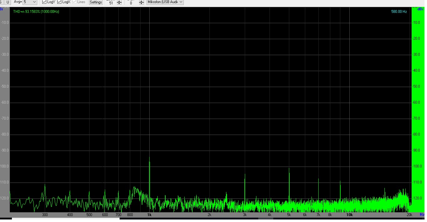

Got my Sowter transformers today, so I could do some experiments with those.
I connected each of the primary's from the two dac's (segments) to ground so the magnetic fields , caused by the DC current flowing through them, would cancel each other.
I then placed an inverter on the DOR+ to compensate for the 180 deg phase shift in the trafo.
On each secondary I connected 2,65 KOhm and series connected the two secondary's.
I get 1 Vrms on the secondary.
Now I could , with a 2KOhm trimmer placed on one of the DAC outputs , I could trim the even order harmonics.
The pics is 0, -10, -20, -30, -40, -50, -60, -70, -80, -90 dB
Notice the noise-floor is about 10 dB higher @ 0dB
And I cannot trim odd order harmonics away, because I cannot trim DC bias.

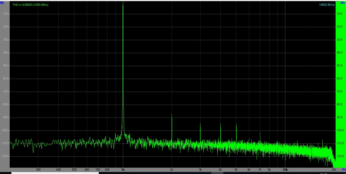

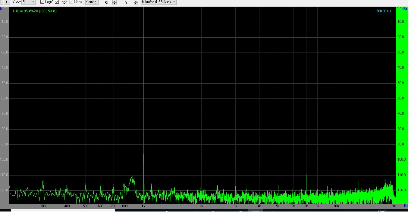

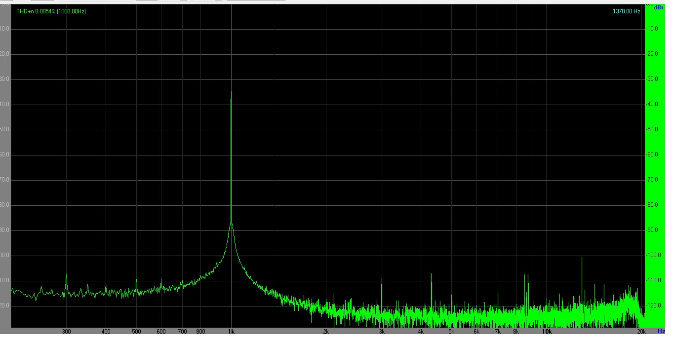

For comparison, I measured the two files from Hans as well.
The first is - 90,3 dB 16 bits and the second is -90,3 dB 24 bits.
I wonder why the spectrum is cleaner than the -90dB in the last post. Here the 3. harmonic is gone?
And the 24 bit version is even cleaner.

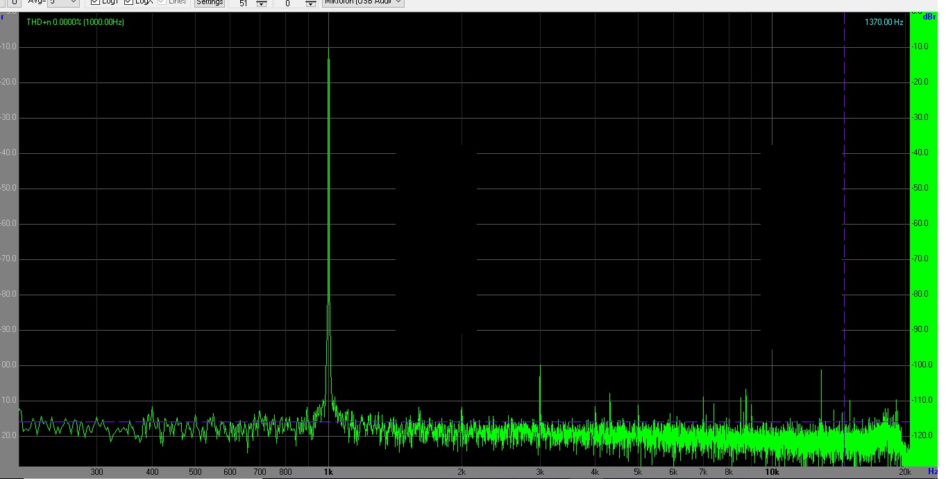

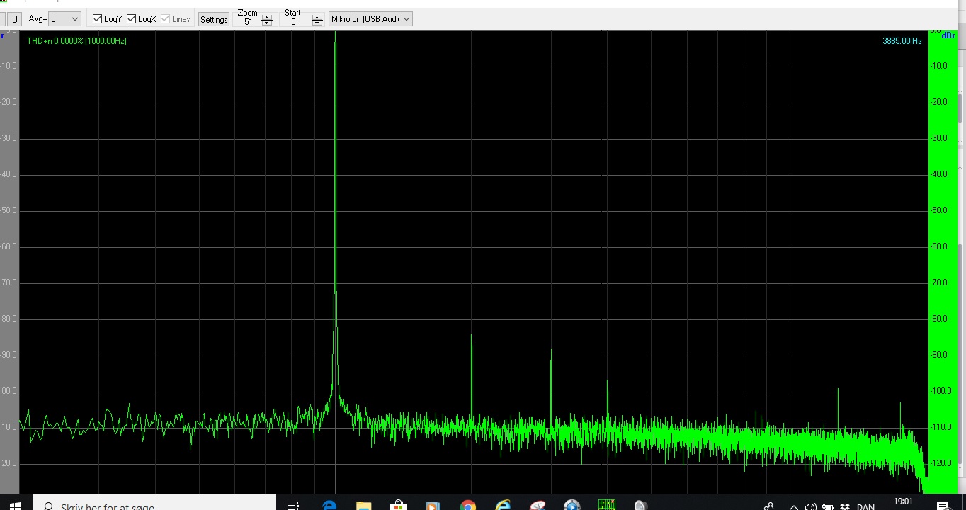

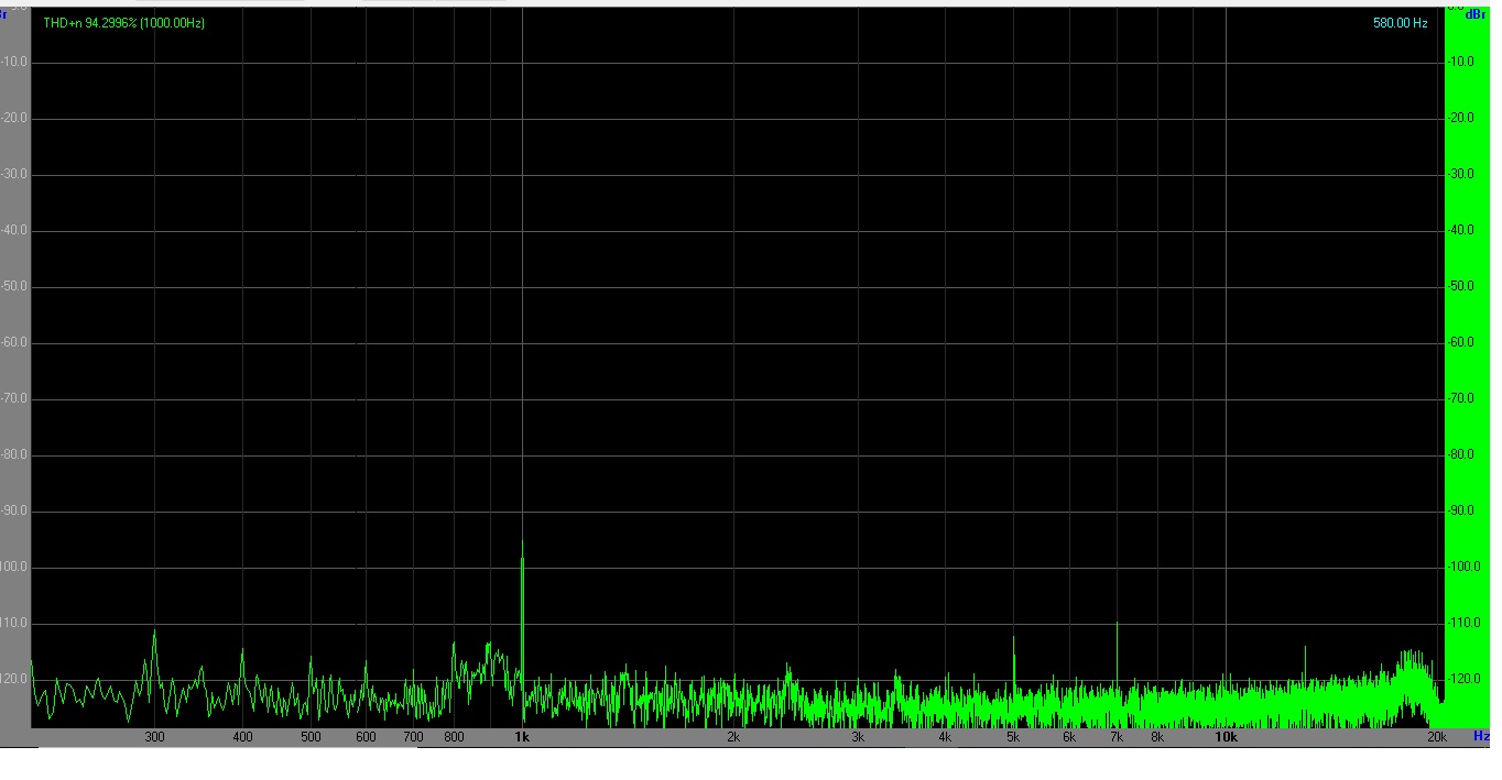

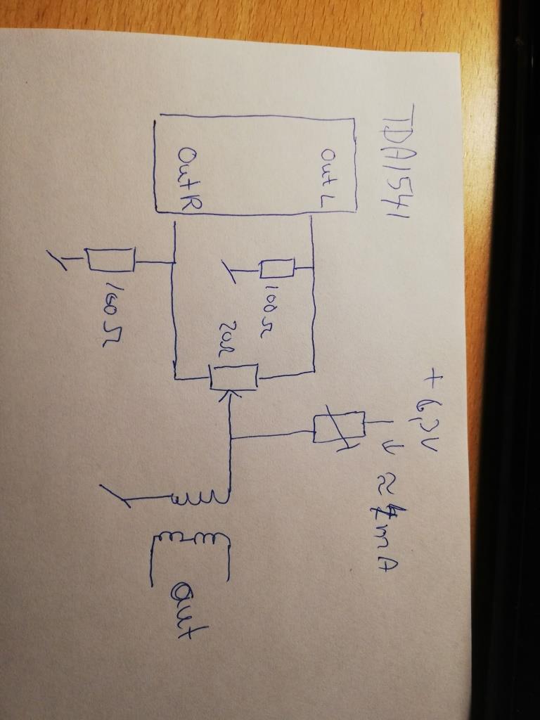

The have now tried several configurations and the best so faris:
100 Ohm I/V from each dac output to ground . A 20 Ohm trimmer between the two outputs, wiper to bias potmeter and to transformator with parallel primary windings.
I get 880 mV rms on the secondary .
And this result:
0 , -10, -60, -90,3 (24 bits) dB
And this result:
Great results.
One thing that's puzzling me, what is the little bump in the noise level between 850Hz and 900Hz.
It's there in all low level recordings, not really a serious problem, but there must be some interference.
Hans
Hans

Hi Coldby could You Please post a schematics of the set up You did. Sorry It is not clear enough (for me)?
My setup is only for testing as it is now. I hav no schematics. However:Hi Coldby could You Please post a schematics of the set up You did. Sorry It is not clear enough (for me)?
The background for it is what ecdesign describes in post 6116.
But I use the i2s to signed magnitude as described in 6126.
There are errors in that schematic as described in post 7069.
The output is what I describe in post 7273 and shown in picture.
Hope this helps.
