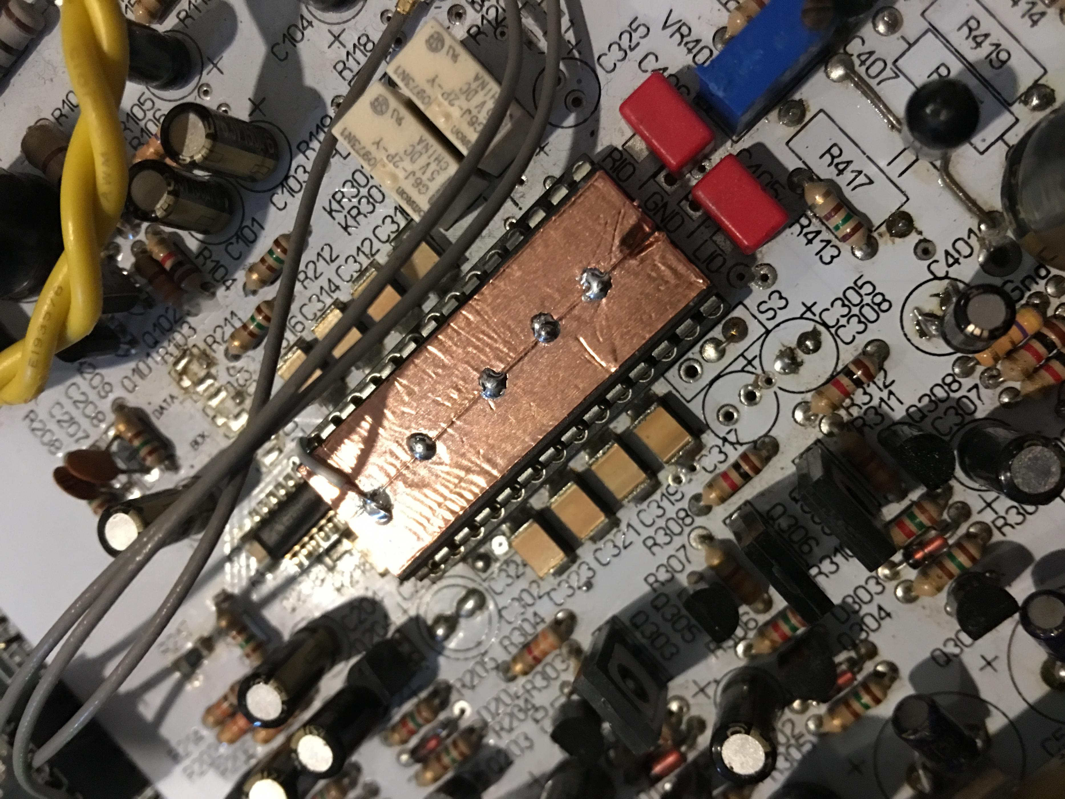

Hi Guys
Can someone shed some light as why does this copper foil thingy works pls.
I recalled reading this way back. Had some time & thought I give it a try, damn it really does work, everything familiar pc of music that played came out more better defined especially low level details. Why so, is it because of rf or ???.
Im aware that some Japanese hi end cdp sticks copper foil all over caps & ic chips etc.
Thks

Lol it’s not a tip Phase, just dumb founded as to why it works & that you really can hear the difference. Btw you’ve got solder a tiny wire & ground it to pin 14
of the TDA

It was discussed also here:
Copper tape atop IC's?
and here:
https://www.diyaudio.com/forums/digital-line-level/79452-building-ultimate-nos-dac-using-tda1541a-360.html#post2469333
And here:
Pictures of copper heatsink
and here:
And here:
